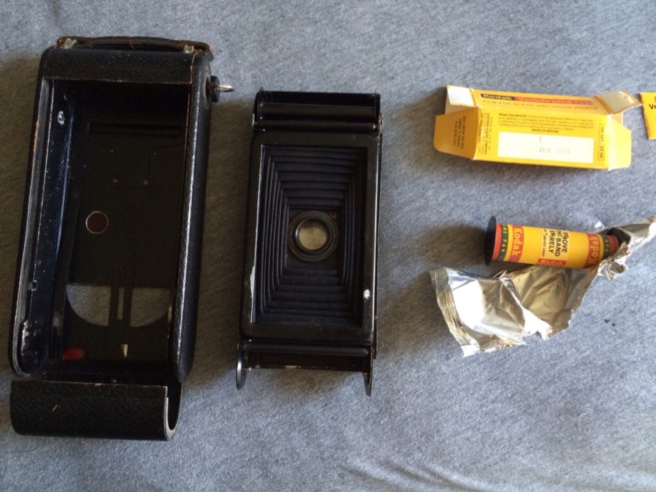

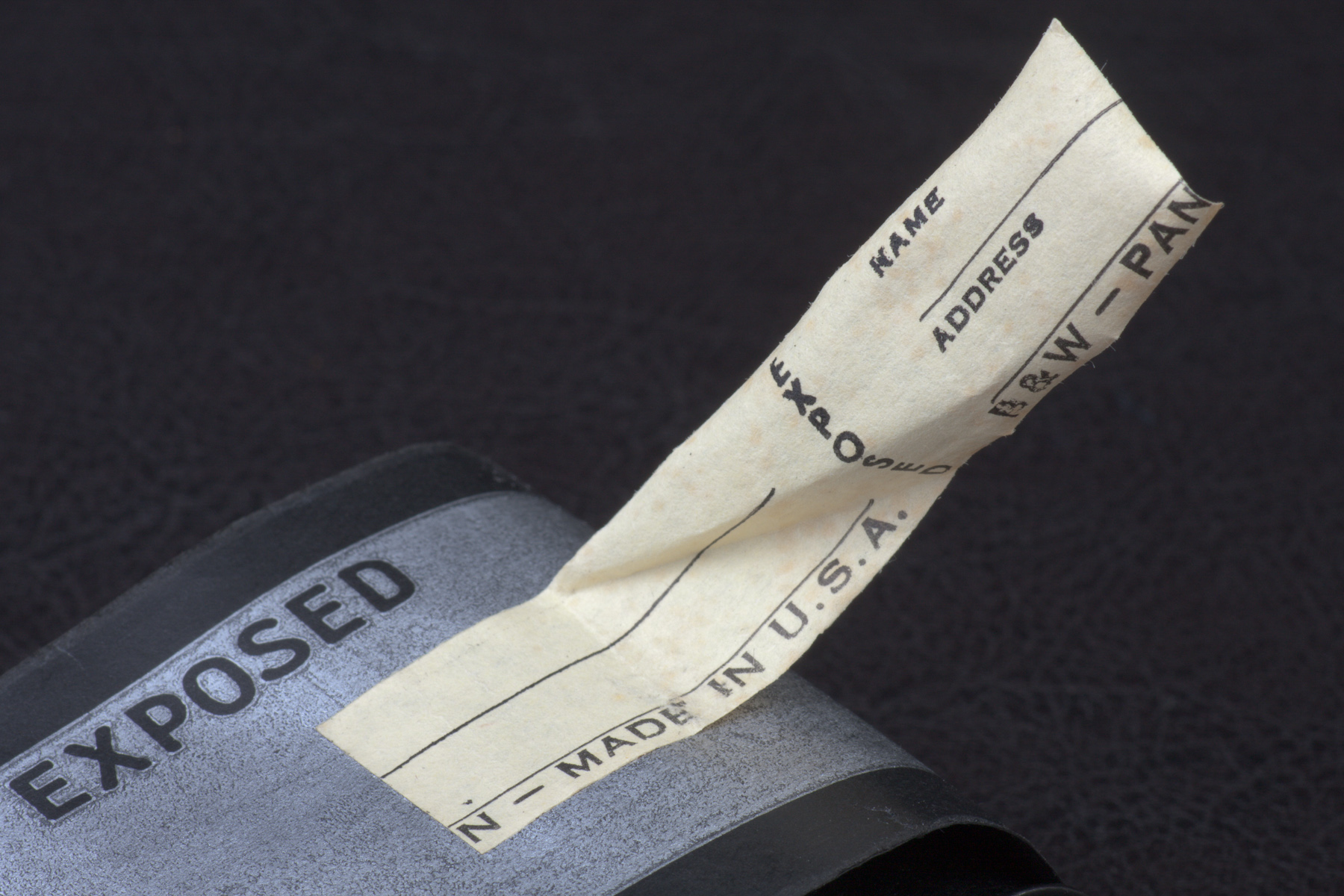

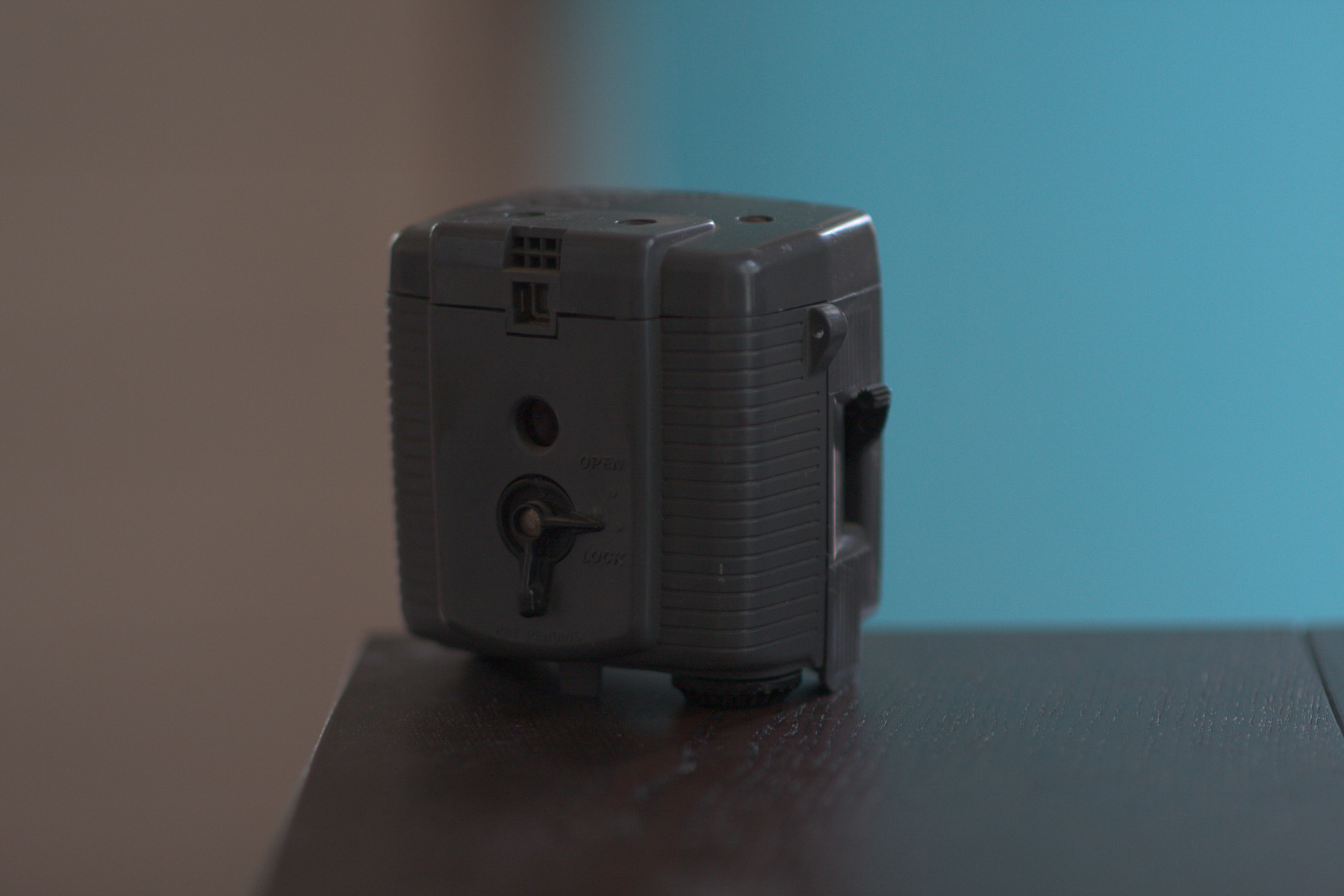

Any ideas what this film is? I got a weird little camera along with a Polaroid SLR 680 here recently, and along with a bunch of spiders and their eggs, there was this roll of 127.
Contrary to what my profile details may claim, I'm no 127 format expert so I would be much obliged if y'all had any idea what this was and how long I should soak it in HC110.

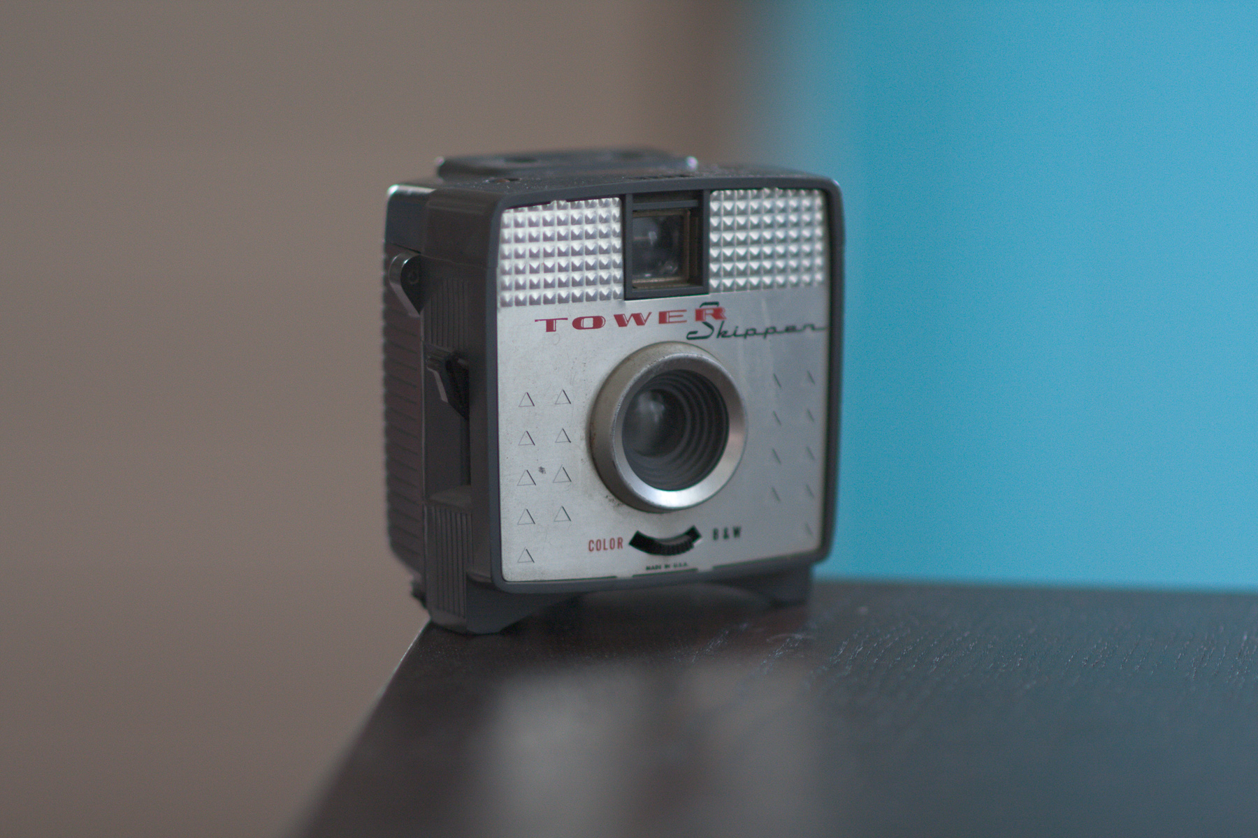

Oh yeah, the third/fourth image attached is the camera it came in. Should be fun to see what's on the roll. if anything.

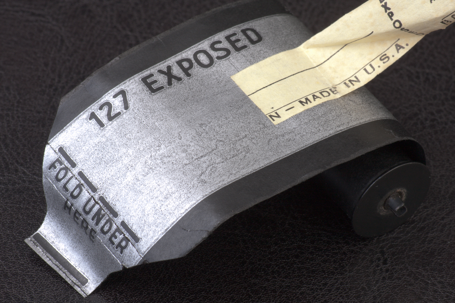

Wow my aunt found a very similar camera...I havent had time to inspect it but good to see at least one other exists....but eww spiders and spider eggs...lol

By the backing paper it looks like VerichromePan
I would be really surprised - there is no Kodak insignia or film type indicator on it anywhere, and I don't think I have every observed that with Kodak film.

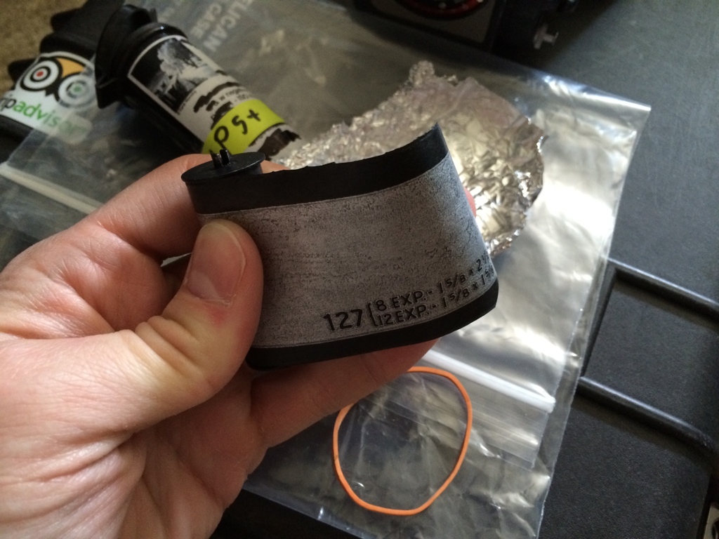

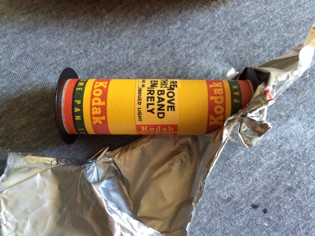

Actually I already have a few rolls of it, I actually use it to reroll for the special HP5+ for re-rolling, so I've seen the paper but I can't exactly on roll it much to show you because there's film inside...
But mine doesn't say kodak either...
But it certainly came from a VerichromePan roll (there's even an image shot with the original film in my gallery, I believe it's of lettuce or a garden in my back yard).
But here's my roll...

So do I assume correctly that you are seeing edge printing that tells you it is Verichrome Pan, but there is no printing on the backing paper that identifies it?
If so, I'm guessing that someone has re-rolled that film.
Is there edge printing on both sides of the film? If not, I'm wondering if the film started out as 120, and was cut down.
There may once have been 46mm Verichrome Pan in long rolls. If so, maybe that is where your film came from.
What are the edge numbers like - do they progress normally from 1 - 12?

I think you are a little confused, you can still purchase old boxes of their Verichrome Pan 127 Film...
The role you are seeing is a role that I originally purchased and opened from the box directly on out before I opened it. It was most certainly VerichromePan...
I actually have one more box left to shoot.
But the picture I posted is a picture of the role that originally was VerichromePan, but after shooting the original roll, I rerolled some 46mm HP5+ that was in a bulk roll... That's all, so I can unroll the entire piece of paper to show you the entire thing because there is film inside that is waiting to be shot...
Anyway it is possible of course that there were other backing papers that had the same exact color with the silver ink, but I'm pretty sure that kodak used different backing papers for different films, and that the OP's roll is VerichromePan...

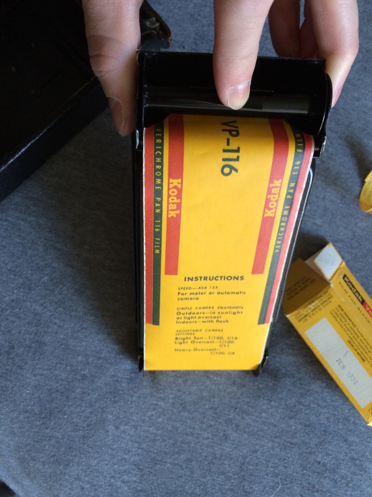

Actually funny enough today I loaded my 116 camera with that same roll... :smile:
But the 127 is an entirely different backing paper.
The above roll is 1976 I believe, and the 127 was I believe 1950's or 1960's I THINK but I have another roll from the same lot, so I'll check when I get home, I haven't broken into the box yet so was savoring it, but for the sale of curiosity I'll check it out tonight and break it open :wink:

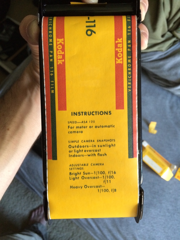

Brac
Oct 5, 2004
632
UK
I have never seen a Kodak/Eastman Kodak backing paper that was white or silver nor one without the maker's name & film type printed on it. The last 127 size Verichrome Pan films I saw were UK made with expiry dates in the 1970's and 1980 and the last rolls made in the USA which had expiry dates around 1983-85 I think. But all were yellow with black & red printing giving the make, film type & roll film size. They look much like the 116 backing papers illustrated above.

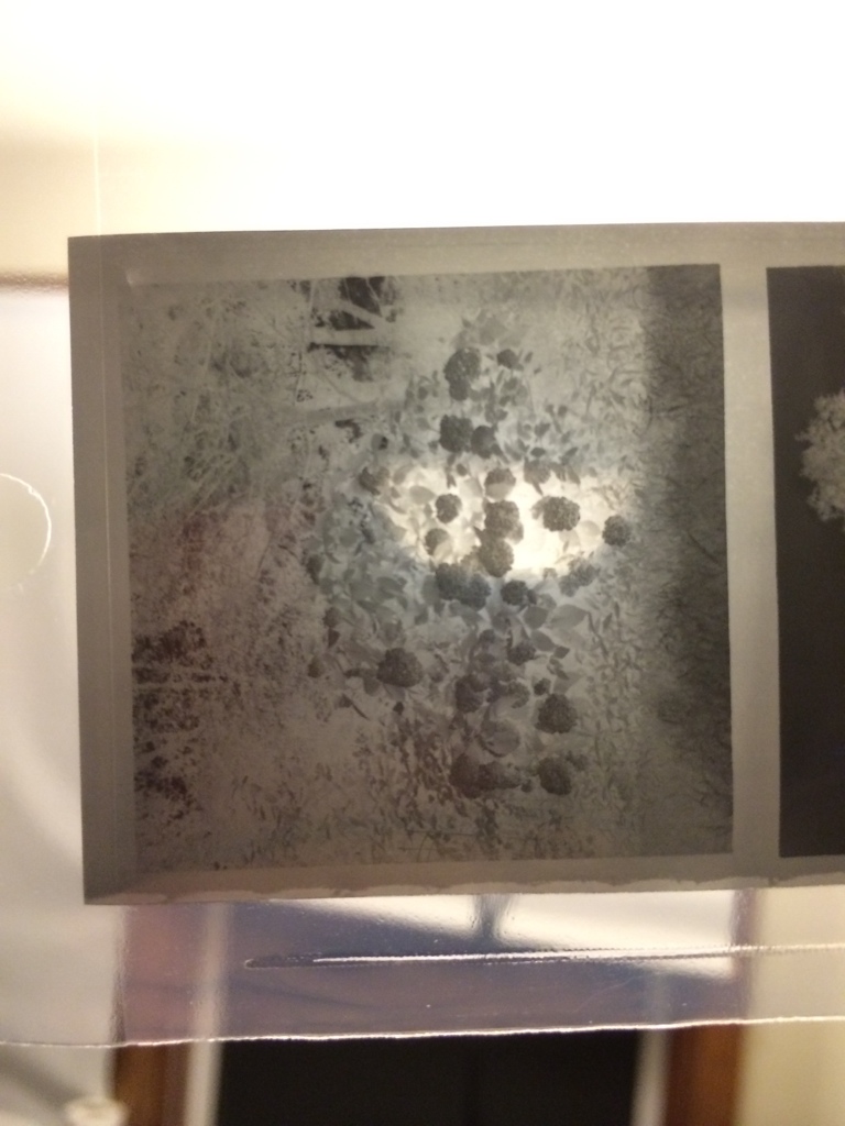

So OP did you ever develop it??
I just looked at my film and the film also has no rebate on it at all ... Pretty fogged, scannable.
