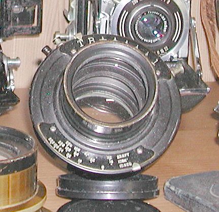

I think you have almost the same lens that I have, but mine is 10 3/4", 18" and 23 1/2" . Mine is marked Rapid Convertible 6 1/2 x 8 1/2. I have been in touch with Seth at cameraeccentric, but we couldn't really determine what it is. It may well be a Volta, but then it's strange that it's marked as "Rapid Convertible"?
Oh yes - mine is also in a Regno shutter and the apertures marked in US.
Poor picture, but I had it ready :wink:
