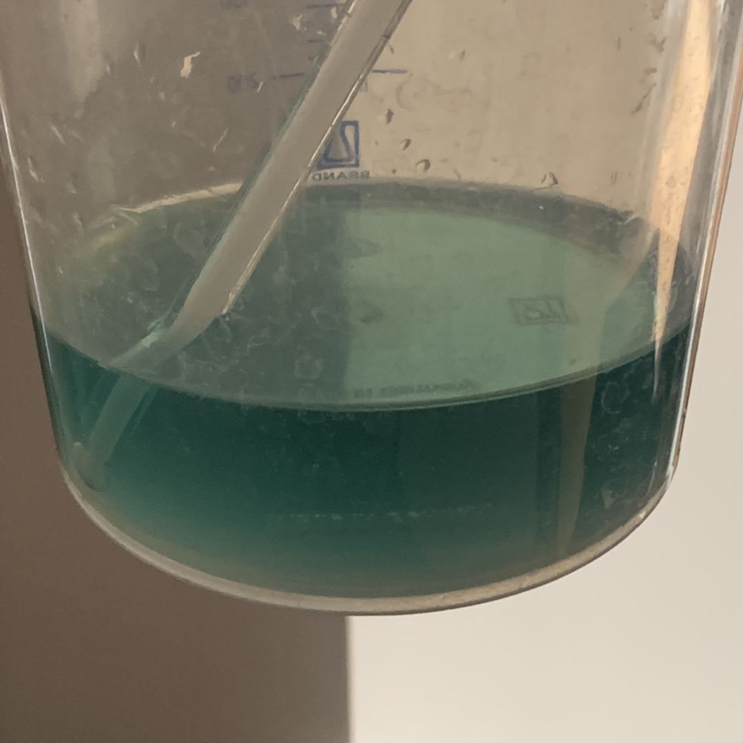

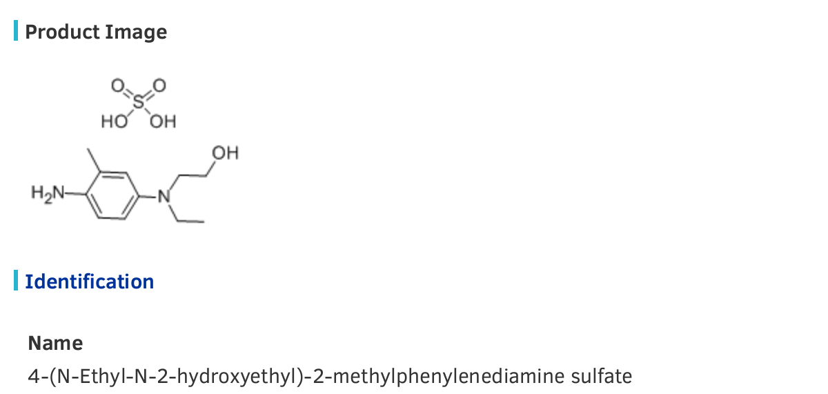

So, if we add some C41 developer C into A(no B), the solution would turn cyan, and if we put C into K2CO3 solution, it turns out the same color, which means C contains something that will turn cyan in an alkaline environment. Now if we add H2SO4 to change the PH to 7.8, the solution will turn magenta. So here is the question, what else do we have in C, except CD-4 and K2S205?

The developing agent is pink in acid due to aerial oxidation of the agent. Addition of Sulfite will render it colorless.
PE

This. For this reason I add sulfite first and then the CD4 in my home brew developer. BTW I've never seen CD4 turn cyan, so that part of the puzzle still puzzles me a bit.

Yep, it contains K2SO3 which oxidizes instantly in water due to the oxygen dissolved in the water. BTDT.
As for the green color, there may be a small amount of a phenolic compound there which couples on the basic side and it forms a greenish compound. There may be other reasons.
PE

"there may be a small amount of a phenolic compound there which couples on the basic side and it forms a greenish compound"——that's just what I think to,

By the way,mixture of A and C,turn cyan at the beginning,but an hour later the cyan has disappeared。
