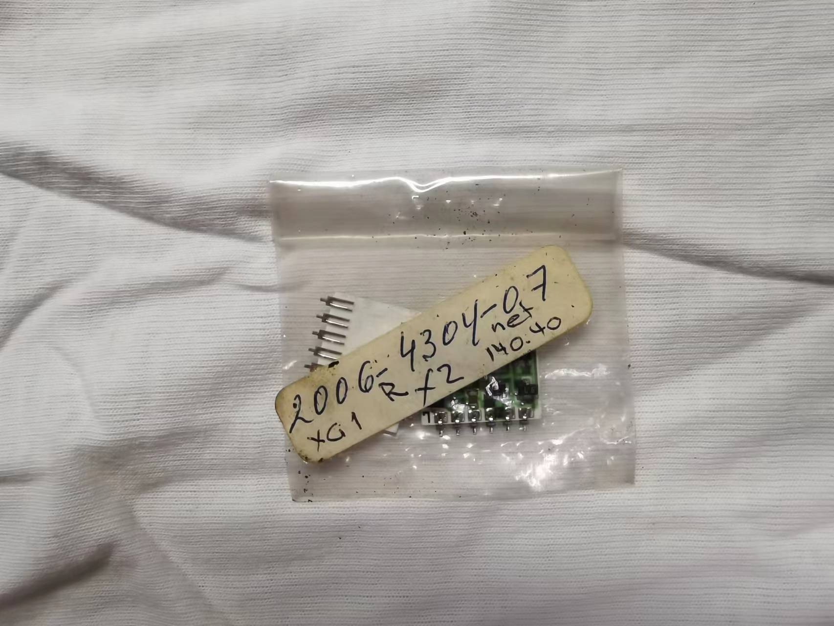

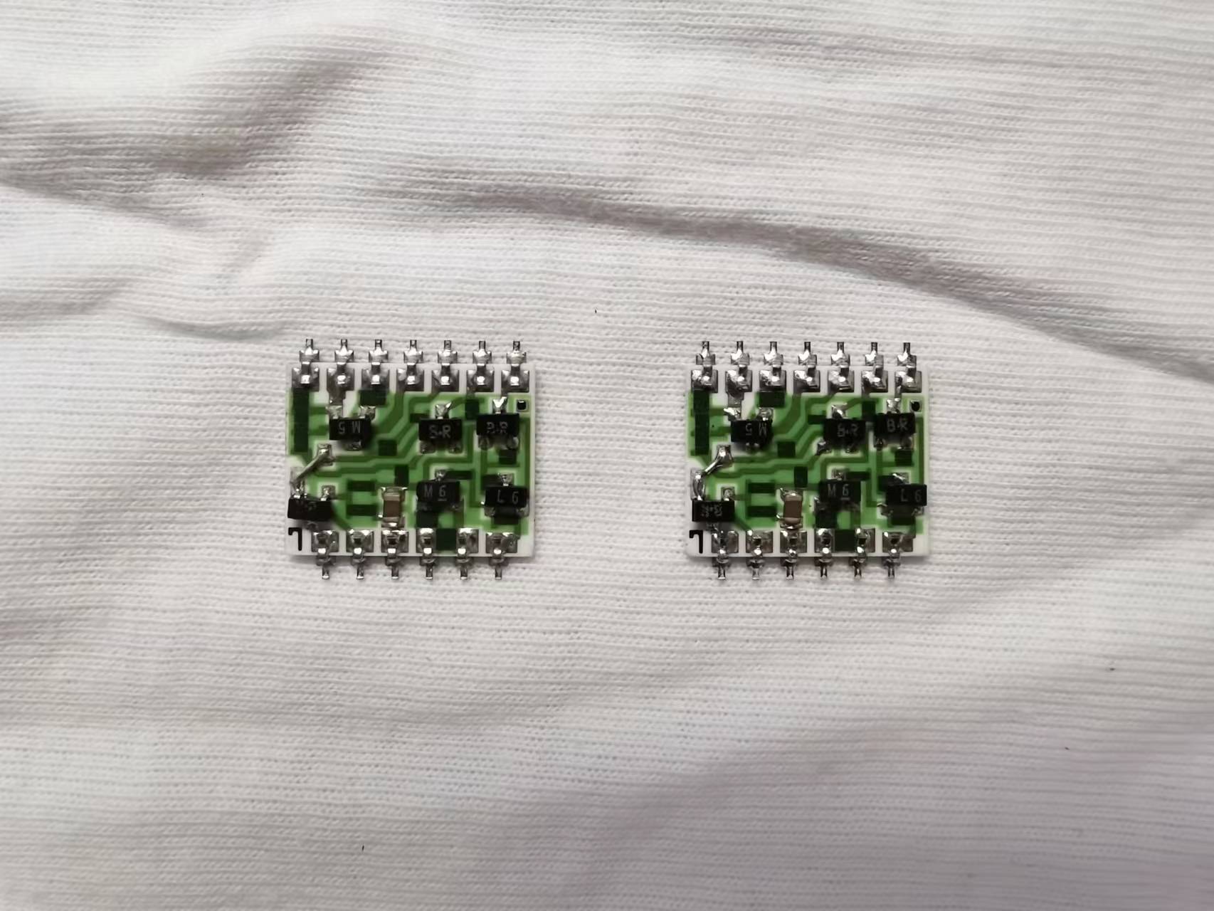

I recently brought a basket of Hasselblad spare parts for my camera repair. I noticed there are two unknown circuit boards included. Just posting here to see if anyone knows what they are. I will be happy to send them out to anyone who needs them.

This part is know as IC4 and lives under the bottom cover of the Minolta XG series cameras: XG1, XG7, XG9, etc. Later versions of the XG series changed to a different configuration.

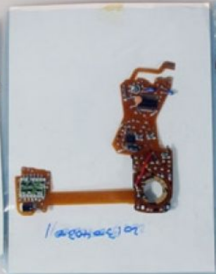

I have to correct myself. I looked at several photos of a sole, but assembled XG1 flexboard where this part was not shown.
And would one expect such a simple board at a flexboard with several micro-chips?
But here it is:

Much thanks! You guys are amazing! Anyway, doesn't seem to be a very useful part. Just some logic processing unit. But this small circuit is really well made. Ceramic substrate with screen-print thin film resistors.

I am still puzzled. So the Minolta XG1 has got two quite similar of these boards. Were the IC's too generic and needed to be added by two model-specific boards, handsolded together with some transistors etc.?

Not an electronic expert. But I guess the specialty of those boards is the screen-printed resistors. My guess is back in those days making surface mount resistors are still an expensive process and requires quite a bit of human effort. But producing screen-printed resistors are much cheaper and can be automated. Also to make large volume production even cheaper, they choose to design a collective small board with all peripheral components installed, which they can first order those small boards from third-party suppliers and then easily assemble to the flex PCB in their own factory.

I found a photo of the flexboard of a Pentax SLR added with a stiffboard in same way.
Much later, after Pentacon succeeded in making a camera with just flexboard electronics, at one later model they added a stiffboard with various compoents again, only to end at the final, most advanced model with a pure flexboard again.
And back to the original question: the Hasselblad Xpan combined a flexboard with stiffboards, thoug dit not mount the stiff ones on top of the flexboard.
