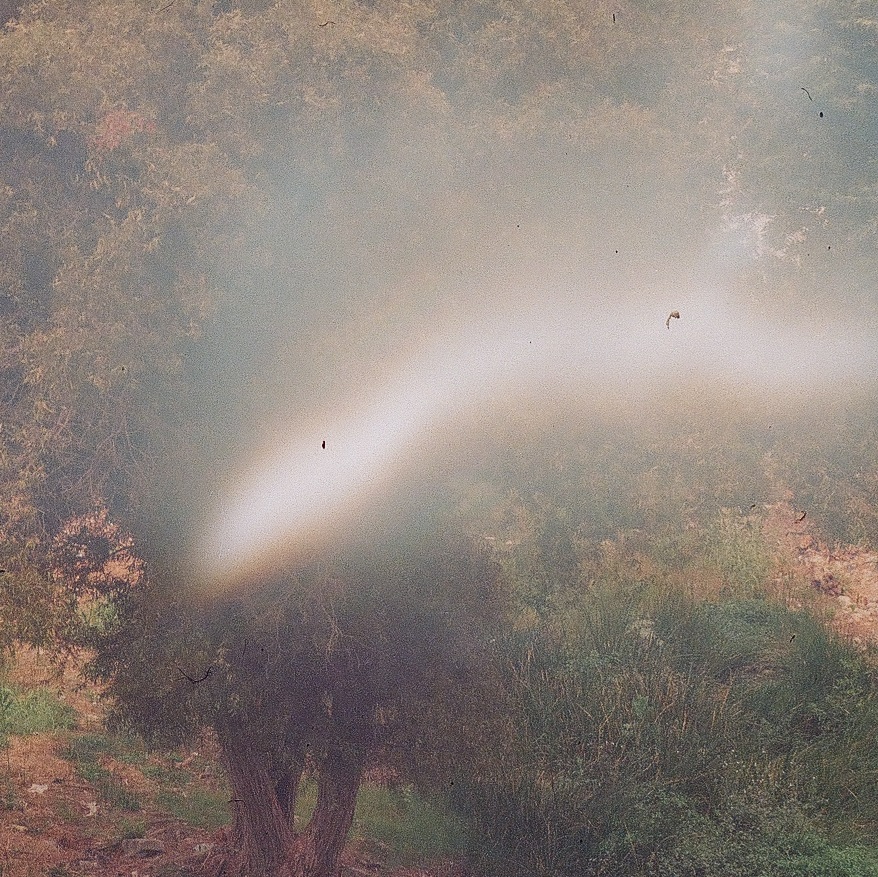

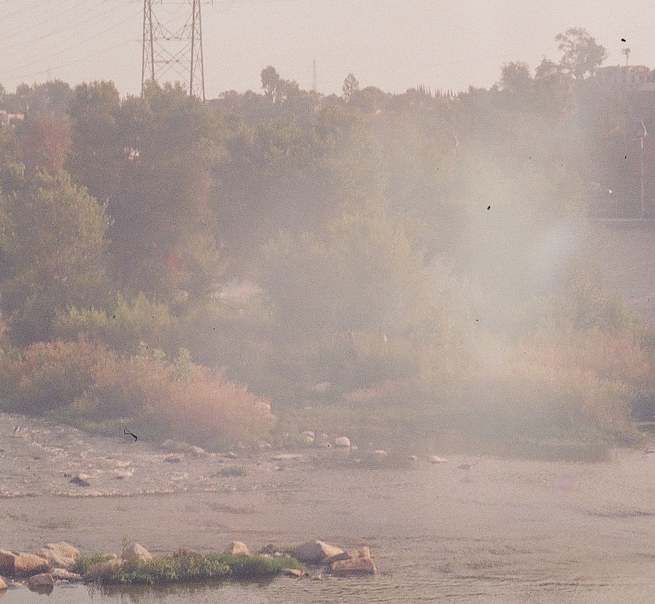

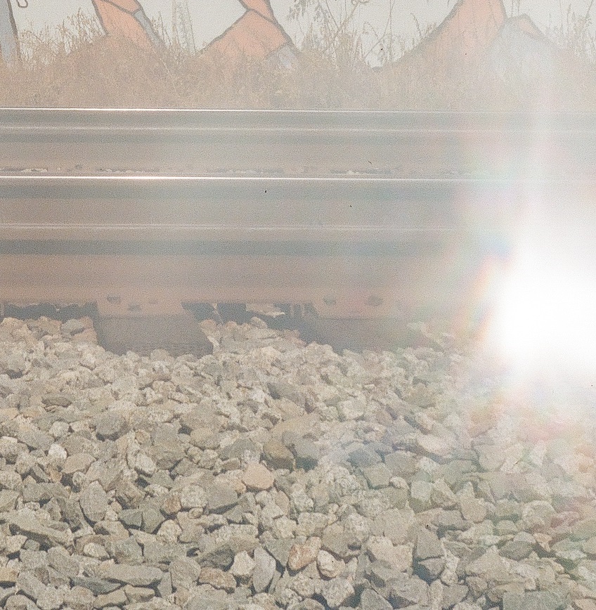

Hello all,
I recently got back a roll I shot on a 6x4.5 Ikonta 521 with a f/3.5 Tessar and Compur-Rapid shutter. All shots were at 1/500 except for one at 1/250 (due to 800 speed film). All have mysterious light leaks (?) in the center right area of the image, ranging from faint to extreme. They are all white or bluish, suggesting the leak is coming from the front and not the back, and all are in the same area of the frame, suggesting they are happening at the time of exposure. I checked the bellows with an LED light, and dry fired the shutter while looking through it (it is not closing slowly or imcompletely, or slipping open when being cocked at 1/500).
The samples below are cropped due to file size. The second is the most extreme one, and from the frame shot at 1/250. The third seems oddly like there is some sort of flaring in the lens happening. Any ideas?

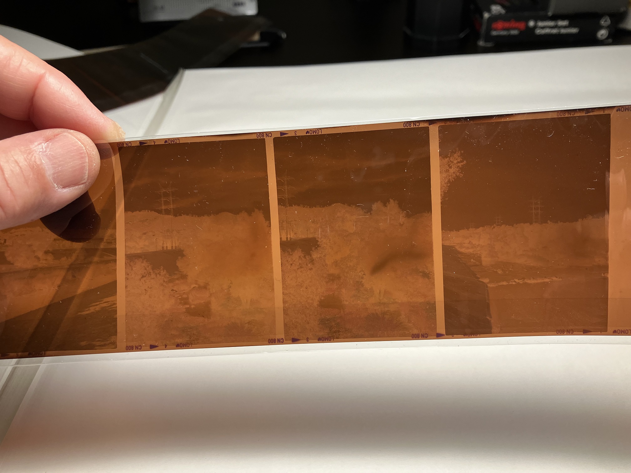

Hello koraks, thank you for replying.
On the negatives, I don't see anything between the frames. If the light leak were happening during transport it would show up in other areas of the film.
I checked the camera again with an LED light and don't see anything.

koraks
Nov 29, 2018
21,609
Europe
Yes, perfect; this shows what I had expected and it's consistent with what you said before, but it's good to validate it.
I still think it's a light leak in the construction of the camera, somewhere around the bellows, lens assembly etc. It doesn't look like shutter malfunction because the flare doesn't appear to be focused, so the light seems to reach the film without passing through the lens. I'm thinking of something around the lens attachment because I can see how a fairly small hole/slit could be there that's difficult to spot with the flash light (you may have to shine it at a particular angle and also observe at a particular angle to see it).
