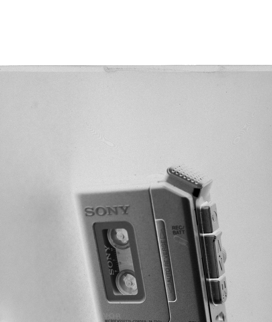

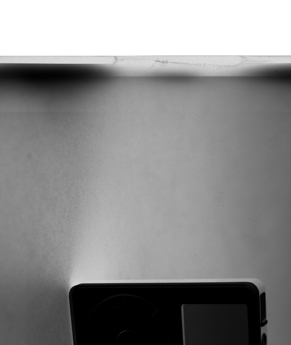

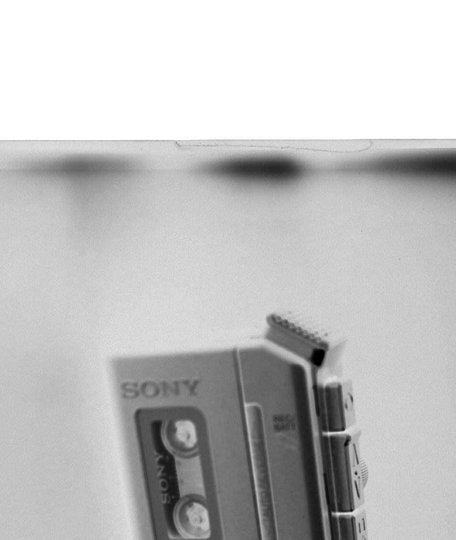

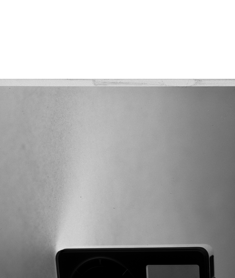

Yesterday I made four exposures of two objects with a Linhof Technika. I used two different film holders, and I got one plate ok and the other with a light leak, on both holders, as is shown here:
film holder 1 a.jpg holder 1a film holder 1 b.jpg holder 1b film holder 2 a.jpg holder 2a film holder 2 b.jpg holder 2b
Besides the probable explanation of not fit the holder properly, twice, there is any other reason you can figure out?, should I see if there is something wrong in the holders? or the camera?, where do I have to search.

Hi Jose. Personally, I'd rather see the negative rather than the print. What kind of holder are you using and what type of back do you have on your Technika. It might be something really basic like dust or dirt trapped in the rail as was suggested, but there's other things to look at.
First check to make sure the holder is sliding into the back properly AND that once inserted, it lays perfectly flat and is tight in the back. Check the springs for looseness and make sure nothing is bent or sprung improperly.
Are you sure your film box / packet didn't leak before or while you were loading? Take some "unexposed" film, a couple of sheets from the top and bottom of the same pack and develop them. Look at the negs and see what you have. If it's streaked, there's your answer. Your film is fogged. This wouldn't be uncommon, especially if it was through an airport scanner recently and is even lower speed film like ISO 100, not just the faster films like 400 ISO.
If that's not it, get a really bright flashlight, take the camera into a very dark room and with the back removed, check for leaks in your bellows regular or bag. They develop light leaks. If you can see light through them, there's your problem.
Keep us in the loop and let us know how you're progressing.

If the lightleak is on the top of the film, (where the notches are) I would expect that it is a problem with the darkslide.
Have had simmilar problems with 2 old fidelity holders and sorted them out.

Thanks all for your interest. I was out of twon for a few days, I'm back at my studio, after checking the conditions of the camera, as suggested, I'll expose the two holders giving special atention to fit the holders properly and carefully. I must say that I posted the negatives not prints, and proces the four negs together in a Jobo procesor. Because I didn't know about the leakings, didn't take note of the order for each holder so I can't precise wich is side a and wich b on each one.

I just finished developing the plates I made with the holders in question. I follow all the advice you gave me, and there is no leaks. Working carefully I found out that I'm the culprit, in my first take, when I turn the holder to make the second exposure, I realize that, even that it seemed that it was properly fitted, the holder wasn't fully seated on the inner rib, that needed an extra 1/16" to the end, leaving a small space that could produce the leaks.
I've learned a lesson here, I have to work with more attention on what I'm doing, don't take anything for granted.
