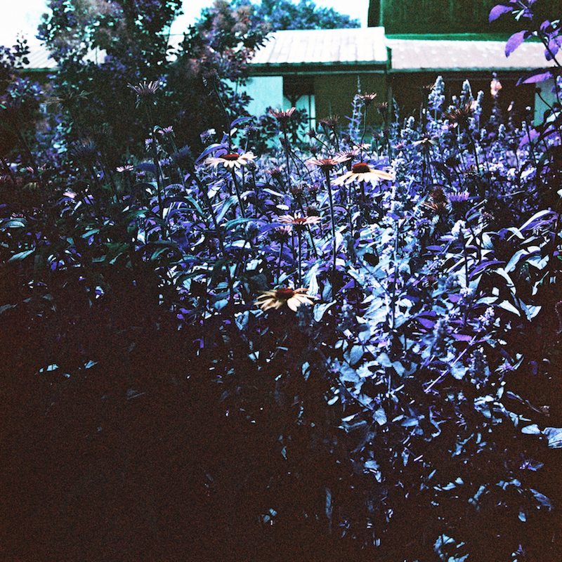

For the first time (and Ironically using Lomochrome for the second time), my Yashica Mat 124 has given me some seriously light leaked images. Now I do like the way some of these have turned out, but I wouldn't want this to continually happen. Does anyone have any suggestions why? The only thing I can think of is I loaded it outside in the shade of a building.
Plus, the next roll I started was also loaded in the shade outside, so I'll have to wait and see what happens.
Beginning of the roll.
Middle of the roll
Very last frames

You will probably have to shoot a roll of what you normally use to know for sure.

I'd say the light leak vignette even works on the first shot :-D
But one more thing strikes me in that image, look at te middle right. Are those '2 2 2's coming through from the backing paper?

Seriously, it looks like loosely wound film. You had problems at the beginning so it loosened up a bit, then it loosened at the end with unloading. I find that Foma film, for example, takes much more care to avoid it loosening, both loading and unloading.
That actually might be my favorite from this roll, and I didn't see those 2s until you pointed them out- and I'm sure they are from the backing the paper.

Gotta agree myself, looks like light leaks from a loosely wound spool. I find the lomo 120 film's adhesive tab difficult to remove before you insert your film prior to shooting. Sometimes I've wondered if I have loosened the overall spool getting this tab off.

I'm sure it's a light leak from a loosely-wound spool. I had exactly the same issue a while ago when I was trying out an ancient Kodak Brownie 8-on-120 box camera, which wound the film slightly loose and askew........random fogging and, particularly, the backing paper numbers reflected onto some of the negs.

well, it didn't happen the first time I used it a year ago.
How do you know they didn't change supply sources in the meantime?
Looks like a loosely rolled film to me.

The head of the backing paper was different (I was kind of surprised when I saw it), the box itself said new formula, I got some deeper purples this second time, and my internal light meter didn't even work back then. I guess I'm not used to this sort of thing happening. I guess I was just expecting similar results, and just don't want every roll I shoot to end up like this.
The only way to check if a camera is at fault is by running some decent film threw it .
Needn't be expensive , Fomapan 200 exposed at ISO 125 always gives me good consistent results .
Or treat yourself to some Ilford film .
If they come out fine , you know the cameras good and it's your Lolo film that's iffy .
