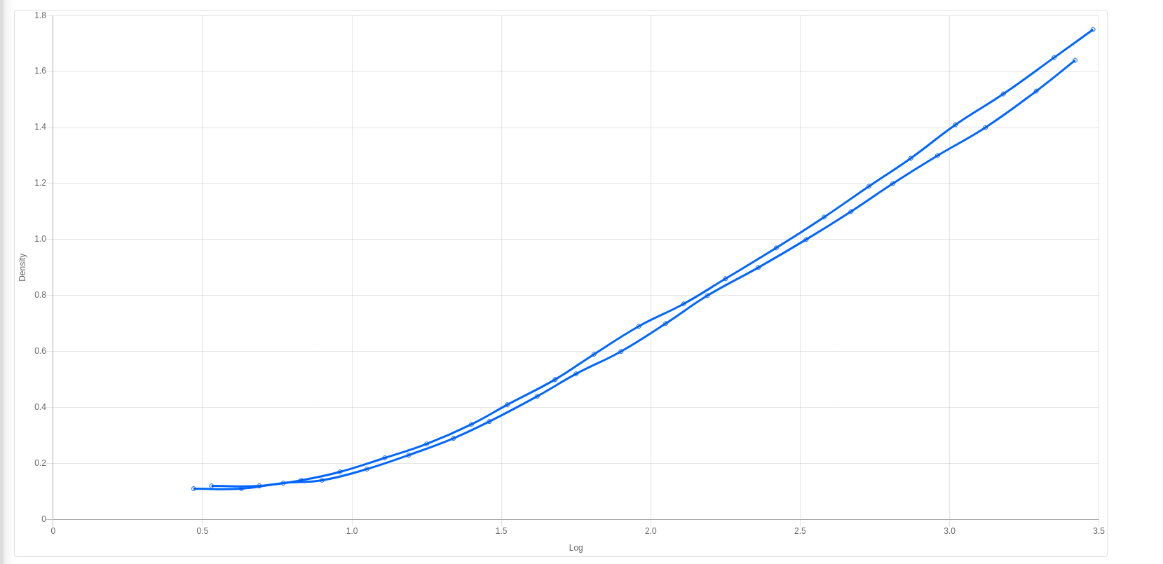

I don't have current curves for CHS ii yet (I hope to by this weekend as I'm developing some important CHS sheets from a recent vacation) but here's Fomapan 200:
Top line is Xtol-R and bottom is XT-3. Xtol-R was for 8:30 and XT-3 for 6:30. This indicates to me XT-3 is either still seasoning or my replenishment rates are such that it has ended up stronger than my Xtol (which had some of the recalled bags run through it). My gamma is 0.63 and 0.62 respectively, though I think next time I'll add maybe 30 seconds to the developing time since it does seem to have a lower slope and I expect the contrast index will be lower (I haven't done those yet but need to - I still do those on pen and paper).
So far *knocks on wood* replenishing seems to be working as it should with the only possible issue being the sludgy solids that seem to collect in my jug. I did have that with Xtol as noted but I still don't like it either way. Being 2 1/2 months in is maybe a bit soon to determine longevity but so far so good!
