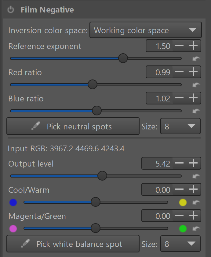

@iliks However, I tried installs of RawTherapee 5.9 and 5.10, and neither of them have the Film Base selection under the Film Negative tool in your article:
vs
