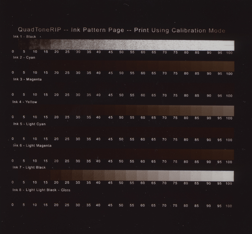

Hi, Andrew:
That's very interesting. Can you tell me how you measure the DR. Is it with a UV densitometer? I don't have the capacity do this myself so I have no way to compare. My Centennial POP print (Se-toned, un-toned is worse than this) with the QTR calibration mode looks like this:
The densest inks are in the order from high to low (similar to your findings): MK, PK and Y and the rest are all pretty transparent. At 100% MK, it gets almost to paper white, however for PK, it does not. MK also seemed to have some serious noise problem that were absent in the other inks. Ink-dot noise is an exaggerated issue for this glossy gelatin coated paper that may not be for hand coated water color papers.
Anyway, we are probably going way OT at this point (hope Dan doesn't mind.)
:Niranjan.
Andrew O'Neill
Jan 16, 2004
12,681
Coquitlam,BC Canada
P400. Using the 2880 Unidirectional settings.
The calibration neg doesn't correlate with the P400 inks... which ink is which? I didn't bother printing one out because of that. Instead, I went straight to making a profile (using my old curve) and printed a negative (with a 21 step wedge). With a bit of tweaking of ink output, I nailed it. I can easily print Carbon Transfer, Kallitype, Gum, Cyanotypes... Did you make a negative from one of your images?
nmp
Jan 20, 2005
2,054
Maryland USA
Yeah the labels are from R2000, sorry I forgot about that...From top to bottom: MK, C, M, Y, R, O, PK, and GO. I didn't make a negative of an actual image for the POP prints because I was not happy with the less than clear whites - not as good as what I was used to in HP B9180 (kind of spoiled I guess.) I did try dialing in various combination of MK, PK, and Y using QTR but wasn't very successful. In the mean time I found this used moth-balled B9180 and focused on reviving that. The P400 (straight without QTR) did work pretty well for salt printing as I documented here:

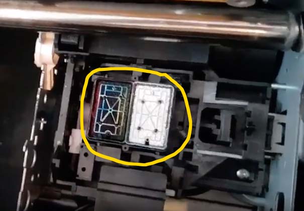

I have tried hard to recover the clogged print heads of my Epson, but with limited results. I have fully recovered black and partially yellow but not light grey. And the light light grey died, as well (it was probably my fault).
After my anger slowly subsided I ended up with buying another new Epson SC-P600. The main reasons were that I still had a full set of new (not cheap) inks for it and with a new different printer I needed to re-make all the curves for my DNs. And, of course, the fact that I am used with the good quality and the few limitations of its inks. I didn't want to lose its' very good "Advanced B&W" mode for printing DNs. I'll pay much attention now at printing something at least every 2 days and at keeping humidity high inside the printer when not in use. I made a humidifier for that and I'll buy a rubber cover, too. Let's hope I'll be luckier this time.
I managed to fully recover my older HP plotter, too, by changing 3 of its 6 print heads (not very expensive and very easy to do). Very reliable this HPs...
I am back in business now. :smile:

Dan, 8 of my P600's 9 printheads plugged up after I hadn't used the printer for awhile. I got it going by running the head declogging cycle 8-10 times and wet-capping it. Wet capping fills the capping station (that seals the printheads when not in use) with solvent. After an internet search, I found an easy method that doesn't require disassembly. Run the Maintenance > Nozzle Check cycle. As soon as the cycle starts, unplug the printer. This stops the printhead in an unlocked position. Now you can find the capping station at the far right of the print well:
You can buy print head solvent or make your own. I use 8 parts plain Windex (not Ammonia-D) to 2 parts isopropyl alcohol (70% or 99%). Fill both wells and then turn the printer back on. After a self-test the printhead moves over the capping station and remains humidified overnight. I do this when I won't be printing for several days.Between running the nozzle check every few days and wet capping occasionally, I haven't had any further problems.
