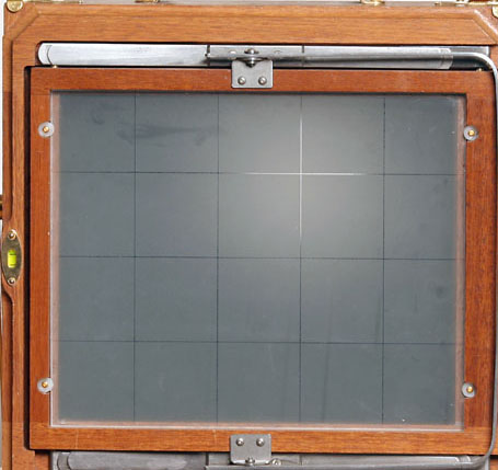

Just yesterday I got the package from Germany, a brand new (used :smile: Zone VI 8x10...
I was really suprised bu its bulk and weight (something like 7.5 kg with the Fuji 420mm lens) and the capabilities (swing, tilt, bellows extension)... I guess that I will have to exercise more to build my muscles and to be able to carry it around...
Anyway, here are my questions to you LFers (and Satinsnow in particular, for the first one):
There is a mark (see photo) on the ground glass, in resembles to a grease mark (like if someone touched the inside part of it with dirty fingers). Can it be cleaned with some detergent ? Is it dangerous to use chemicals on the inside surface of it ?
The camera uses Sinar lensboards (this is good, for I can use all the Horseman lensboards I have). Has anyone tried to mount a Zone VI lensboard on a Sinar (or a Horseman) ? The size and thickness are the same, but the Sinar ones have a strange pattern on the inside surface that might be there for light-fastness reasons and the wooden ones I got for the Zone VI don't.
There is some (only cosmetically disturbing) oxidation on the brass parts. Can it be removed, using something like Brasso ?
I got a 4x5 reducing back with it, which I doubt I will ever use, for the camera is too heavy to carry around and my Linhof is much smaller and lighter. Would anyone be interested in buying it ? How much would it be worth ? Do you think it would be a good idea to sell it, or will I regret it some day ?

George, the 4x5 reducing back for my 8x10 is a great addition to the camera. Do you have a 420mm lens for your 4x5? Also, you will have plenty of coverage with this lens and the image quality in the center of the image circle will be very good. I would keep it if I were you.
If it is a standard ground glass, a small amount of soap on a soft cotton cloth should remove a finger mark if it is just oil or grease. Don't use a paper like tissue paper, it may leave behind some fibers on the glass. A small dab of glass cleaner applied to the cloth first should work as well. I assume this is actually glass and not some type of plastic.
Clean a small portion of the brass in an area which doesn't show at first, but a standard metal polish like Brasso or Flitz should work. Nice camera, want to see some images when you are set up to shoot with it. Best of luck, tim

George - congratulations on the new "baby".
For conventional ground glass, I like warm water and mild detergent for cleaning, applied with a soft paint brush, like one would use for painting window trim. That assumes removing the GG from the wooden frame, so as to avoid getting the wood wet. The smudge on your GG looks like oil to me, so that should work OK. If the smudge is resistant to detergent, window cleaner is OK, too, as mentioned - as long as the GG is really glass. Same caution when cleaning metal parts - keep the cleaner from touching the wood by using a plastic shield of some sort. (The same common sense sort of thing.)
I, too, would suggest keeping the 4x5 reducing back. Not only are they good for shooting Polaroid tests, but also for shooting 4x5 film with lenses longer than would be possible on a typical 4x5 field camera.

I wouldn't use metal polish to clean the brass as it can migrate into the screw holes and rot the wood underneath.
As for cleaning the ground glass, the only issue I see is if the lines have been drawn on with a pencil or not. Washing will remove the pencil lines, but the grid can be redrawn if need be.

I usually just take out the ground glass and wash it off in my kitchen sink with Dawn dish soap (whichs cuts grease) and a sponge. If you need lines, you can draw them on with a ruler and fine point pencil.

Rather than use the Brasso or other chemicals, use a jewelers cloth, takes a little more effort, but you don't have to worry about damaging your Zone VI.(always wanted one of those, enjoy!) Pat :D

With a GG with no plastic printed grid lines, the fastest cleaning agent by far is methylated spirit (industrial alcohol) applied with a soft duster and removed with a second dry duster. Takes about 45 seconds to clean a screen, instantly dry, no dismantling required! For plastic screens, I'd use a silicon spray, great for getting stickinesses off all kinds of plastic and guaranteed not to attack the material (unlike alcohol or lighter fuel!).

The ground glass is glass (real one), and I think it's good quality (thick and well made, the grids made out of an unknown insoluble compound, maybe epoxy).
I tried window cleaner, dish cleaner, alcohol and nothing worked. It seems that the marks are made by a varnish or something else that is not greasy and not water- or alcohol- soluble. My last resource will be Acetone, but it may dissolve the grid and the only Acetone I have in hand is the one that my spouse uses to erase her fingernails (well, the paint from her fingernails) every 12 hours and it contains an oil for lubrication (of the fingernails, I guess ? Why would anyone want to lubricate her fingernails ?).
What I also don't understand is why this ground glass has no cut corners (to check the lens coverage). How can I ever be sure if I my lens covers the surface of the film when I make a swing or tilt or something ? (or a twist - and - shout, for the same reason) ?

If it's varnish, how about the one solvent you've apparently not tried - turpentine? If not, the only solution may be an angle grinder or a large hammer and chisel!
