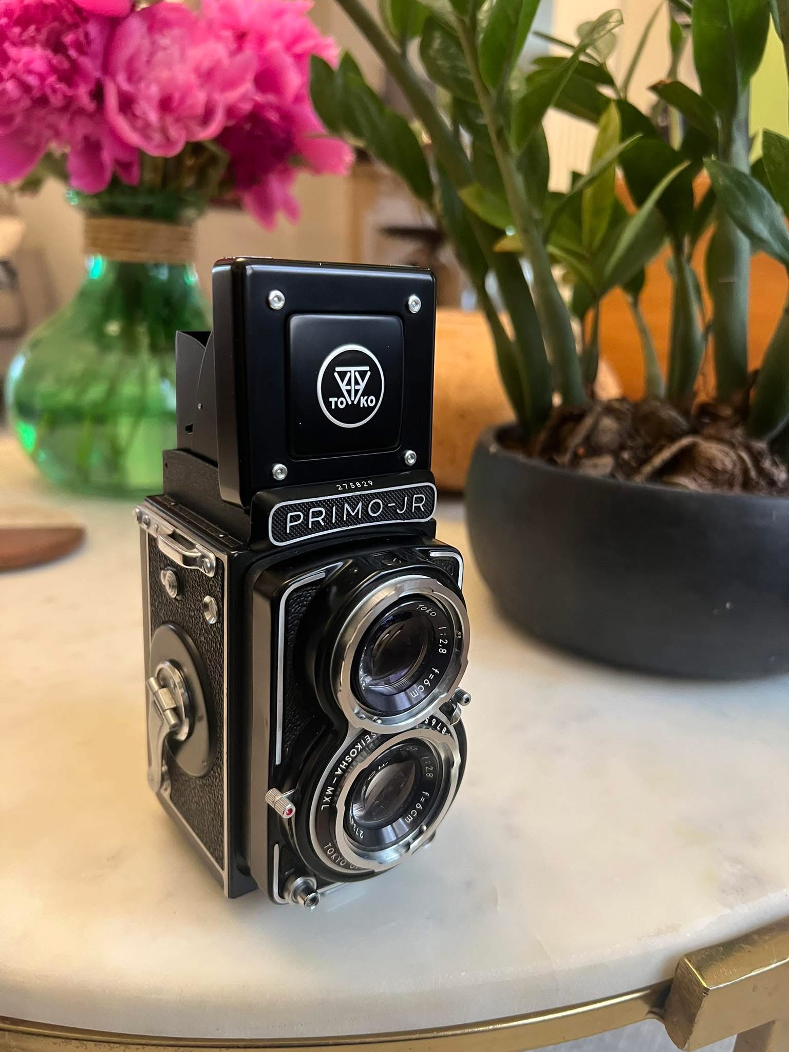

This came today and it’s pretty perfect condition. 127 is a pain to pay for or cut down but I love the tiny size and this is the easiest to focus tlr I have thanks to the f2.8 viewing lens and the huge magnifier.

127 TLRs have got to be the cutest camera ever made. They are like kittens, you just have to take them home and always fun to play with.

The Primo Jr. is probably the best 127 camera around. It's much more reliable than the Baby Rolleiflex, infinitely more sturdy than the Komaflex (a 127 SLR), and the lens is top-notch.
127 film is quite expensive these days, but 100ft and 200ft rolls of 46mm film (127 is 46mm wide) can be found pretty frequently for sale. It was used in bulk in school portrait cameras right up to the transition to digital, so it's possible to find film that expired in this century and still works well. Mostly it's Portra 160 & 400nc and Agfa Portrait out there. Might be worth a look if you want to save some cutting.

Never heard of this! There are countless Rolleiflex knockoffs, good and bad ones. This one looks like a really high quality camera and the condition is beyond beautiful. Congratulations.

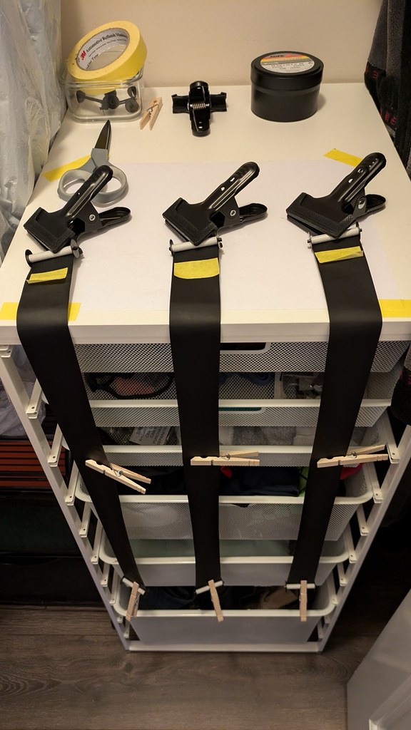

Since both feature automatic film advance and frame counting, it is possible to use home-brew 127 rolls sliced down from 120 rolls. I use the FCK127 kit, which is ok for slicing. But I use a dark change bag and two 127 spools to manually re-spool after the slicing.
I have a few cans of 46mm bulk film, and can assemble my own 127 rolls quite easily by reusing the backing paper from ReraPans. See a photo below with three rolls going, in my tight walk-in closet as dark room. As another poster said, the expired Agfa XPS Portrait 160 ages very well, and I got very good results from 2001 exp date film. Just need a bit of white balance tweaking by shooting the Xrite color targets.
