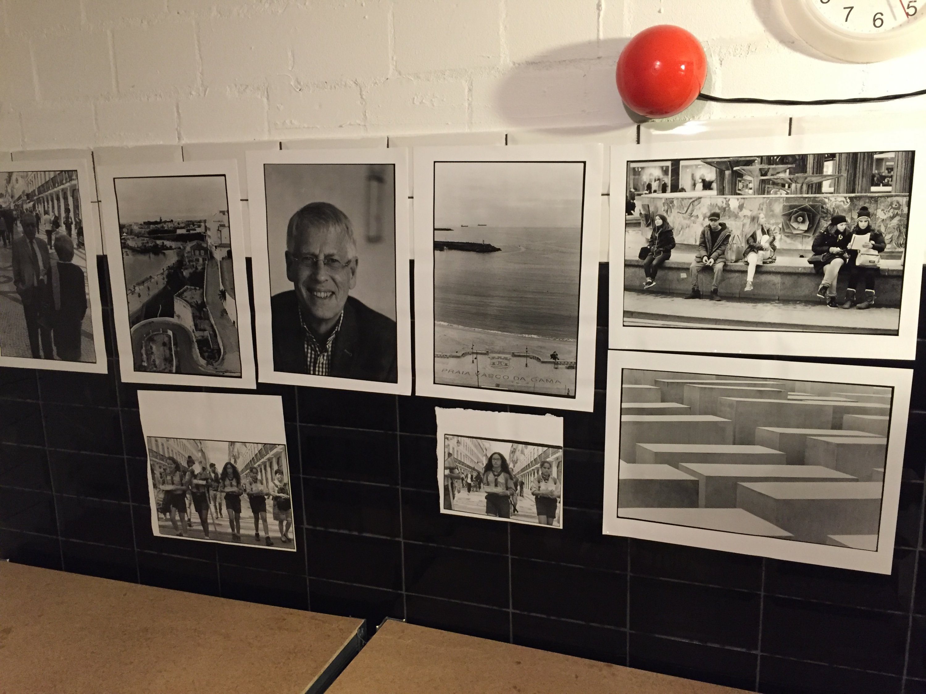

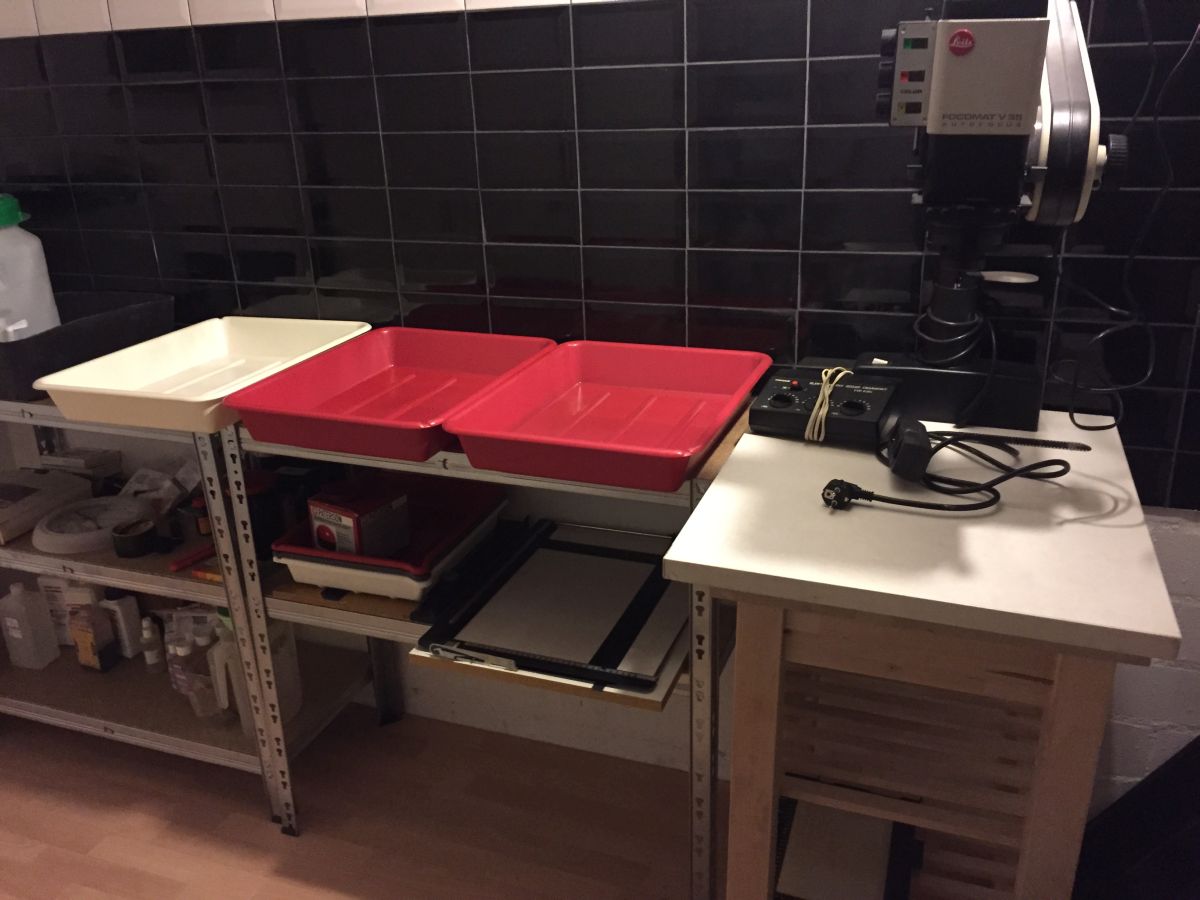

Finally I have dedicated darkroom in my basement (8 m2 only for me :smile: ).
In winter it is relatively cold (15 dgC), so FB print developing takes 5-7 minutes, and fixing I do at least for 10 minutes, just in case. But beside that - all is great, I finally enjoy making prints whenever I want :smile:.
Still I am not sure what to use on the wall when I will be doing 1x1,5 meter prints (I have Axomat enlarger that can rotate the head for 90 deg), what kind of plate should I hang on the wall (the wall itself is not flat). Is there a some relatively cheap, but good solution? How to fix printing paper on the wall, with the painter tape / masking tape?

Hi Darko,
I would do it with ply wood (Pressspan from OBI/Bauhaus/Hornbach), glew a thin metal sheet on it. Hang it on the wall, perfectly adjusted.

I used the door of my refrigerator with magnets. There is now a magnetic paint. 2-3 coats of that on a piece of good quality plywood would be great!

Very nice. I'm sure you'll make some fine prints in there. I'm using IKEA-ware as enlarger table too. The very stable IKEA Björkudden bar-tables are excellent for this (unfortunately they went where most of the solid and affordable IKEA stuff goes: discontinuedland). The serving table is rock solid too.
For wall projection, another idea would be a whiteboard (maybe painted grey, if necessary). Magnetic tape or a handfull of small powerful magnets should to the trick. If you don't want to drill into the walls, the bigger whiteboards come with a rack on wheels too.

Yes, Ikea table is great, perfect size and stable. 8 m2 is indeed big, before I used bathroom, and now with deditaced place - I am more than happy :smile:. I got some ply wood, so I will see how this goes on the wall.

Sweet! Just great to have your own space, even if it isn't perfect. Using it will give you ideas on how to improve it. FWIW, the easel I use for 16x20 is a metal sheet with magnets to hold the paper. The same concept should work vertically just fine. It might just take a little fiddling to know exactly where to put it so it won't fall, etc.. Enjoy!

You don't really have to have the paper perfectly flat. The depth of field will cover it, although it must be parallel to the negative/lens. Frankly, with those tiles on the wall, I would just tape the paper up. The tiles would be great to aid placement.
If you want to put something on the wall, I would use galvanized steel personally. It won't rust and you can use any type of magnet you want to hold the paper up.
A few weeks ago I was on Youtube and saw a German guy making huge architecture enlargements in his darkroom which looked pretty primitive to me. You might want to check that out if you can find it. Also check out Clyde Butcher's darkroom. He does large prints horizontally. I think the biggest problem you are going to have is aligning the enlarger to the wall. That is going to be a pain if you move the enlarger.

...looks like your dishes aren't in a sink so you're going to get some spills. In fact, like me, you don't have a separate dry side and wet side. All my dishes are in a sink with a clear Perspex 'splash side' to keep water away from my enlarger. Just out of interest, are you left handed?
50-50: I write with right hand, but holding spoon while eating with left, on camera I am left eye dominant.
Sink I will make later: right now I have some semi-solution, when time and money allows it - I will make proper sink.

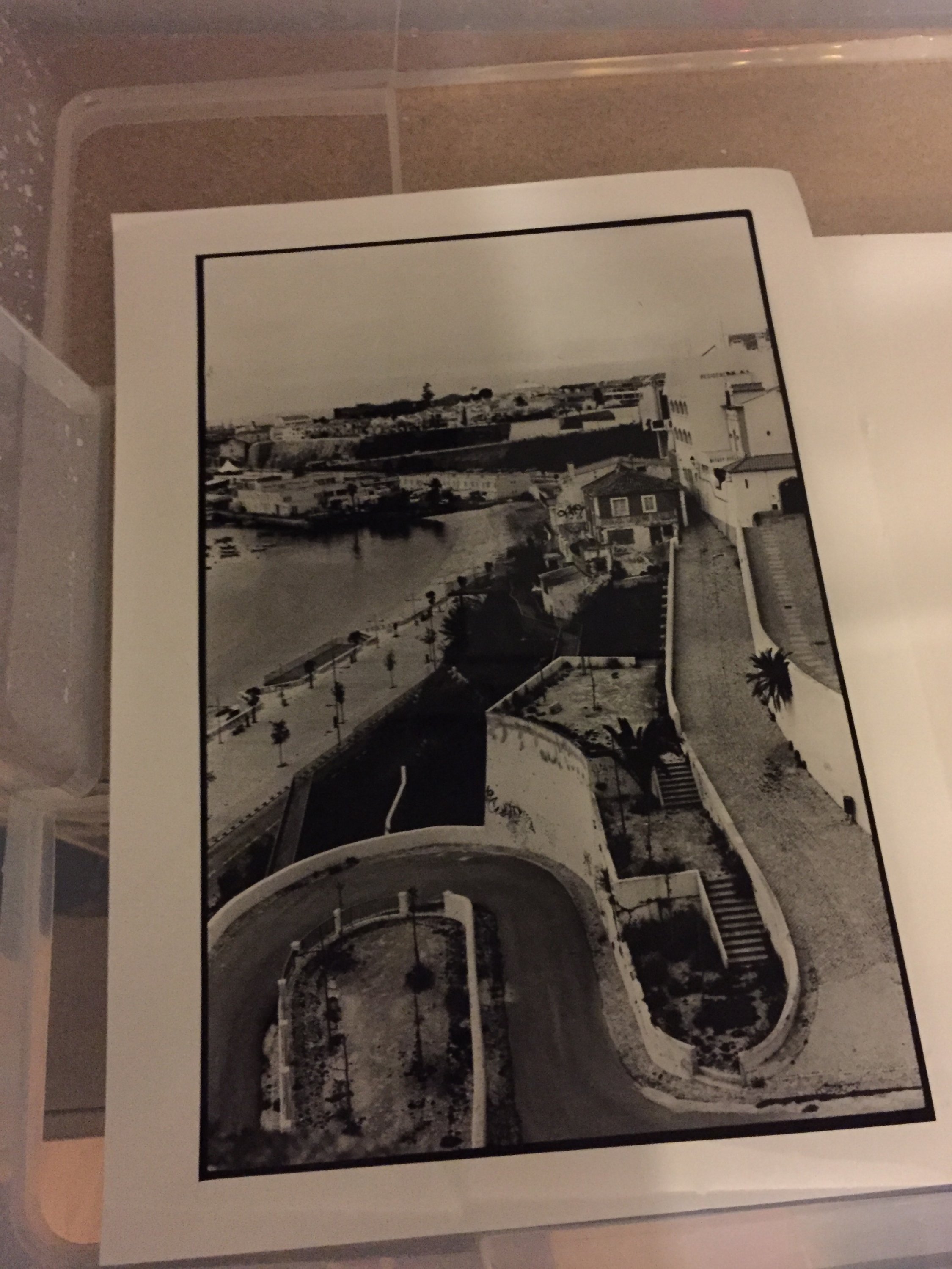

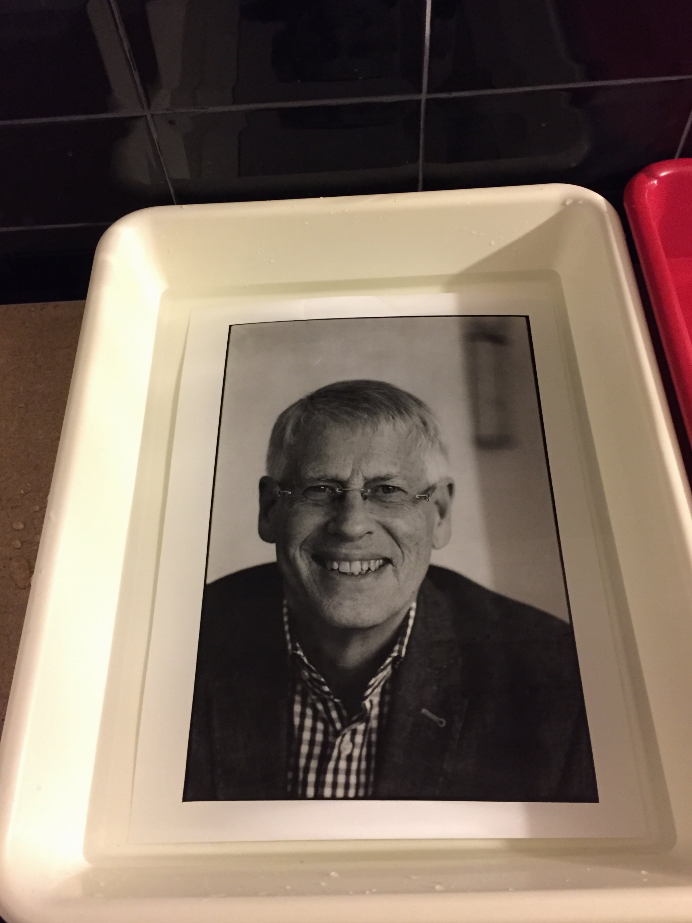

Today I did some 30x40cm prints, with Mörsch Eco 4812 developer, and used last Fotokemika Emaks papers...
...thought so - looks like your working direction is right to left.

Darko, congrats on the new darkroom! I have a suggestion for the cold chemistry. I use medical heating pads, like to be used for your back. They can be picked up at a pharmacy or drug store. Mine have 4 settings, and I use the lowest setting and it keeps my chemicals up to temperature and my darkroom can get down to 50 degrees fairenheit in the winter. They work great under the trays!
