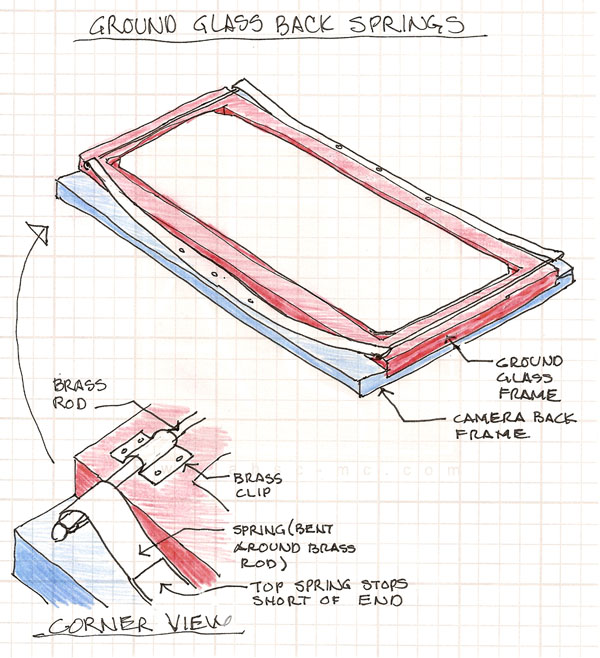

Hi Phil,
The springs on the ground glass back were made out of brass that I got at Home Depot (door kick plate). The strips are about 5/8" wide and there are two thicknesses on each side of the back. These two thicknesses seem to give about the right amount of spring pressure to hold the film holder. Note that the top spring is about 2" shorter on each end than the bottom one. The bottom one is bent into a loop at each end that fits around a brass rod. This detail is similar to the 8 x 10 Kodak 2D that I have.
The attached drawing will show you how it is made.
Regarding the bellows - I made it myself. This is not the first bellows I've made, but it is clearly the largest. The inner liner material is white drapery blackout material (only comes in white) and the outer liner material is black egyptian cotton. I hand painted the inside surface of the drapery liner flat black and it's working just fine.
Hope this helps,
Dan
