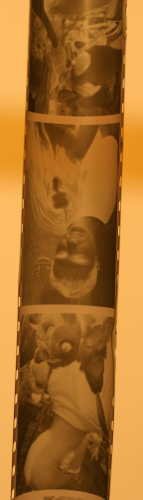

I've had the same problem with APX using club chemicals.
The negative curves very strongly when dried and stays that way. When I put it in the film holder it is not flat and the edges are a bit blurry.
Why does this happen?
How can I change this?
Film: APX
D76, vinegar stopbath, water rinse 2-3 times, fixer, water, distilled water
All the chemicals have been mixed in distilled or deionized water... I don't remember which.
Help

g'day Andrey
why are the negs that colour?
what are "club" chemicals?
have you tried soaking and hanging to dry?
maybe you need to use glassed neg carriers
Ray

g'day Andrey
d'day to you too, Ray
Wrong color balance on my d*g*tal cam. :smile:
D76, indicator stop from kodak, Fixer of sorts.
They were soaked when I developed them. I did rinse them, so I thought more soaking wouldn't help.
Can't afford one... and I'm hoping there's a better solution for 35mm.

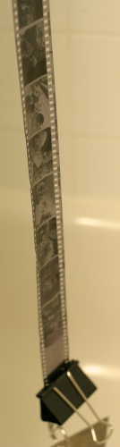

Nice, I tried to use the banker's clips and it works much much better, at least so far.
They should be ok for the time being, just add some suitable material to them to add a bit more weight. As I've already mentioned I've used strips of lead wraped around the film clips. You can always clip on another 'banker's' clip to add a bit more weight if you feel the need.
Good quality anti-Newton ring glass should not effect the quality of printing regardless of film format.
