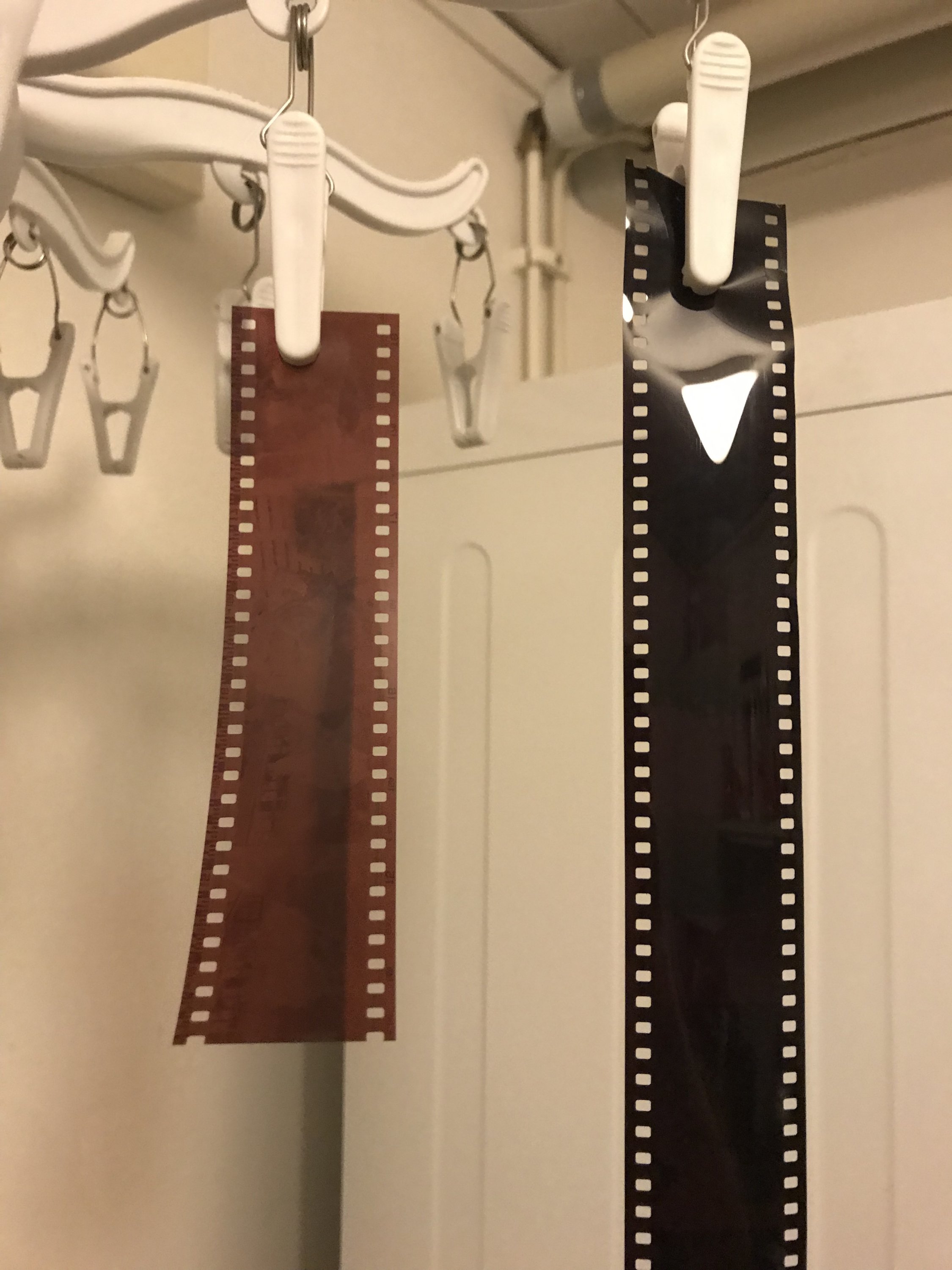

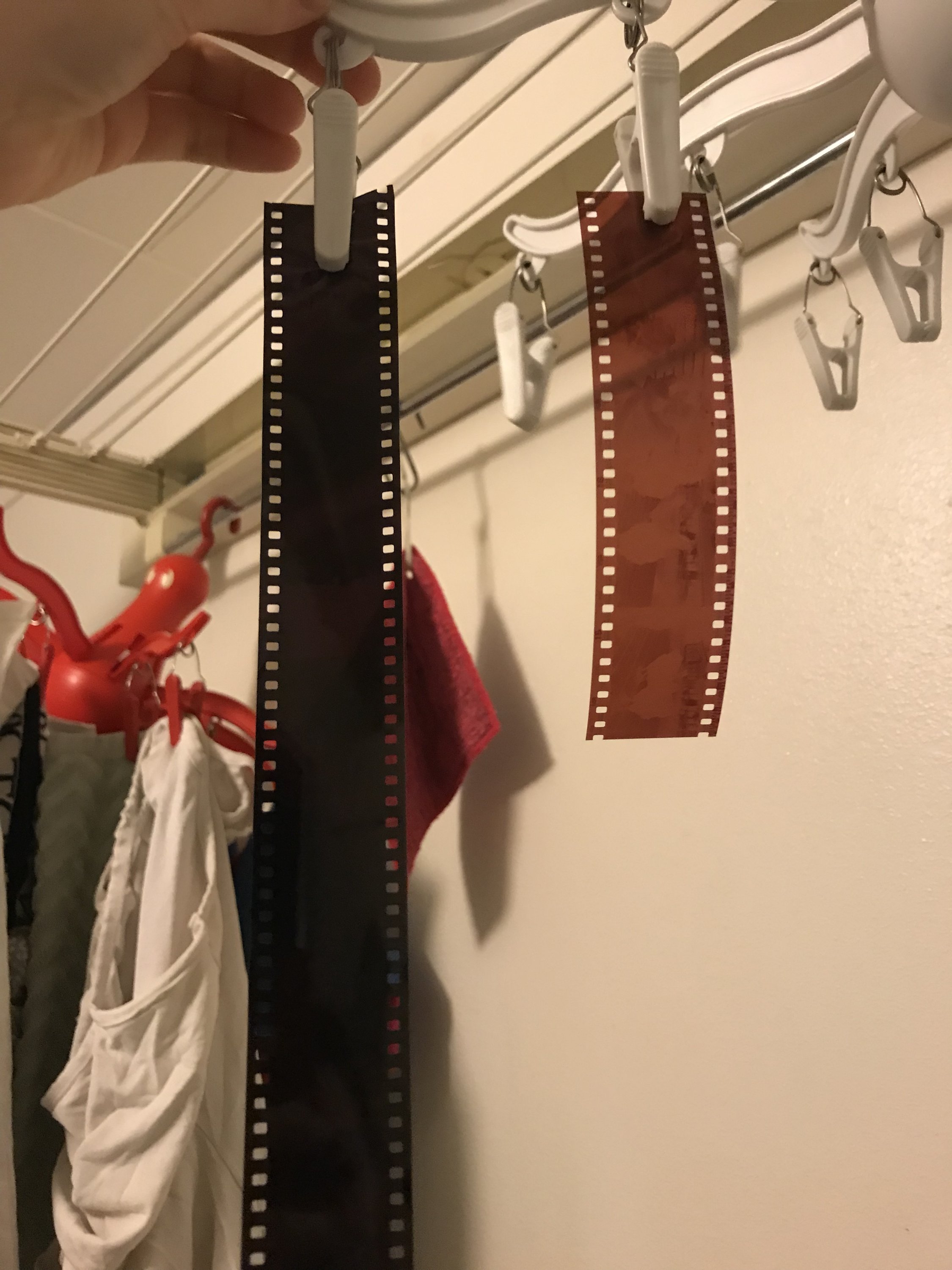

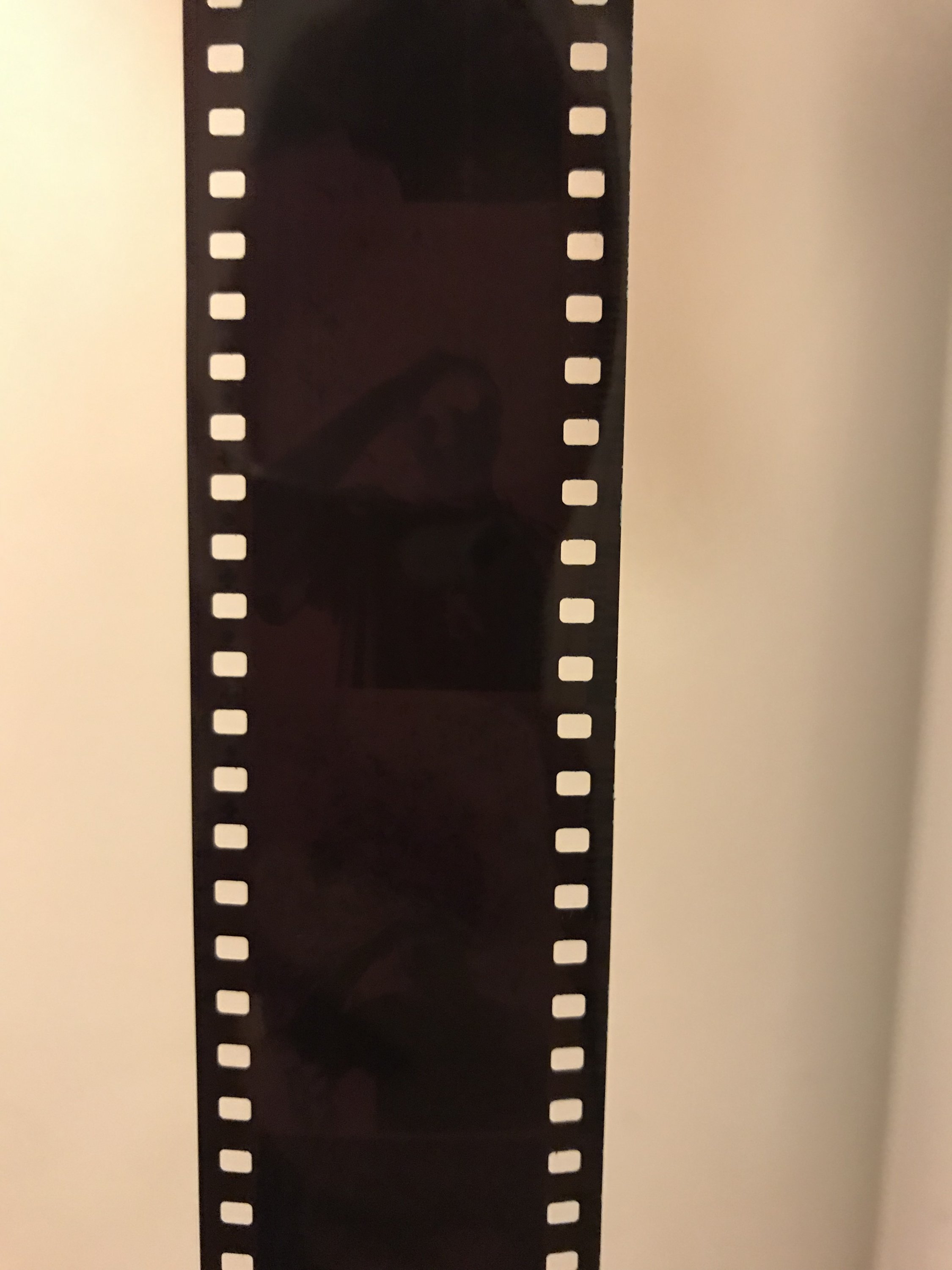

I just developed my first roll of film using the stand development technique with a C41 digibase kit. The first roll I developed was an old one which I did not know how it has been stored, (possibly 10 years old, left); I was also not able to overexpose it. In comparison to a commercially developed roll (10 yrs old but stored in freezer), my own development turned out very dark. When I pulled it out of the reel, the back was milky light brown, which then dried to semi-transparent. I am wondering what I might have done wrong, or if it is just due to underexposure of the film.
(Photos below for comparison)

C41 is 3m15s at 38C or 100F with continuous agitation. Stand development may lead to undesirable and unpredictable results. Try textbook development and take it from there.

The film rebate is dark, so it didn’t happen in the camera. Unless the film was exposed to light at some point before processing, it’s a processing issue. Use the normal process for C-41 before experimenting with stand development.

Film was totally fogged either through longterm storage in adverse conditions or by someone exposing it to light. While I have seen some old C41 film fogged through storage that turned out very dark, an evenly and densly black film would suggest fogging by complete exposure to ambient light.
You did take the film out of the canister and load it onto the reel and into a developing tank in total darkness, did you?

-) Yes, your film still shows faint images, thus your film is not completely black as considered above, thus very unlikely fully exposed to light. Likely you applied extreme overdevelopment, by this blackening even unexposed parts
-) a milky effect is typical of such colour film
-) as said above start your film processing career with the classic approach
(classic b&w film with a middle-of-the-road b&w developer)
Actually I am even wondering what you tried to achieve with your experimental approach.

Koraks is correct. You cannot treat C-41 process like traditional black and white film. You must follow the time/temp chart for the process. You over developed your film.

Stand development is not for use with C-41 films. Stick with tried and true process.

Thank you for showing us what happens when you try to use stand development with C41 film and chemicals.
Most/none of us would have expected that it would have worked. You have confirmed our expectation, but I for one didn't know how it would appear if we tried.
I'm sorry your negatives were ruined.

as others said,the film is totally fogged and over exposed. I also suggest to take a fresh film and try textbook development. You can do much better than this,I'm sure.
