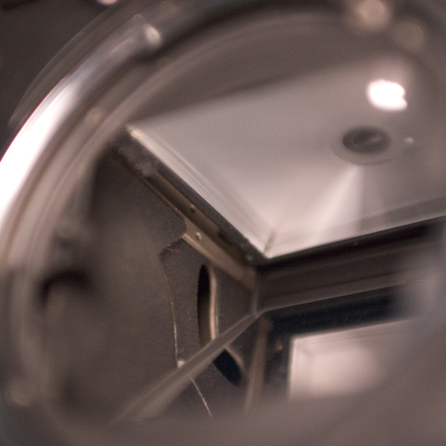

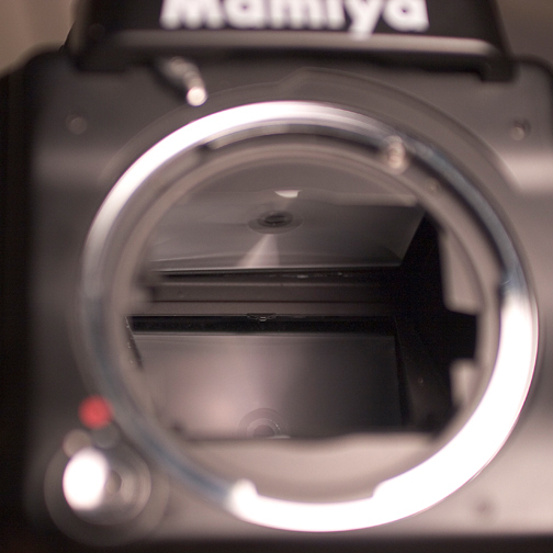

Ahhhhh! I just looked at it again and it looks like the ground glass is slightly lower on the left side when looking at the camera! I hadn't noticed that before. I know people mentioned about trying to take it out but this camera isn't supposed to be able to have changable gg's is it?
And about thinking I might put the lens on incorrectly, I didn't realize that you didn't have to fit the little groove around the metal peg outside the lens while you were putting it on. I didn't realize that as you twist the lens on it will fit itself in haha. Shows you how much I've taking that lens off.
Anybody think they may be able to throw together some checks and possible solutions to getting this thing back up there? I'm also not sure which side should move; I don't know if the right should come down or the left should go up. I just would really love to keep it out of "the shop" where I would have to pay somebody to do something like this unless it's really necessary.

Feb 17, 2006
51

Without having the camera in hand, it appears that it was subjected to some sort of impact that dislodged the screen. Perhaps in shipping?
Rather than mess with it I believe you should return it to KEH & have them repair/replace the unit. That is Before you attempt to correct it.
