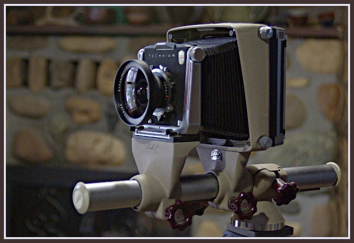

I'm back into film and this is my large format camera. Problem is my eyes now . . . especially with the 90mm Schneider shown, I'm having trouble picking up the image. I'm wondering if there is a reflex hood (or what you'd recommend) available for this model. I'd appreciate any advice.
Additional info that might be helpful - I had a stroke 4 years ago and lost my right (master) eye . . . and I'm an eyeglass wearer. Groundglass viewing is increasingly difficult, but I sure don't want to change cameras!
Thanks

The back is the same as the Tech IV/V/Master Tech back, so it should take the same reflex finder. You might just try using a darkcloth rather than the folding hood, well sealed from light leaks, and let your eyes get used to the dark to view the image. A fresnel will help, if you don't already have one, with the wide lens. You can also look into getting faster lenses to give you a brighter image wide open, though that can be a big expense.

Thank you for your reply. I have located a Tech back, and the seller said that he guarantees it will fit or I can return it, so I think that's the route I will go. I actually don't have a fresnel lens . . . . I may pick one up in the future but I have a lot of other photo projects on the go. My standard lens is a 4.5 150mm Technica, and it's fine. If I go longer, I'll certainly get the fastest one I can.

I've never used the reflex finder, but I think it doesn't work well without a fresnel. You might want to keep an eye out for one. On the Tech IV and later backs, the fresnel goes on top of the groundglass and is usually held in place with two clips, in case you might want to remove it, though sometimes you find it installed without the clips simply under the flanges that hold down the groundglass.
Your 150/4.5 is probably a Schneider Xenar, which was a common Linhof lens at the time (I have one for my Tech V). If it's in a "Technika" engraved shutter with "Linhof" engraved on the barrel, then it's a Linhof select version, which means it was tested by Linhof and passed inspection.

Yes, it is a Technika engraved shutter with "Linhof" on the barrel. Thanks for pointing that out.
Before I do anything, though, I think I'm going to remount my Schneider 90mm in a recessed lensboard . . . and try your suggestion of a dark cloth. I think that would be the easiest and most practical solution.
If you notice the picture above, I had to re-mount the camera IN FRONT of the rear clamp because if it was normally mounted, I couldn't focus the lens to infinity.
That's a standard technique for wide lenses with pretty much any monorail that has a beefy clamp in the middle or knobs that may interfere with each other. I do that fairly often with my Sinar P, and occasionally with my 8x10" Gowland as well.
