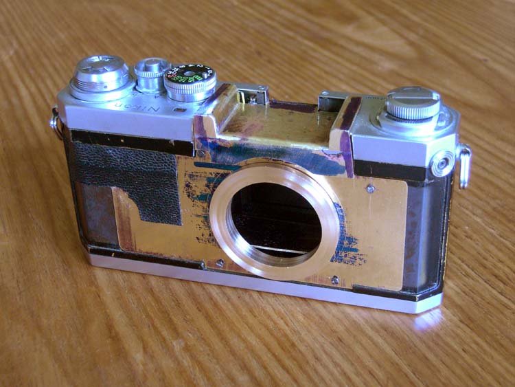

I am currently converting a Nikon F (great camera) from an SLR to an
non-viewfinder leica screw camera. I have removed the front casting and
mirror box reducing the weight by 250 grammes. I have made a new front
panel from brass( I had planned to use aluminium for light weight but
got impatient waiting for it to come by post and used what I already
had in stock). I plan to use a Voiglander Heliar 15mm lens so lack of
rangefinder shouldn't be a problem. I had originally intended to try to
include one, see my earlier posts, and even acquired one through the
kindness of another group member but realised my limitations before I
had wasted too much time. The Heliar viewfinder will fit in the recess
at the top of the camera (see photo). I am trying to keep the
size and weight down as much as possible. The lens mounting ring in the
photo will have to be reversed in order to achieve the Leica lens
register of 28.80 millimetres but it can be done! One advantage of
removing the mirror assembly is the reduction in noise, I intend using
this camera for candid photography. I used to use a Contax II and it
seems comparable if my memory is correct. So far I have done it all on
my own but any input would be appreciated.
