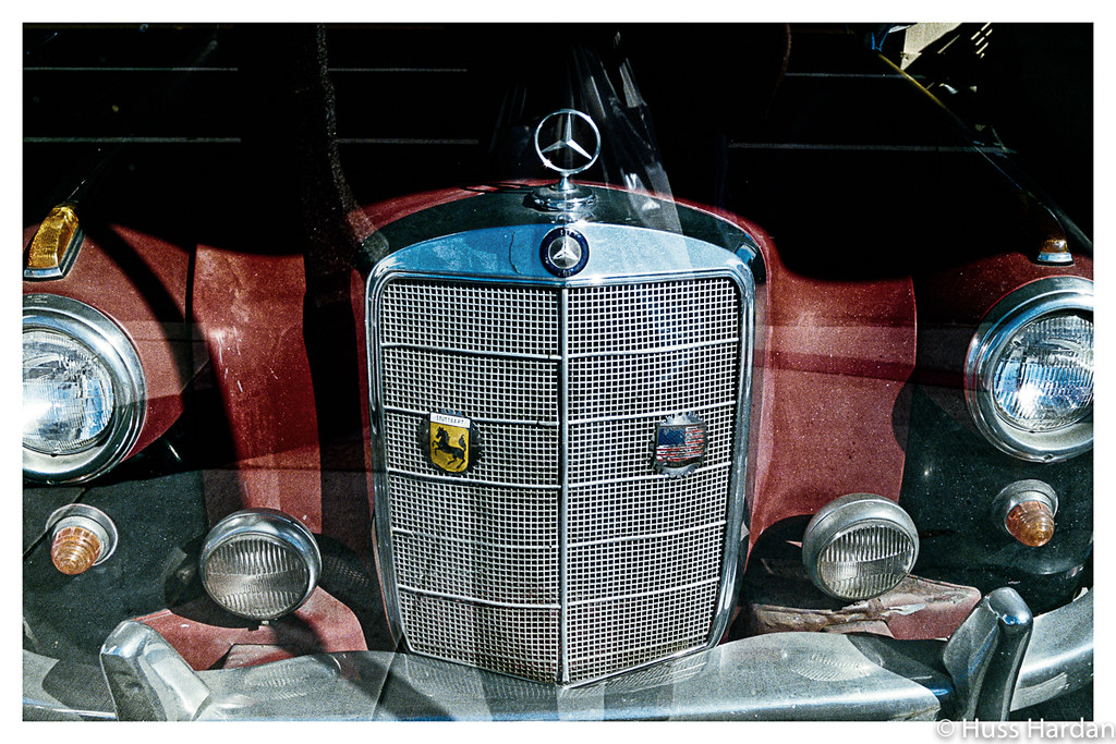

F2AS, Neptune 35mm 3.5, Fuji C200
Tom next to his super sweet Karmann Ghia
Amazing Kharman Ghia, the red, BMW? in the background is pretty too. If Canada doesn't want me I'm going to apply for a California parking permit (couldn't afford a house would have to live in my car)
Huss
Feb 11, 2016
9,068
Hermosa Beach, CA
Huss
Feb 11, 2016
9,068
Hermosa Beach, CA
I think I would rather have the nice VW. I would take the extra money and build the Karmann Ghia a nice temperature controlled garage, with natural light. Just pull up a comfy chair and hangout. :happy:
Doods who can afford the Benz, already have everything else.
:wink:
