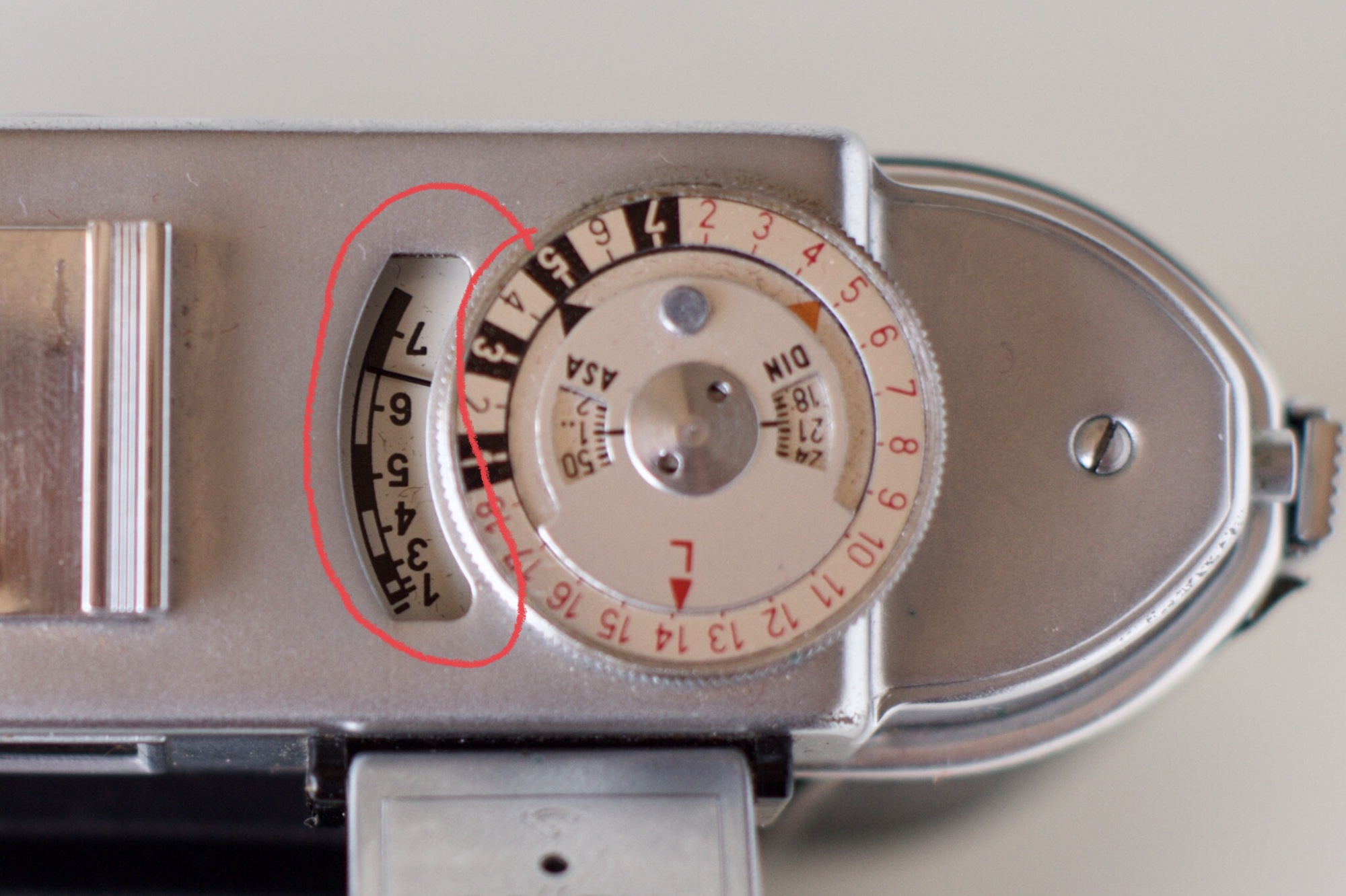

I have this beautifull old camera, a 6x6 folder and I’d love to start using it , but on the lightmeter there is no glass, or any protection. Is this normal ? Does anyone know ? I am afraid to get dirt or water inside .

Hi AgX, Sorry, I wasn’t clear enough. I mean over the needle there is no protection. And I think there should be glass ?

As said I do not know that model, but omitting a transparent cover under the top cap is beyond my imagination. Unless, the meter as such is encapsuled.
Cut a piece of undyed PET from from packaging and glue it into place at the underside of the top cap. You may consider glass too.

You'd think it would, right? If it's not going to be a big deal, I'd take the top off and see if maybe it fell inside somewheres.
