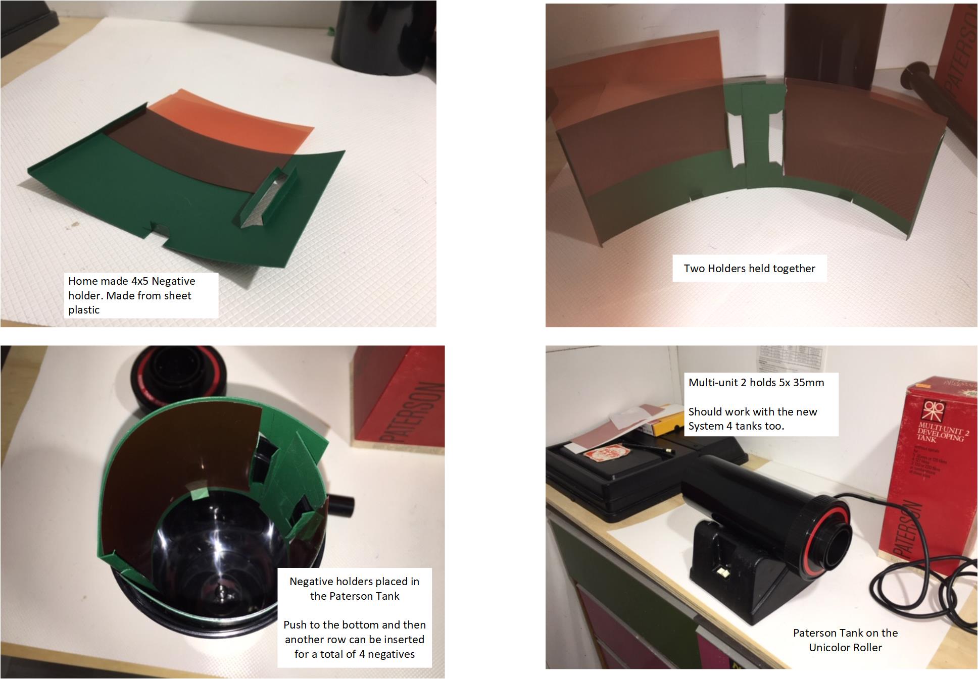

I got fed up with my Unicolor Drum leaking when I develop 4x5. I had a last disaster when all the developer leaked out in 3 minutes. I found a solution. I threw out my drums and made a handy device to convert my old Paterson tank into a roller drum.
I made negative holders out of soft plastic sheet. (I cut up an old three ring binder) With properly located folds I can place 4x5 negatives in the holders and insert them into the Paterson tank. My old Multiunit-2 two tank ($17.00 from Robinson's camera in 1975 according to the price tag) can hold 4 negatives.
100ml of developer easily covers the four negatives. don't forget the center shaft, it is the light trap.
The system never leaks, ever.
Yes, you need to put the negatives in double strength hypo clear or wash aid to clear the back side. I do this in a tray. I also fix in a tray.
I have attached an image to show how it works. Probably easier to look than read my explanation.
The best thing is, new tanks are available at B&H photo for less money than an old used Unicolour drum on fleabay.

Very nice! Look out for surge marks on the sids of the film; getting the geometry of the film holder right can sometimes be a challenge. If development is perfectly even, you are golden!

Kilgallb, well done with your ring-binder sheets.
Basically the same approach Jobo did with their reducing inserts for their older drums.
The main difference is that they went for a two-element approach, where one of the arrests can slide along the main part, thus making the insert stepless adjustable for various formats. But at a DIY approach the necessary tolerance for the slider seem hard to achieve and I thus consider your solution the better one.
A problem be would films with back layers that have to be processed too. But in such cases one just would have to make the film bulge to the center of the drum instead and heighten the bath volume substantially.
