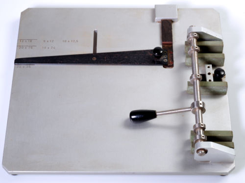

Hi,
It is only a video of see the color.
I print Carbon Cyan, Magenta and Yellow on the same provisary support.
I use a very old perfort (see picture) specially for Sheet film to obtain five repair of 1 mm of diameter
After i use the Double transfert to obtain the final color on water color paper
