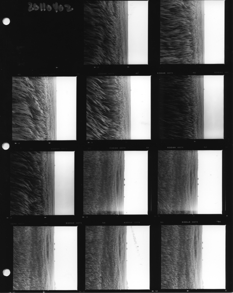

Bertil and Sander: I hope you're still monitoring this. I got sidetracked but wanted to show you a couple of frames to see if you think they show what you're talking about. I had pursued this on another thread, thinking it was light leaks in my Hasselblad 120 back. Do you think this is more likely to be the type of uneven development you're talking about? This is the contact sheet and one frame from the problem roll:
The other thread about light leaks is here: (there was a url link here which no longer exists)

Hey Jeff,
This looks like uneven development, definitely not a light leak. I've had a light leak in my Hasselblad once- it looked completely different.
In 2008, when I picked up medium format again after too long a hiatus, my first film or films (I don't remember how long the problem persisted) showed the exact same unevenness as your example photo(s). After some reading, thinking and trying I got rid of it.
There is a personal element to solving this problem (because not one workflow is the same between different people/equipment), but I can say for myself that sticking to my own rules :smile:p), as set out in my previous post in this thread, simply works. Maybe you can take these and other people's advice on this issue as a starting point for finding your own consistently successful developing method.
I am a bit puzzled as to why there isn't more talk about this issue floating around on the web. Surely many starters in 120 must run into this or some similar agitation problem. Well, maybe there is talk, but not so much a unanimous solution. This again may have to do with everybody working in their own particular way. Too many variables, in other words.
When I was confronted with this problem I was somewhat dismayed that none of the 'official' sources (Ilford, Kodak, Way Beyond Monochrome, etc.) take it on in a practical manner. If it is mentioned at all, then most sources suffice to say something like "uneven development is most likely related to improper agitation, agitate sufficiently, most importantly at the start of the process". Well, maybe it is properly dealt with (i.e. practical and in detail) somewhere. If somebody knows a good source please let us know.
It would be a pity that beginners turn away from 120 because of such a trivial problem.
I hope you get this sorted out Jeff. No need to explain to me how annoying and frustrating it can be.

Sander, thanks for posting your negs. They look like several others I have, where the unevenness is more subtle than the ones I posted above. I believe my problem has probably been developing two rolls in a two-roll tank or developing one roll in a one roll tank and taking it too easy on the agitation. With 35mm, I always have an empty reel or two on top of the tank, but not always with 120. I'll follow your advice and that of Bertil. It's odd, everyone kind of agreed on the other thread that it was light leaks, but I believe now that it's a devlpt problem.

In the other thread I myself said: "Your problem looks like a light leak from the slot but it's nice to be sure before doing a replacement of the seals."
Honestly, I don't know why I said that. It really doesn't like look like a typical Hasselblad dark slide slot light leak at all, but every bit the result of uneven development due to (probably) stuffing too much film and solution in too little tank volume.
I may be wrong again though.

A Hasselblad back light leak will occur when the bright source [usually the Sun] is to the left. The light crosses the back and exposes the film on the right side of the camera. Since the photograph image is inverted, the left side of the slide or print has the light flare.
