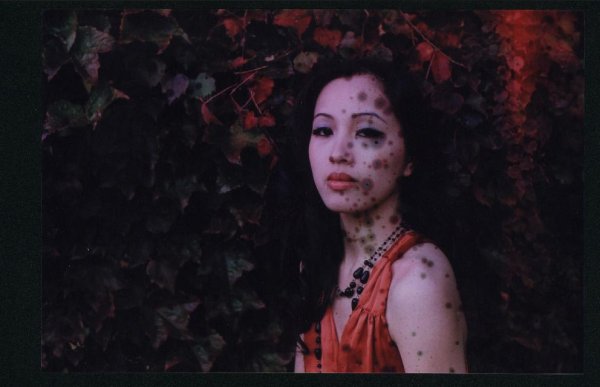

My first gothic/alternative shoot or have you had this happen to your film?

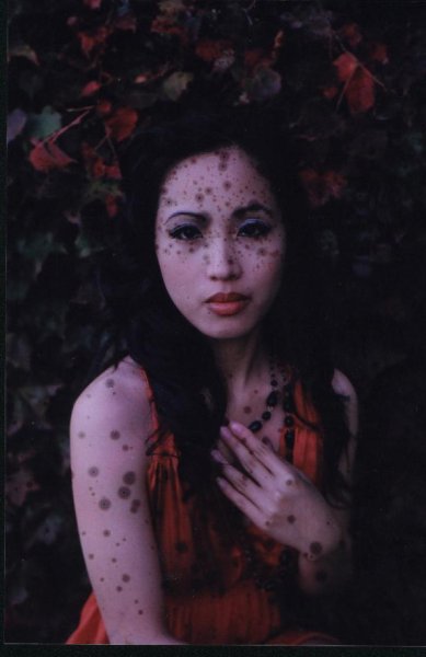

I don't know if it's the lab to blame or is something wrong with the film. I'm 90% sure it's the film, because the lab can't just spray something on the negatives this consistently.
Here's what I got. I think it adds a nice "undead" aspect to portrait photography. lol
Maybe leprocy.
What do you think this is?

How old is the film? Was it stored in a humid environment? It looks like it could be fungus.

I agree with E86 - it looks like some kind of critter is munching on the gelatin.

Has some kind of oil found its way onto the film or paper? Perhaps like spray from a can of WD-40 or similar lubricant?

Ouch! It looks like mold to me, too.

i kind of like it ... she looks like alt/goth meets battlestar galactica!

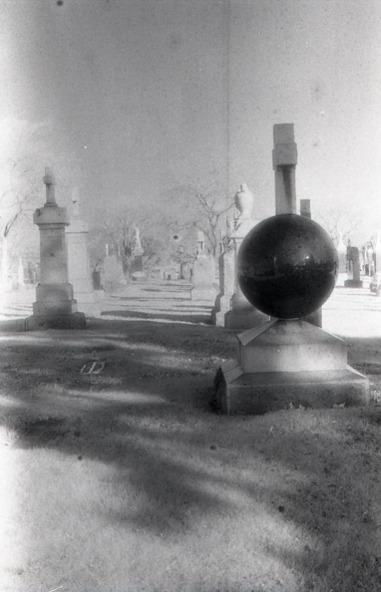

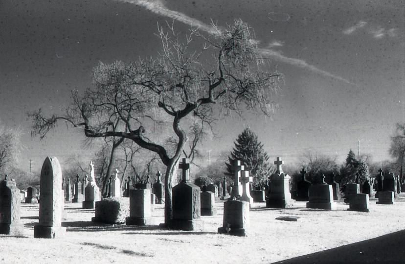

I had the same issue with 2 rolls of Kodak Hie. Both rolls were bought from Freestyle 2 years ago and i blame Freestyle for the way the film was stored.

The usual questions... Is this a print? Is it on the negative? What do the negatives look like? How did *you* store the film while it was in your possession? What have the local weather conditions been like if you've mailed the film out? More detail might help us out rather than just reading your complaints.

It's all over the negative, spread out evenly.
I borrowed the camera to by friend , which he returned with a half finished roll. I just assumed the film is good, but when I called him up after getting these results he said he got it:
1) a couple of years ago
2) at walmart
3) didn't store it properly
So, I can't really blame the lab. :smile: Probably fungus got it.

Well even a couple years ago at walmart and "not stored properly" I'm still confused how you could get that on a negative. I have lots of "not stored properly" (not refridgerated) colour negative film, cheap storebrand stuff and all that jazz, and I've never seen a film spontaneously develop spots like that. I'd take it back to the lab and ask them if they've had any other people come in with similar on their negs from them.

I looked trough a variety of images of faults on films to be found and commented on in literature.
I did not find anything resembling these. As they show a well defined dark spot in a larger homogeneous spot of lesser density.
The photo by KPT does not show these small inner spots.

Have you ever seen the way Freestyle stores their film? No? Then I would direct the "blame" elsewhere.
I thought the evidenced opinion on Photo.net when someone (you??? IR photos shot in a graveyard with the same spots and same attitude) posted about this last Nov. was that they were air bubbles or something on the film. http://photo.net/black-and-white-photo-film-processing-forum/00NTdo. There is even a similar example photo from a textbook that some nice fellow posted for you.
At any rate, knowing exactly how Freestyle stores their film, I can assure you it is not because of the way Freestyle stored the film...so please come off it.
How about these gems of wisdom posted in that post:
"I dont keep any of my film cool i have it all stored in my entertainment center. Should i freeze the film or should i keep it cold in the fridge ?"
"Im a begginer and dont follow proper developing rules or conditions but all the rolls i have developed came out nice."
I don't know...sounds to me like Freestyle is to blame for their storage of the film......:rolleyes:

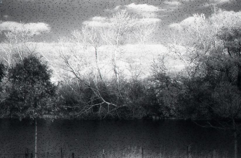

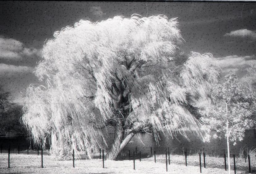

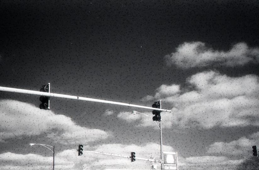

Here are 5 more shots from the 2 rolls. These are not air bubbles! If Freestyle had the great quaility control as you seem to think then they wouldnt sell Efke! Efke sheet film with missing emulsion spots, 35mm with improper dx coding or no coding on the 35mm but they dont care! they keep selling it. Im not trying to bash Freestyle but you seem to think they are god and can do no wrong. Even with my limited experience, as you seem to state! i can clearly see that these issues are not air bubbles and not from me placing the film on a shelf in my entertainment center for 30 days. I dont live in the Amazon jungle!

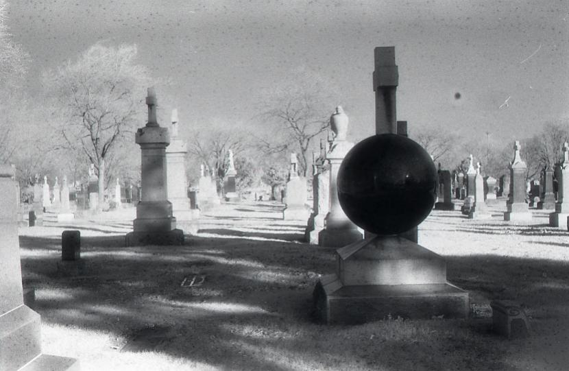

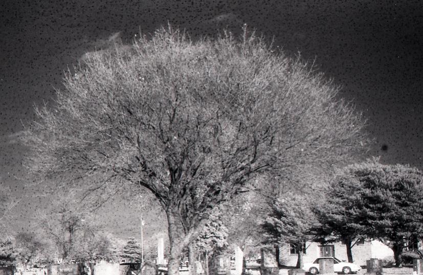

The last 2
Agx, Some of mine do have the inner spot also. One of the rolls were filled with the spots and the other roll had a lesser amount. Here is one with the inners spot.
