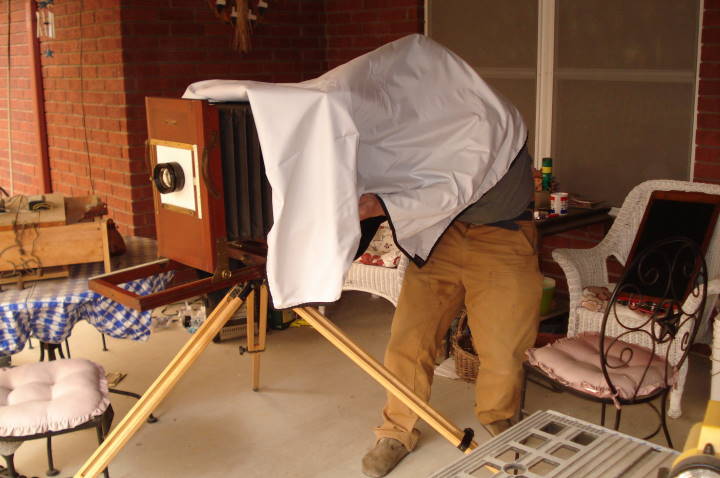

Not only is this a BIG camera, it is also a very "pretty" camera. By that, I mean it is really nice shape and as the fit/finish of the folks that made them leave me in awe.
Here are a few digi-snaps of Matt and the camera (if these need to be removed by the moderators, please do)

Of course, to buy film for the thing, Matt has had to give up his apartment and move in under that bridge. :rolleyes: :D

Matt is looking pretty happy there. I bet you couldnt pry that smile off his face.
Now you've done it Matt! :wink: Where will this madness end?
