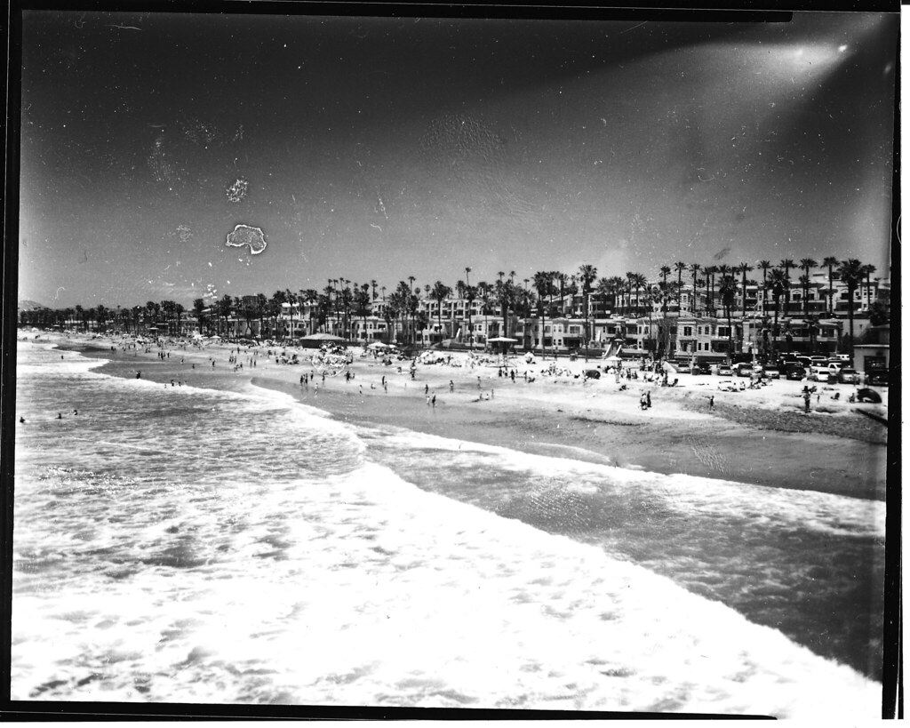

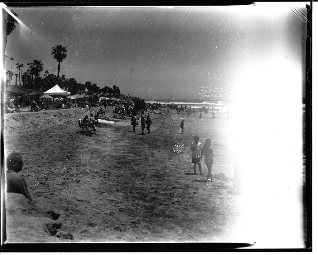

Well I went out today with my speed graphic for the first time. I went down to the beach since I knew it was going to be packed and I figured I would bring my camera to test it out. I decided to focus three photos on the ground glass and take three photos using the rangefinder and shooting it handheld.
I have just developed my negatives and I notice there is some strange stuff going on with some of them. As soon as they are dry I am going to contact print them and scan the prints to put them up here. I think it might be from light leaks of the film holders but I am not sure as I am kind of new to using film holders.

Here are the three photos that were messed up. Pardon my dirty scanner as I normally don't scan photos. But I have adjusted the curves a bit to make it more pronounced as to what is wrong.

DEFINITE light leaks in the bottom two.

The bottom two have light leaks into the image, and the top has them just on the edges. The bottom one looks like it was not seated properly into the back. This is either operator error or a warped holder. They all look like they have development issues, especially the first one. I have never had the best results doing multiple sheets at once in the same tray. If you want to tray process multiple sheets at once, I would make or purchase a tray insert that holds the sheets separate from each other. (Some people call these "sloshers," though I don't understand the term.) I have made mine out of strawberry baskets, but there are pre-made plastic ones as well.
