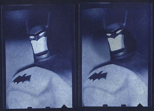

That's right, I said spit. From my mouth.
Michael Slade invited me to come over and print with his plate burner, so last night I went over and made some prints with his help. We were getting bleached prints and called Robert Hall to see what was going on. He asked some questions and told me my acid free paper and the Utah alkaline water was the problem and I should be using acid full paper.
The perfect example of this is the circle on the right Batman's face. This is from using my spit to keep the paper stuck to sheet of glass while I coated it. I guess my spit is acidic enough to change the paper. The tones on this spot are wonderful and really drove the lesson home.
I have most of the prints I made last night in the experimental gallery if anyone would like to comment. I learned a great deal and I had a lot of fun, which is good because this is why I do photography. To have fun and maybe annoy my wife :smile:

The tones on the Batman print were really wonderful, it's too bad that the computer screen ruins most photography. :sad:
The 'acid test' as MT called it, was really surprizing. I had no idea that acid would or even could affect the print at all. The tonal difference was very striking.
I am going to look into different papers now and find out which ones have a good hefty acid content...if we're going to be forced to live in Utah where the water is so hard, we'll have to adjust our papers perhaps to cope with it.
Robert, maybe you can chime in here as our local long-time resident expert. What papers are you using that work well with the water? Inquiring minds want to know.
You can acidify buffered papers for various alternative processes very easily. Depending on the paper, usually a 5 to 10 minute soak in a solution of 2% oxalic acid will do the job. Procedure: soak, hang to dry, then print. Don't rinse or wash after the acid treatment.

There are several acids that would work. Many available locally as well as artcraft or the Formulary.
Sodium carbonate is the real killer. Many of the "Art" papers are buffered. It also seems that the more buffering they put in the paper, the more they charge. So it could be cheap paper for Cyanotypes is the way to go.
I use Arches and Fabriano. We can search the archives of the alt list and find a number of papers to try.
Locally (to Salt Lake) we can find papers at Reuels Art and Frame. I buy from Daniel Smith and Dick Blick.
If we start with the right paper, we can save ourselves much pain and suffering. I don't worry about the water too much, I soften and filter it, my ph is about 7.4 in West Jordan. I'm sure it will change once the new house is done in Lehi.
Cyanotypes can be done on fabrics as well. In fact there was a company that sold sheets for beds and the like that one could do for kids and crafts. Loads of fun.

Look in your yellow pages under chemical suppliers. I get mine locally (n. Calif) at a chemical supply place that carries pool chems and other common things. It's dirt cheap and easy to use. It's also handy for adjusting the pH of potassium oxalate developer if you get into pt/pd printing. I also add it to my ferric oxalte for pt/pd printing. There is no pain in this quick and easy pre-treatment step. I mostly print with gum over pt/pd, so I need papers that work well with both processes and are dimensionally stable. I can't just go try another paper assuming it's going to work - most of them don't, for one reason or another.
