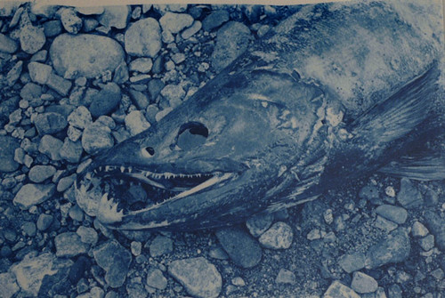

today i did my first cyanotype.
turned out very good. Didnt have any problems. It took 25mins in the sunlight. could have gone for 40mins for some more density. the print looks alot better than this digital photograph of it.

Con gratulations. Looks good though it smells a bit of.......... :smile:
Which size is it, is it the Wares cyantype formula or traditional, kit or mixed yourself, and and...?

Nice one! The dead fish works well in blue. Do some more and put them in the Experimental Gallery. One can never get enough of well made cyanotypes. I think, at least... :D
EDIT: I realized you aren't a subscriber, but well... keep them coming anyways. :smile:

I like it! It turned out much better than my first attempt. I'm also glad to see that I'm not the only one using ye olde sun for exposures. I was beginning to think that everyone had some sort of indoor UV device but me.

I like it too. I haven't cyanotyoped for a decade or so, but my color with traditional formula was always more "brilliant" blue. Did you do anything special to get the deeper blue that you have in this image? I like it!

One tip i heard the other day about using the sun to develop your cyanotype is that using direct sunlight you get less contrast in the print and you get more contrast on an overcast day.

I been making sun exposures recently and it seems that 40 minutes is much to long an exposure. I find that 6 minutes should be about max for bright sun. 40 minutes is hard to believe!
It depends on where you live. Vancouver is quite a bit North. 6 minutes is more like my experience for summer printing in open sun where I live. There are tables in almost all of the old (early 20th century and before) photo books that give sun-exposure time corrections for time of day and latitudes.

yeah i saw that long exposure time and thought "where's he from?" mine are typically 4 to 6 minutes. but hey, vancouver's up by the north pole, isn't it? probably hardly any sun at all this time of year. one good thing about sunny southern california i guess. :smile:

Anywhere from three minutes to three hours is my experience, from even farther north. All depending on time of year and haze levels and whatnot.
