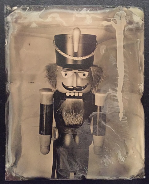

Plate #2 - F11 - 90 seconds exposure at above mentioned setup (at half of exposure one of the bulbs decided to stop
). Count to 20 for development. I can see exposure was not enough.
- What and why is the line on the right (gray one)?
- What and why is the shape below that line (like unfixed shapes on midlle right, on arm and hand)?
I think many faults are because of putting into silver tray too fast, and not managing to pour developer properly.

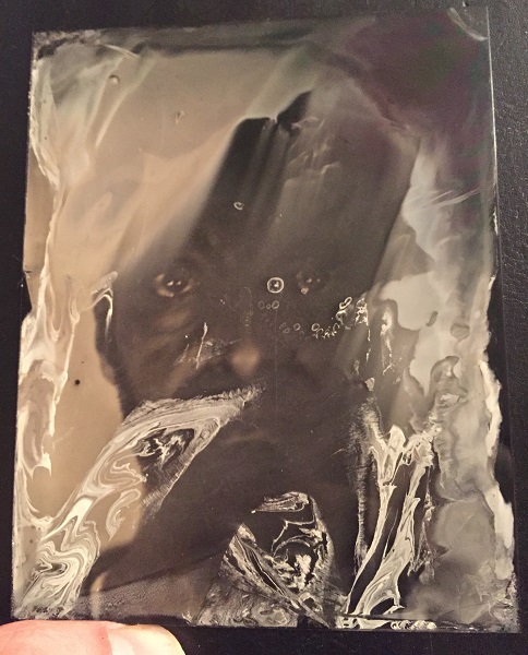

Plate #3 - F8 - 60 seconds exposure, count to 20 for deelopment. Self Portrait trial, not enough exposure... Normally this is not worth to share but I wonder what are these fault patterns and how can I avoid, I see four different pattern.
- Top Left, milky coffee coloured area no image
- Top right, fully black (not developed?) area
- Right and bottom right cloudy thing (this one shows itself on other plates as well)
- Bottom and left, milk just added and being mixed to coffee effect but image shows in between.

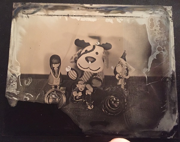

Plate #4 - F11 - 135 seconds exposure (seems like better exposure time). Similar defects with other two but as addition:
- Line and different right side (starting from Santa Clause) is it hesitation mark while putting it to silver?
- Left bottom corner, probably I could not pour developer there.
