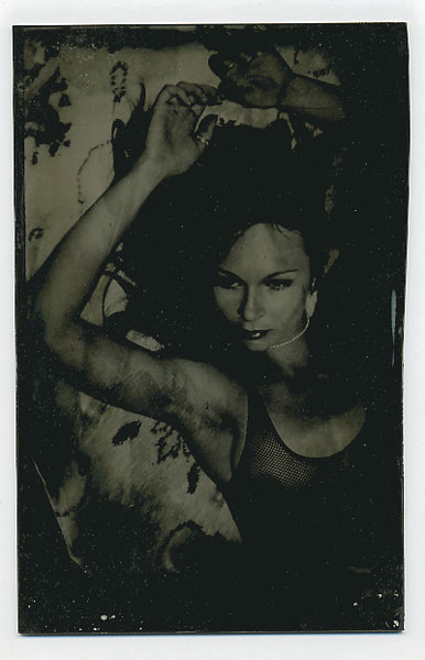

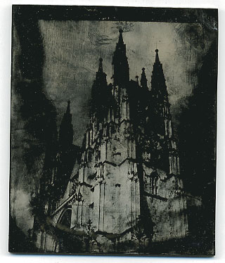

OK folks, here's two of the five plates. Comments and critiques welcome.
Regards, Art.
