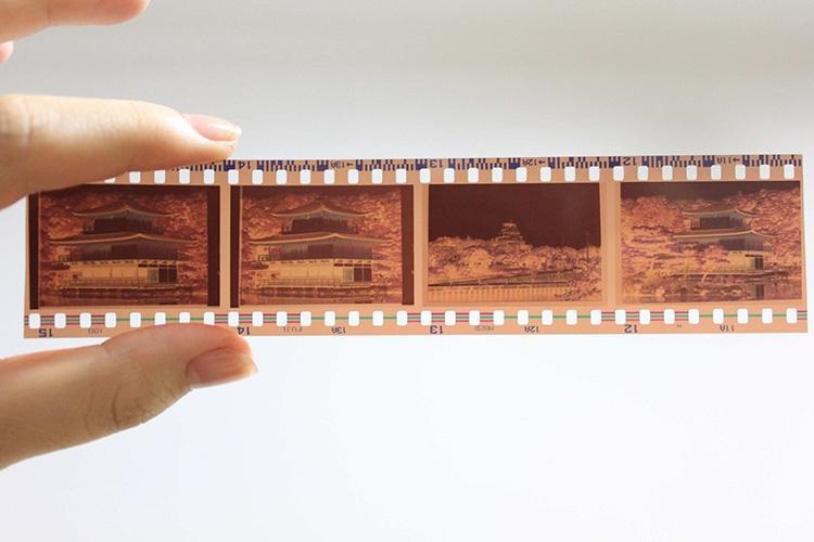

foc
Jun 30, 2010
2,523
Sligo, Ireland
As @bdial suggested, please post an image of the negative strip (the ones in your link), something like this:
