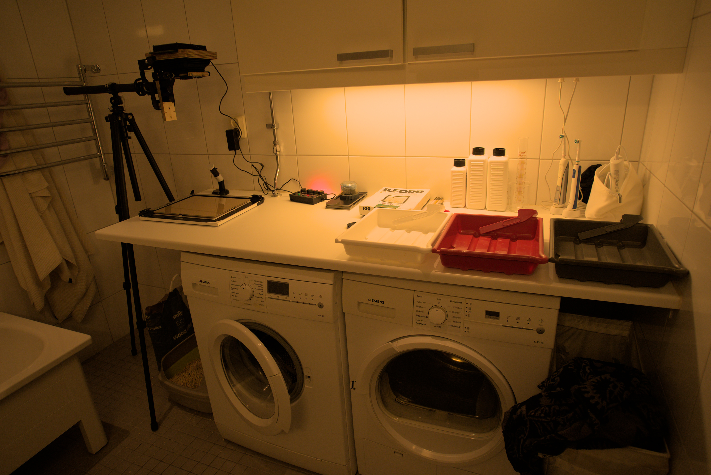

I was once very spoiled: I lived a short drive from my parents' house, they had a spare bedroom and bathroom larger than my current apartment, and professional photographers were unloading their darkrooms for $0.10/pound. Alas, I could not bring any of my enlargers or print processors with me when I moved across the ocean, and suddenly storage space was a *very big* issue. For the past decade I've been dreaming about getting back to printing, but it just wasn't practical.
I noticed this Intrepid thing a few years ago, and it seemed like a possible solution. I have strict requirements: my darkroom has to be in a bathroom shared with another human and a cat, cannot be setup permanently (or even overnight), and must be able to be completely stored away in a small closet. I needed something I could setup, use, teardown, and tuck away in a bookshelf. After three years of eyeing the thing, I finally decided to go for it... it was ten times the price of just buying a used Durst locally, but the storage problems dominated over the financials. Plus, I get to try out 4x5! Nice.

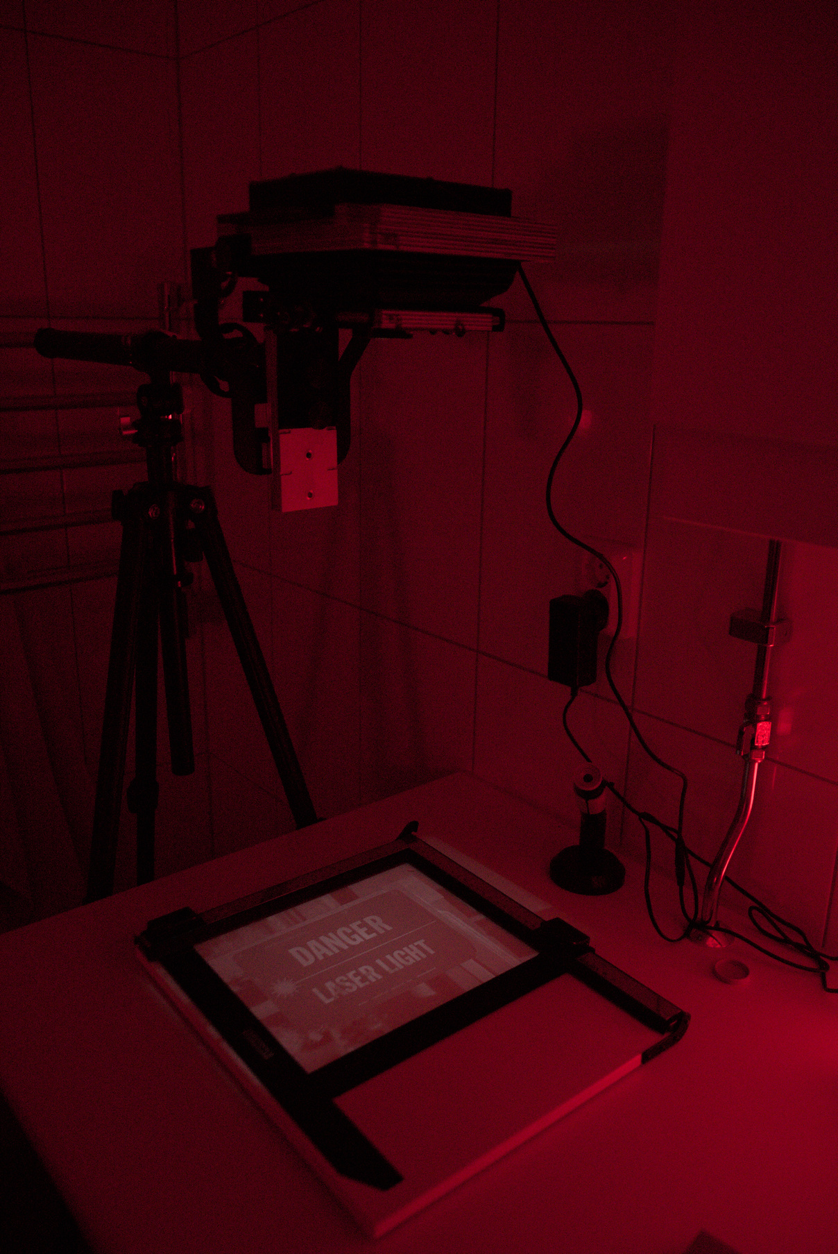

Getting the "enlarger head" (that's a giant 4x5 camera) above the projection surface... their cute little advertisements show it on a tripod with the legs sprawled out on the enlarging table. Ok, well my tripod legs sprawl right off of the edge of the only flat surface in my bathroom, and that is not going to work. Even if the table were deeper, my tripod's center post is not a meter long, so enlarging 35mm to 8x10 with a 105mm lens isn't an option. Plus, I have shelves over most of my counter, which limits where the tripod could even go. So it's time to start thinking about how to hold this thing up, and here are the options I considered:
1) Unextended tripod awkwardly sprawled on the table, trying to avoid projecting across its legs. Vertical changes are easy, but limited to the height of the center post.
2) Tripod on the floor next to the table. You get full tripod height, but... it's a pyramid. The higher it goes, the farther it pulls away from the table edge. So you need to have different lengths for the legs to bring it closer to the table, and any height changes require changing all three legs. The center post now moves diagonally. Vertical changes are a complete pain.
3) Buy a tripod with a center post that can pivot to horizontal. You get the full leg height, and can hold the camera horizontally over the table. The center post loses all vertical movement, so that has to be done by changing all three legs. The leg height probably isn't enough.
4) Same as 3 (horizontal tripod post), but stick a macro rail at the end to get a little bit of controlled vertical movement. But most macro rails aren't long enough to make this worthwhile.
5) Buy a copy stand; perfect vertical control. But I could only find copy stands that are ~75cm tall, and they are shockingly expensive, and they don't store well in my closet.
6) Buy a "tripod boom arm". This is so late down the list because I didn't know they existed, but of course this is what to do. The tripod is setup with equal-length legs, it keeps its vertical center post for easy vertical adjustments, and you add a horizontal boom arm sticking out over the table. Counter-balance the boom arm with a backpack full of books, and hope that nothing snaps in half.
I went for #6, and found a reasonably priced boom arm from a Chinese brand which seems to be of pretty nice quality. Of course, we are talking about a fully extended tripod with a far-extended boom arm and 2kg of camera hanging from it... the vibrations, man, the vibrations! You can imagine the scene of your beautifully projected image bouncing up and down like a child on a trampoline. And this was absolutely my fear, but, in practice, it turns out to not be that bad. It certainly shakes and vibrates every time you touch it, but it settles after a few seconds. When making a print, I just make sure not to touch *anything* for 10 seconds before flipping on the light. If you like to dance while your exposure is in progress, you might have some problems with this setup. Sand bags might help.
Alignment was another concern; I figured I would have to spend 45 minutes squaring the thing every time I set it up. Weirdly enough, this turned out to not be a problem at all. I just eyeball it, and it seems fine. I always check the grain focus in the center and all four corners before making a print to make sure nothing is wildly off. If you want it more accurate, you can use graph paper or a cutting mat with a grid to align it precisely. Your accuracy and stability will be limited by your tripod head; I'm using a fairly cheap ball-head, which surprisingly doesn't drift under the weight of the camera, but is very difficult to make small adjustments. A geared head would be much better.

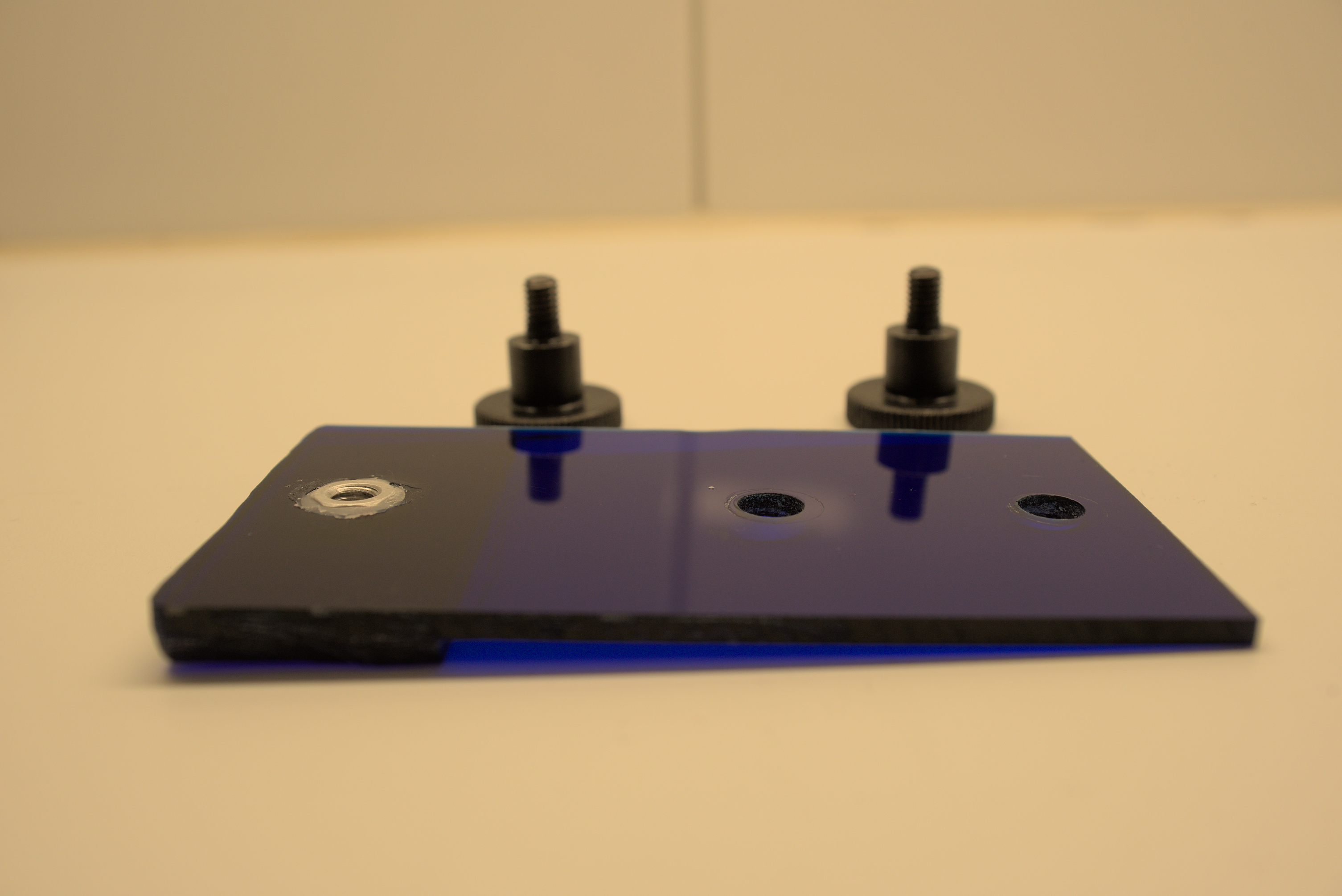

The negative carriers are... less than perfect. They're just two long wooden boards taped together, which slide into the light source housing. Their length makes it difficult to work with short strips (I think single frames would be impossible). There are no alignment tabs. And, worst of all, if your negative strip is too long it will extend out of the carrier and cross the very rough edge of the camera's wooden frame and get scratched to oblivion. You have to be *very* careful when loading a long negative strip, and might have to unmount the light source to do it somewhat safely. The carriers do not have glass, so you may struggle with curved negatives.
The "run" button (which exposes for your chosen time), the "focus" button (which turns it on for 60 seconds), and the "reduce time" button are right next to each other and look and feel the same. I hit the wrong one sometimes, which is quite annoying... especially when I hit "focus" instead of "run" and ruin the print.
In my first printing session, I had trouble with the top third of my images being very underexposed. It wasn't light falloff in the corners, but clearly only affected one side. That hasn't happened since, and in retrospect I believe it was caused by my lack of familiarity with the 4x5 camera it's mounted to. The front standard has significant "fall" when first unfolded, and I'm guessing that I locked it in too low and got uneven illumination. You have to be careful to make sure the camera is perfectly squared.
