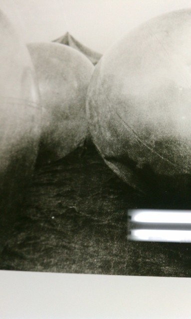

I'm just checking in with my regularly scheduled lith issues :smile:
I'm getting these lighter toned streaks running up the portrait orientation of my Foma 111 16x20 paper. I used this paper before in 11x14 without this happening, although at that time I was using LD-20 developer and now I have the Moersch stuff.
I tried agitating the opposite direction of the streaks to no avail. My only suspicion is that they are some kind of mark showing up from when the paper was coated. I should mention that I've used this same package of paper for straight printing and there was no hint of streaks.
So, any ideas? Chalk it up to bad paper and call it a day? Or is there a wildcard I may be overlooking?
Technical details: Fomabrom 111, Moersch A+B 1+1+18 (yes, it's strong!)

I've seen this on various papers in lith - Foma 123, Foma 112, Varycon, Slavich. Sometimes it happens, sometimes not. I suspect it is something to do with the paper coating, you would never see it in regular printing and it's not a coating defect.

to quote Tim Rudman ..."Lith has a way of showing up emulsion flaws that regular processing 'to completion' does not show."

Looks like the paper to me. I've never had the problem with Foma, but I've seem much worse with Slavich. Freestyle has a liberal return policy if that is where you purchased it....or just use it for extra character!

You could try adding some restrainer to the developer, potassium bromide or sodium sulfite. Or dilute the developer.

I have had the same thing! Can't remember but think it was with the Slavich paper. I was too eager to bring them home from my darkroom and transported them still wet in a plastic bag on the bus for an hour and a half...
Most of the Lith prints had the same kind of streaks that shows in yours and I ended up chucking them. I will not do that stupid mistake again!

I'm not sure exactly what defect you are referring to in the images. Perhaps you could add an arrow pointing it out.
In any event, I used to get irregular banding when I would develop lith film or anything needing extended development time in trays with troughs or ribs in the base. I switched to flat-bottomed Cesco trays and the problems went away.

It's a paper coating issue. I've had it happen with Fotokemika Emaks, Fotokemika Varycon, Foma 132, and Kentmere Kentona.
Lith has a tendency to reveal defects in the paper that simply doesn't show up with regular chemistry, for various reasons I am unfamiliar with. What's particularly difficult is that it isn't consistent from batch to batch, unless you use something like Ilford Warmtone, in which case it'll be consistently good without such artifacts.
Good luck in sorting it out!
