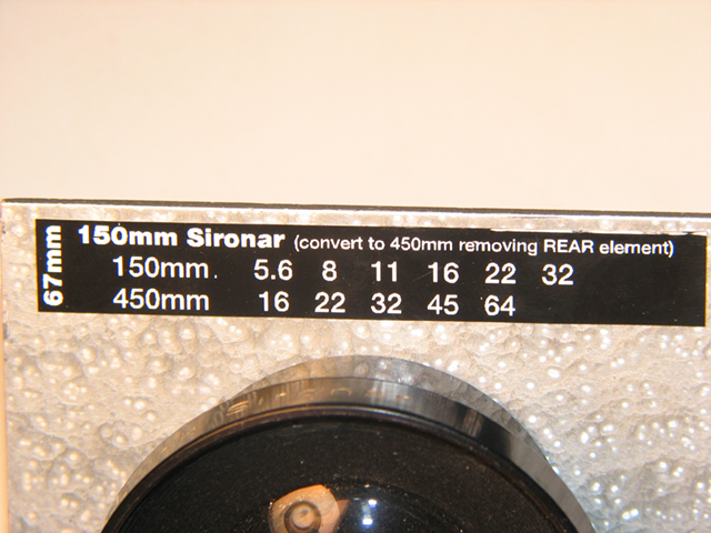

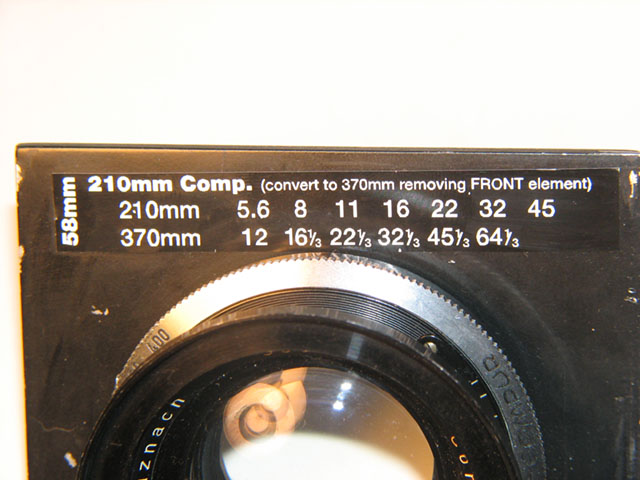

I'm the first to admit that if I don't carry around little notes, I forget things. I came up with these labels that I put on nearly every lensboard (on the side, with the filtersize upward) now, and it saves me tons of time. I no longer have to either rmember which adapter to use with which lens, or what the converted aperture is on my Sironar, Componon or other lenses that just scream "try me converted, go ahead"
Does anybody else need something like these? I can make them cheap enough that it wouldn't be much more than a buck for a few of them?

I find that remembering the focal length and f stops for each lens gets troublesome, so the other night I finally printed some of these labels up, and thought I'd share the idea. So far, it's saved me at least 5 mins looking for an adapter ring today alone.
