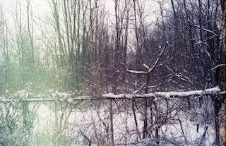

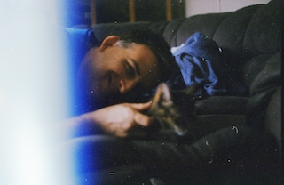

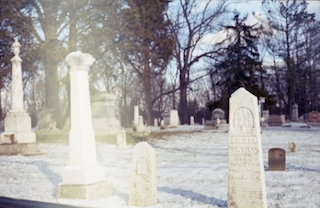

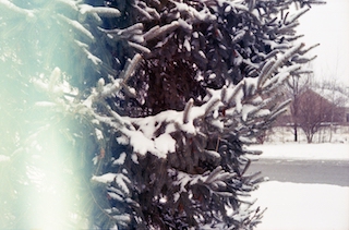

I am trying out a new C-41 kit. I switched from Uni to Rollei's kit. Aside from it being a bit more expensive, I like it better overall. I like the look of most of the negatives and the way the colors are turning out. However, on this second roll of development, and also on the third, I am beginning to get light streaks on random shots.
These were done with two different 35mm cameras and two different film stocks. I finished scanning in one already, and I am working on the other, the light streaks appear similar. Since they were in 2 different cameras, I am assuming it is my developing technique. Can someone give me some pointers as to what I did. Here is my developing routine for both rolls:
Used dark changing bag to roll onto my hand development tank. A Jobo. Only develop one 35mm roll at a time even though I can do two.
Chemistry: Rollei C-41 1l developer/Blix/Stabilizer. Mixed 2 days ago and stored in plastic bottles with oxygen squeezed out.
All 3 heated to 38 degrees C
1. Wash in water for 3:30 at 38 degrees C
2. Moment temperature in developer bottle drops to 38, I pour into tank. Set timer for 3:15. Rotate/agitate continuously for first 30 seconds, then for 10 seconds every additional 30 seconds. Hit the tank on the ground to knock off bubbles after every cycle.
3. Clear out Developer, add Blix. Set timer for 6:00. Same agitate/rotate sequence as with developer.
4. Clear out Blix. Wash at 38 degrees C for 3:15. Just fill, shake, pour out, repeat until timer ends.
5. Add stabilizer. Let sit for 2 minutes after a 10 second shake.
6. Pour out. Final Rinse, add a bit of photo flo and expose to light.
And these are my results. The light streak discoloration goes from subtle to completely white. It is not every frame. And this is not "trick" film. Would appreciate any insights. I am really enjoying doing home developing, but I can't seem to find the solution.

Light leak. Could be:
- during developing (tank not 100% light tight or lid loose/not properly fitted), or
- when loading the film on the reel, or
- accidental opening of the camera while film was loaded.

Can we see the negatives please - including the edges?

Without looking at the negatives, I would suspect a tank light leak.

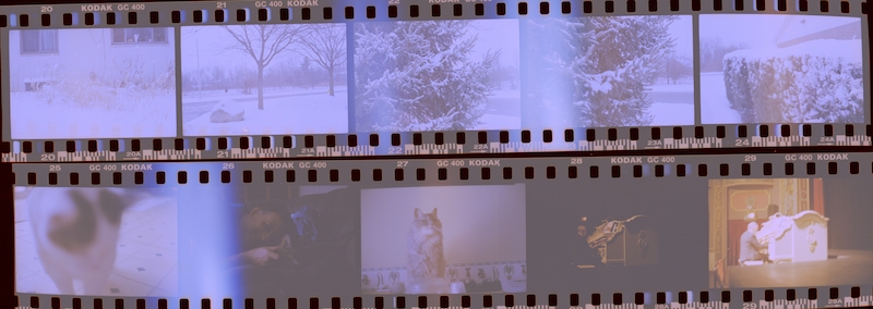

Sorry for the delay. I had no idea it would be so difficult to get scans of the negatives with the sprockets left in them :smile:
Had to use a different scanning program to do it. I didn't take the time to color correct, unfortunately, but it should clearly show 2 full strips of the negative from edge to edge. This is two different strips from both the beginning and end of the roll.
Let me know if it will help for me to fix the colors and I'll rescan. Thanks for your help.

The fogging goes across the frames. There is a light leak in the camera, cassette, or tank.

I would assume since this is from two different cameras, that it means my tank somehow has a light leak. I guess I had better replace it.

Thanks for your efforts, but I was asking for a digital photograph that shows what your negatives look like, not an inverted scan.
Any time you add scanning equipment and software into the mix, it becomes difficult to tell where problems are arising from.
The image you posted tells us that problems go right across the film - including the sprockets and rebate.
While it looks like it is a problem with light leaks, it might also be a problem with incomplete and uneven fixing - the scan makes it hard to tell.
With a digital shot of the negatives - preferably both front and back - it will be easier to help.

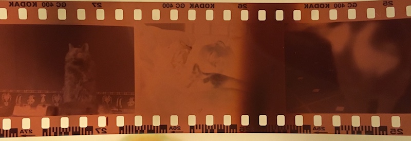

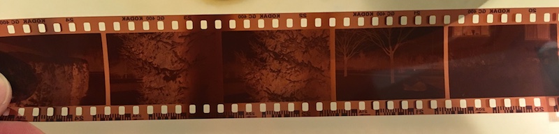

My apologies. I did not understand. Thank you for the clarification. Let me know if this is more helpful.
Thanks.
Apr 2, 2017
639
Yes, a light leak for sure. Likely happening when the film is spooled, which can be in the developing tank (on the reel) or in the camera before being rewound.
There could have been light in the room/space the film was removed from the cassette and loaded onto the reel.
The tank could have a crack (but it would leak and you would notice this), or the lid may have been accidentally slightly opened.
The camera back may have been accidentally opened.
Which of these do you think it is/was?

White reels due to their opacity should give a some density difference at the rebates (I assume), I do not see such.

Lightsruck film on a reel would not have such narrow bands especially considering the spacing of the bands. This looks like it happened while on the cassette spool, whether in camera, through the felt trap or during loading in the darkroom is difficult to say. Felt trap leaks are generally more narrow than these bands so this is less likely. I think you would remember opening the camera back and the results of that are way more drastic than what I see here. Have you checked your changing bag for loose elastic or defective zipper seals? Also was the room you were in brightly lit when loading?

Even without collumn there would be the milky core that would diffuse any light. If there was a gap (1 reel in a 2-reel tank), there still are those milky reels that should give some shadow.
And others pointed out that no form of light leak at a tank could produce that repetitive pattern.
