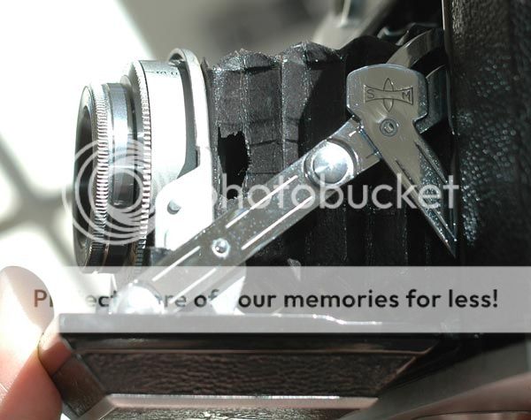

I fix bellows on a regular bases. I don't know how to rebuild bellows from scratch and some cameras can't be put back together once you destroy the rivets that hold it together (Kodak 1a, no 2, Ikontas, etc).
What I use is:
  • Liquid Stitch for large gashes. (also works great glueing leather back to metal).
  • Followed by a coat of black fabric paint. I use Tulip brand because it's everywhere.
  • Followed by a coat of mixed Elmers Facbric Glue (flexible, stretchable glue) with the black fabric paint. It'll be grey.
  • Followed by another coat of black fabric paint to cover the grey back up and to make sure there's no more light leaks.
  • An optional final coat of black fabric paint.
For polaroids I use only Elmer's Fabric glue mixed with black fabric paint. Since the bellows is synthetic you don't have to use liquid stitch.
For antique Kodak Bellows cameras, I remove the lens and use black Simply Spray Upholstery Fabric Spray. I spray the inside. These antique Kodaks can have hundreds of tiny light leaks. The upholstery spray remains soft and flexible and covers up all of the tiny annoying holes.
Using extremely thin coats and completely letting them dry prevents sticking of the paint when the camera's shut.

I wouldn't trust just paints and liquid stitch. I use a very thin repair fabric which used to be made in Holland it's designed for repairing tears in suits etc and to be invisible. The black version is light-tight, self adhesive a nd very thin & flexible, I've been able to repair large shutter curtasins with it as well, all I have left now is some dark-brown material.
For a set of badly damaged bellows on a Speed Graphic I was able to patch inside and out and it's hard to spot where the repairs are. I have a variety of different black acrylic paints for finishing from matt black to gloss, there's a lot of variation.
I've a few cameras with extremely poor or missing bellows and the best option is to make replacements. I've a 9x12 camera with bellows that are wrong (look like they've been changed)- they don't allow full extension of the lens / focus rail so they'll be changed as well.
At the camera fair I go to ocassionally one seller has a box of OEM replacement bellows for many European cameras, I'd guess these are ex Camera Bellows (now Custom Bellows) stock and are inexpensive. Camera (Custom) Bellows made/make the bellows for most manufacturers in the West, millions for Kodak alone :D

The best bellows repair material is, I reckon, 3M type 850 black polyester tape. I use the 1" wide version to repair and almost reconstruct bellows in enlargers and cameras. The tape is very thin, very black, with a strong non-bleeding, non-gooey adhesive. It is also ultraflexible and doesn't form cracks or pinholes. Maybe bellows should be made out of this stuff in the first place. Downside? Expensive!

This is how I repaired a Mamiya 6 bellows.
On the inside I glued an oversize patch cut from black gaffer tape. On the outside I applied many coats of a product called Plasti-Dip (black, of course) which I first thinned with naptha. I let each coat dry for about an hour before applying the next until it all looked fairly well blended in. Plasti-Dip is basically a liquid rubber.
I used a small paint brush to apply it and also painted it on the frayed corners of the bellows which seemed to work well at sealing and strengthening them. There were no light leaks afterward and the bellows folded normally.
