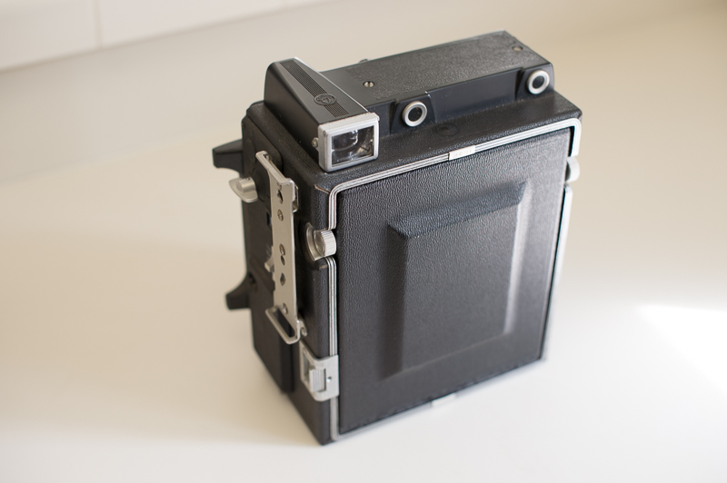

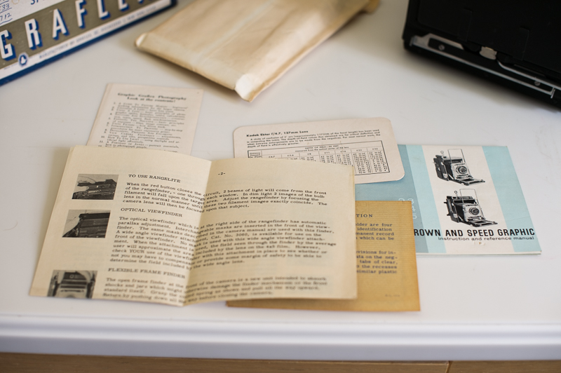

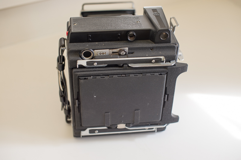

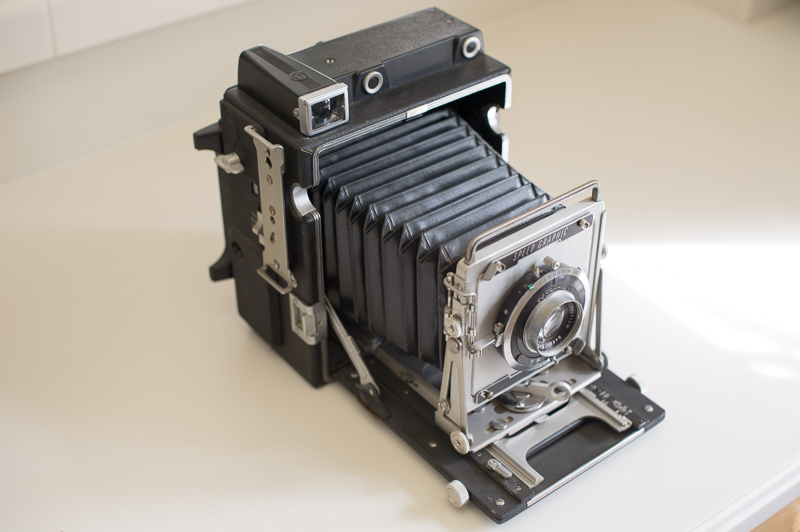

I've been looking for a Speed Graphic off and on for a few months, taking my time looking for a good one at a good price while reading and learning more about them. I've only checked Craigslist once or twice and there were never any local, just ads up in Los Angeles for them but I was poking around on eBay and a few other sites and figured I'd check CL too. I'm so glad I did, two hours before I checked someone posted an ad for one local to me listed as being nearly new in box. I contacted him immediately and we made an appointment to meet so he could show me the camera.

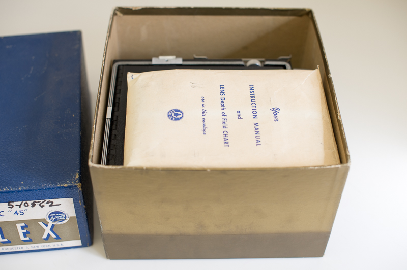

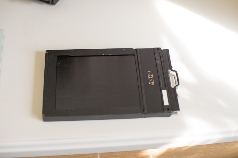

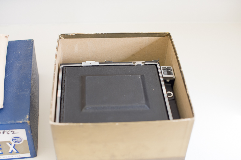

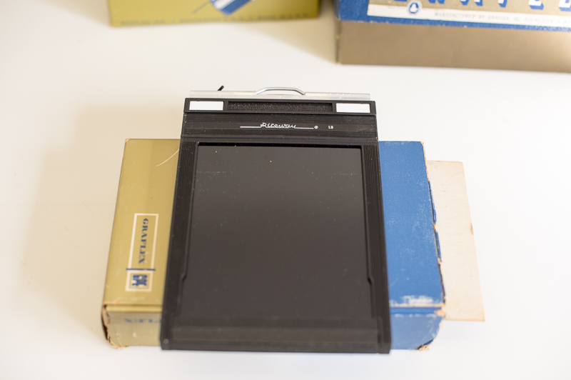

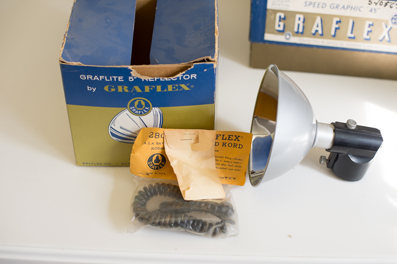

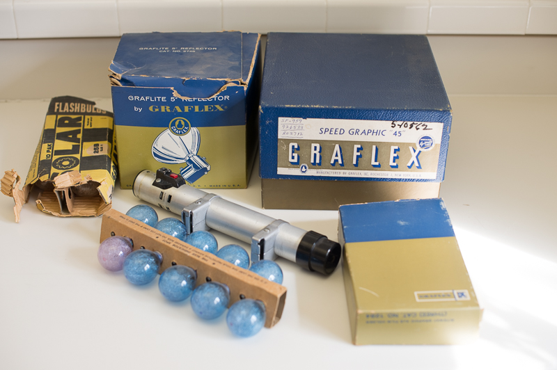

I went over to his studio this morning to take a look and there was no way I wasn't walking out with this. The Speed was in it's original box with all of the original paperwork and (for some odd reason) what looks like a brand new baby Speed film holder (this is a 4x5 SG) and came with a box of three brand new 4x5 holders, a brand new Graflite Reflector, a flash (not new) and a some bulbs (both blue and clear).

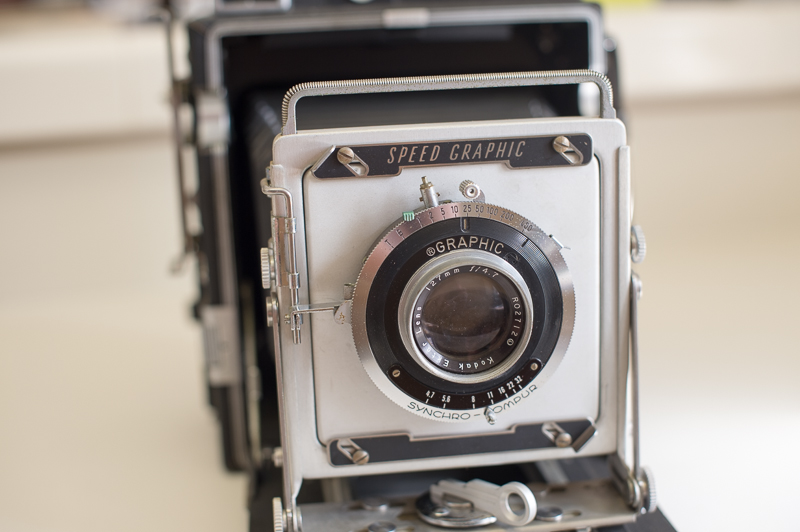

The focal plane shutter works smoothly at all speeds and looks/sounds accurate but I'll test it later. The lens is a Kodak 127mm f4.7 in a Syncro-Compur shutter, it's going to need a CLA because it's sticky in all of the slow speeds.
He said he's owned it for about 12-13 years and got it from a friend who worked at a small college. The college was cleaning out old storerooms and throwing everything away when they found a couple of boxes of photo equipment. His friend knew he was a photographer and called him and asked if he wanted any of it. He said he went over and took a look but most of it was junk except for the Speed. He only took it and the accessories here and has owned it since. It appeared to be brand new when he got it and he's never actually used it other than to unpack it and fire the shutter on the lens to see if it worked.
Sorry, not the greatest photos, I was excitedly opening and taking quick shots when I got home. I can't wait to get this out and give it a go!

I'm going to have to get it repaired, anything under 1/25 the shutter sticks open. The glass is pristine so I'll definitely have it repaired or the shutter replaced.

926533 is #3 of an order of 2200 listed to be built in late August 1957. Possibly made September to November 1957, lens is most likely original.
While the FPS may be running smoothly it would be a good idea to inject some fresh medium weight graphite grease into the hole in the center of the curtain roller bushings or remove the bushings, clean them out, lube, and reinstall them. They are the chrome things on the left (handle) side of the body, they unscrew from the body.

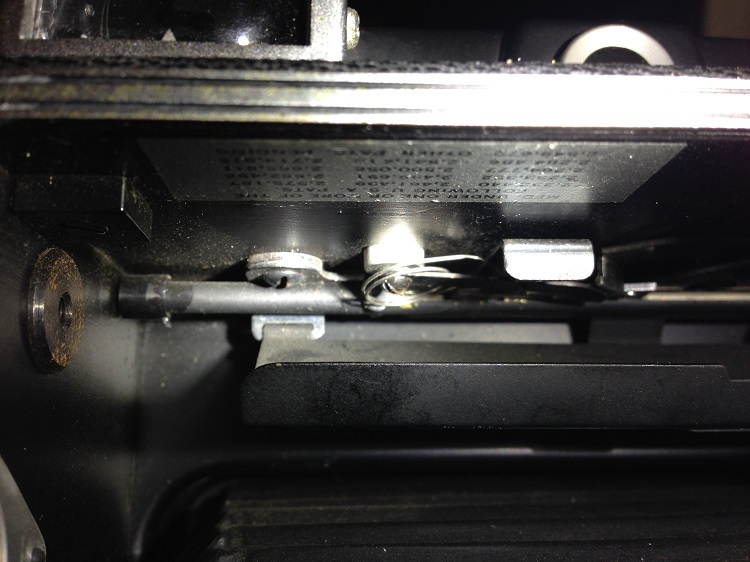

I guess the rangefinder and rangelite don't work correctly. Inside there's a small round spring that's supposed to hold the lever up against the installed cam but it came loose and is just sort of hanging there. I see the spring in the repair manual but it doesn't indicate how it's supposed to be installed, does anyone have any pointers on that?

That diagram doesn't show this spring, it only shows the one on top attached to the parallax lever. There's another spring on the inside of the camera that goes around the post attached to that same lever (the post is shown in dotted lines in that diagram) and the lower lever that is up against the "rangefinder arm" there.
This is a picture of the spring I'm talking about that has come loose:

I should add:
Its a round spring that goes around the post. One end is attached to the lower parallax lever and the other looks like it should hook onto something but it's just loose so the spring is also loose.

Spring-Rangefinder arm should connect the clip end to either the rangefinder arm or the parallax actuator. The parallax actuator should be secured to the shaft and operate the shaft. The plain end of Spring-Rangefinder arm should go between the shaft and the case or to the rear of the shaft and against the screw/washer to the immediate left of the parallax shaft.
Spring-rangefinder arm appears to be deformed suggesting it was snagged when removing a cam at some point in time.
