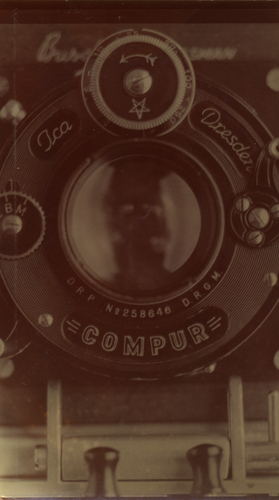

Using US Patent April 27, 1926 No. 1,582,050 by James A. Johnson I made the print below.
I used Haloid Industro expired in 1946. This is a contact paper that I have not been able to print without some fog in other developers.
Here is the formula used
Soak paper in a 3% solution of Potassium Iodide for 2 minutes.
Washed in running water for 3 minutes.
Soaked in the following mixture for 5 minutes
2% solution of Metol
8% solution Sodium Sulfite
Hung to dry in a darkroom.
After the paper has been soaked in the Iodide it will become insensitive to light even when dry. The paper will be light sensitive after soaking in the developer solution when it is dry not before.
When dry I printed in a contact printer with a 85w light bulb 2” away from the paper. I exposed the print until the paper not covered by the negative looked to be at D-max. I then washed the print in water to stop exposure.
There is a lot more information in the patent. It is easily found though Google Patents.
I’ don’t know if this would work with papers that incorporate a developer in the emulsion. But it might be worth a try. I think this could be worked a little to get a better contrast out of it. It might be that this paper is this flat and a negative with more contrast should be used.

Neat trick, and it developed out with an incandescent bulb. Did you try fixing or toning?

Had a little time to experiment. Unfortunately I missed the part in the patent that said the paper becomes red sensitive. I had 10 sheets hanging to dry with the safe light on. all but one where exposed. the one that wasn't exposed was hiding in the shadows.
Although it printed well I found out that toning will wipe the print out. I used a .2% sol. of gold toner and the print went black. Fixing the print just washed away the silver and left me with a white sheet.
Will have to try again.
