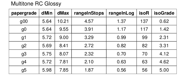

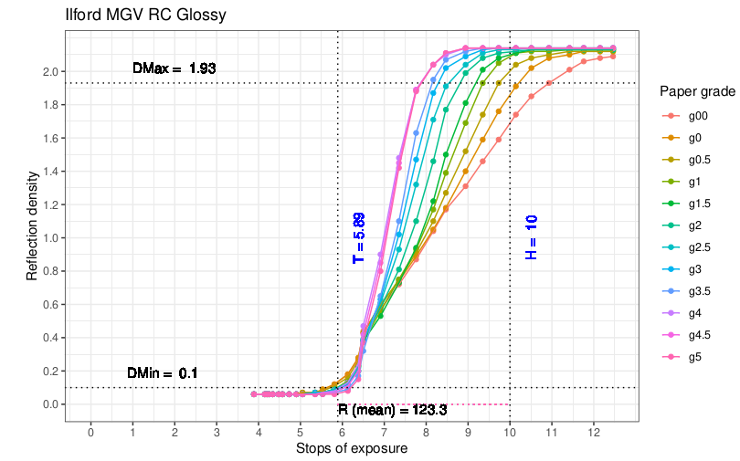

I have recently tested this paper and found it to be excellent. For example, the current Ilford MGV RC Glossy selenium toned Dmax is around 2.24 (from 2.14 untoned), whereas Multitone is 1.86 untoned and 2.16 toned . The difference between 2.16 (Multitone) and 2.24 (Ilford) is unlikely to be perceptible by most people, except maybe for some eagle-eyed photographers. I consider that to be a very good result for the least expensive paper on the market today (at least in the US).
As far as contrast, both papers span a similar range of contrast (as measured by the ISO definition) with Ilford Multigrade under the lens filters. I only tested 7 filters with Multitone, but that should be enough for a lot of people. Here are comparison tables and plots:
