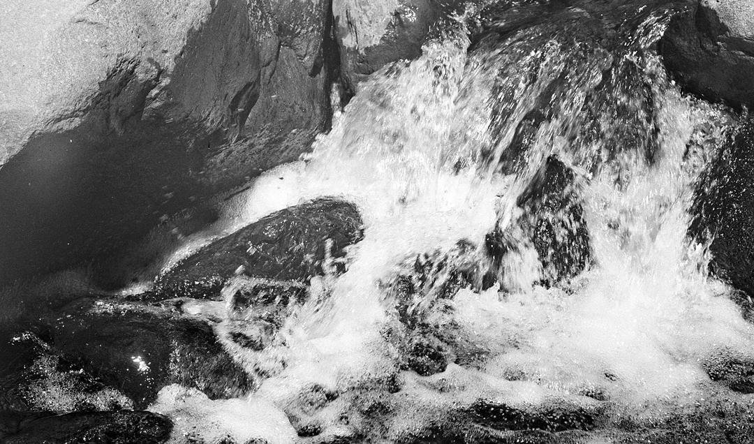

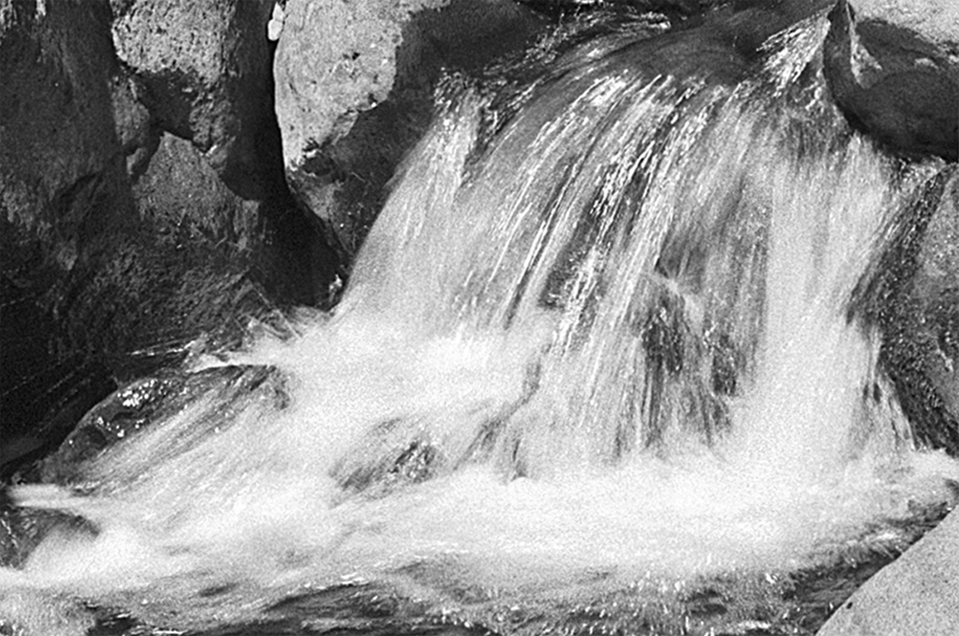

Ok, never tried this before, have shot this scene at 30th of a sec, and at 200. (See Below)
The 30th sec shot came out good, nice flowing water, and the @ 200 shot had more individual character, with its flow, but the droplets, where not stopped enough to get there 'individuality'.
Want a shot with a little more .. ah 'exuberance'. showing more individual water droplets. So thought we try a multi exposure that would perhaps do both.
So would like to shoot a three multi exposure of running creek water, using Arista 400 @ 200 sheet film, in a 2x3 Crown Graphic, on a tripod. All three shots would be of the same exact scene, only the flow of the water splashes would change.
Understand for a double exposure one would set meter ISO @100, that's one stop underexposed. and for a four multi exposures, would set ISO @50, two stops underexposed.
How does this scenario sound. Of course one can only know by trying, if it's workable, but would like to try a three multi exposure, so as we perceive it, one would set the meter ISO to 150?
Is this correct?
Meter.. gasp, .. Weston Ranger 9, yep, it works for me when we need one. :tongue:

View attachment 187663 View attachment 187664
If your "true" film speed is 200 then shooting at 100 is one stop overexposed and 50 is two stops overexposed rather than underexposed, isn't it?
You've got the meter settings backwards, as Pentaxuser said. You'd need to do two exposures at 400, or four at 800. Remember that it's not a linear scale, but an exponential - each stop is a halving or doubling of the previous/next one. So a single exposure at ISO 800 is the equivalent of 1/4 the exposure at ISO 200.

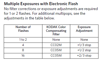

I think the effect is called “intermittency effect”. As fare as I understand it has nothing to do with too low light intensity.
I’ve found the following table in an old Ektachrome 100 plus datasheet:
I guess a prontor professional shutter would be perfect. You even don’t have to clock the shutter.
Yes the intermittency effect is a form of reciprocity failure because each individual exposure is seriously under-exposed with 4+ exposures. You must allow for it and more so when you mix some shorter exposures with some longer, I've never had an issue of over-exposure but I err on the safe side to ensure I don't have under-exposed negatives, so I tend to give a stop extra exposure with 10+multiple exposures.
