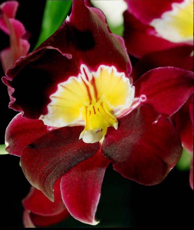

IIRC, with this shot I used 4 "pops" of flash to give me an extra 2 stops of depth of field. It's a near life size image on a 6x7 negative (Portra 160C):
