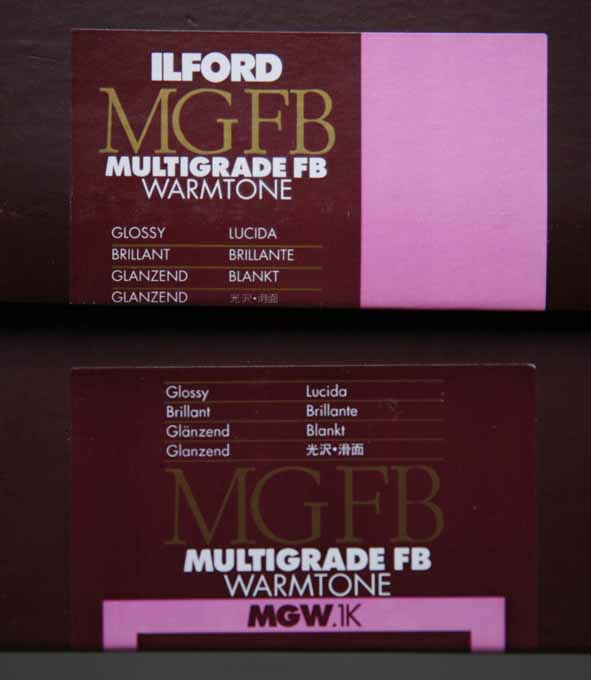

I recently for the first time bought a box of the Multigrade Warmtone. I found it pleasing and bought another. But was very surprised to find that the paper in the next boxes was very different from the first. One was warmtone, the other was extreme warmtone.
As far as I can see the two boxes have sligthly different labels and the very warm paper came from the older box But I don't remember reading anything on this rather dramatic change. Is my box of very warm Warmtone Multigrade a rare mistake or did Ilford some years ago introduce a new paper under the same name - and did they forget to tell us about it?

I had the same experience with two boxes of paper in November 2008. It appears Ilford changed the surface from a creamy tone to a lesser creamy tone.

Which one of the labels is the old creamy one? J-fr, is it the upper or the lower one in your enclosed picture?
