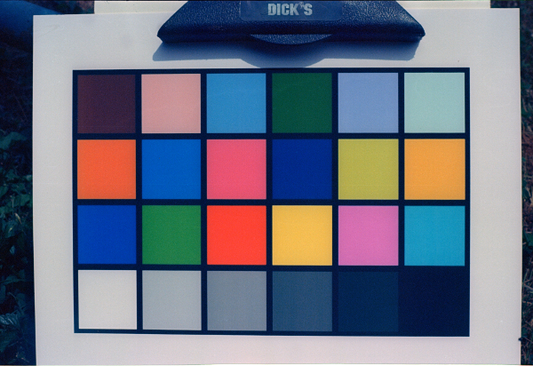

After a hiatus, I've been trying to do some color printing but, have been having some problems getting the filter pack right and could use some help. My subject is a fake Macbeth chart that I inkjet printed and photographed. So, while it is not a real color chart, it is a constant and my intention is to settle on a good filter pack to reproduce the colors as best possible and then make measurements with a color analyzer so I should hopefully be able to find the proper filter pack to reproduce the proper color balance.
So far I have gotten to a decent appearing filter pack but the greens are very muddy and the "grass green" patch is very dark. All the green is more olive colored rather than a real green.
The image I am working with was shot on Ektar 100 (35mm) which I processed. The print is on Ektacolor edge and scanned on an Epson 3490 using VueScan. The current filter pack is C0/M40/Y70. Here it is:

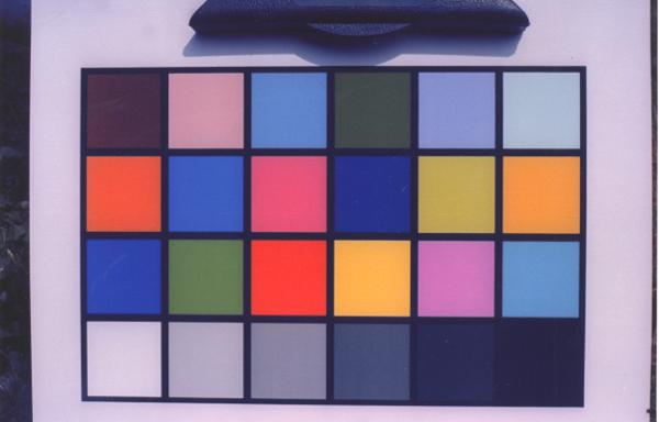

Here is a scan of the original negative:

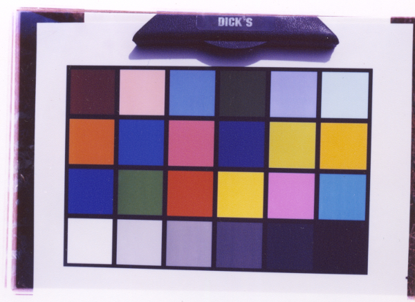

And for completeness, here is a scan of an inkjet print of the scanned negative. Scanned on the same 3490 with the same VueScan settings.
The scan of the print on Edge paper is pretty true to how the print appears. It seems I am "off in the weeds" with the filter pack (currently C0/M40/Y70) because I cannot make any substantial improvement. Any change seems to leave me with a cyan, magenta or yellow cast. This is the best I seem to be able to get the greens without spoiling another color.
I've got a lot that I would like to print if only I could get this pack right! Am I being too fussy?

Have you noticed the "bump" in magenta in the first print and the more linear gray scale in the other two? Something is going on here.

I think 1 and 3 are too magenta-y. And seems like a hair more exposure is in order.

Now that you guys say it, yes, I do see the magenta. Maybe that has something to do with walking away from it for a while.
PE, when you say a "bump in magenta" do you mean something other than tweaking the magenta a bit?
IDK why the third one would be magenta, but like you say, Tom, it is.
Other than tweaking the filter pack, what things might cause a color cast? The C-41 developer (Kodak) was basically fresh. It may have had a few rolls through it but no more than 2 or 3. The RA-4 (the Kodak RA/RT variety) was mixed a couple months ago last time I was trying to print. Wasn't used much and stored in glass. Processing is at room temperature, about 68-72 degrees F, for 2 minutes in the dev (as noted elsewhere in the forums) brief water rinse to reduce crossover and 2 minutes in the blix. At this point the liter of RA-4 developer has had about 25 4x6 size prints through it.

I can't speak for PE, but looking at that bottom row, I see clean whites, clean blacks and magenta mid tones. I don't think you can fix this with filter packs, somehow your curves are bent. Since your negative scan looks fine I would suggest that something is less than perfect in your RA4 setup. Either that paper, or your chemistry, or your processing is off, or a combination of the three.
The biggest question to me is whether these small errors in color balance will be obvious in real images ...

The simple answer to the problem is that there seems to be some crossover in the prints. When a neutral goes from magenta to neutral as you move up the scale, there is magenta crossover. (or minus green)!!!

Recall that these are all three from the same negative! The original scan of the RA-4 print looks less magenta on my monitor at home. It's still there but less so than it appeared at work. My monitor here at home has been calibrated.
The actual print does not show a magenta cast at all. Lighting for the shot was full sunlight from above. The shadow under the clip at the top goes a little to the bluish/purple. On the negative scan it is gray.
The magenta cast may be a red herring. Maybe edge can't reproduce that green very well?
Will try a real picture tonight from this same roll if I have time and see how it looks.

I would have to agree that the filter pack is wrong, but with crossover, nothing can just quite cure the problem in the negative unless you dodge with color filters.
And don't forget that if you remove 15C the exposure will be 1/2 stop less to get the same density.
Small color shifts are often present when you use or remove cyan filtration. This is due to the fact that the cyan is the least "pure" of all of the filters. In fact, all of the filters have some impurities that overlap so that M corrects a tiny bit of Y and Y corrects a tiny bit of M and so on.
