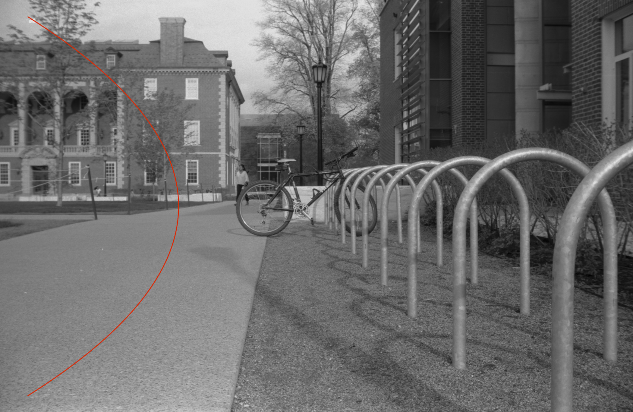

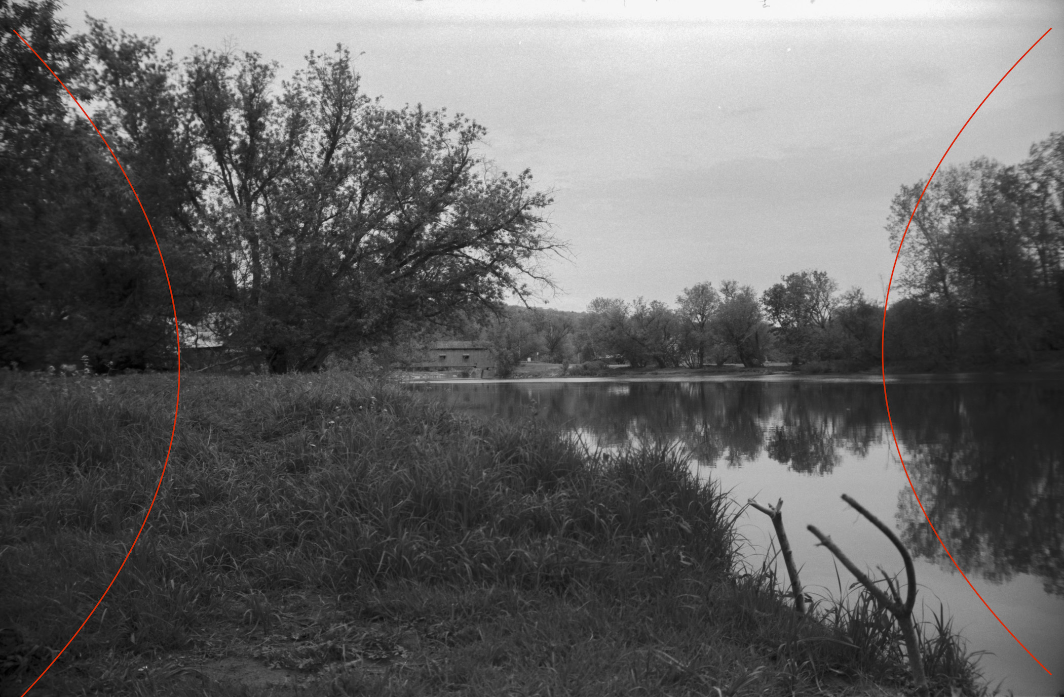

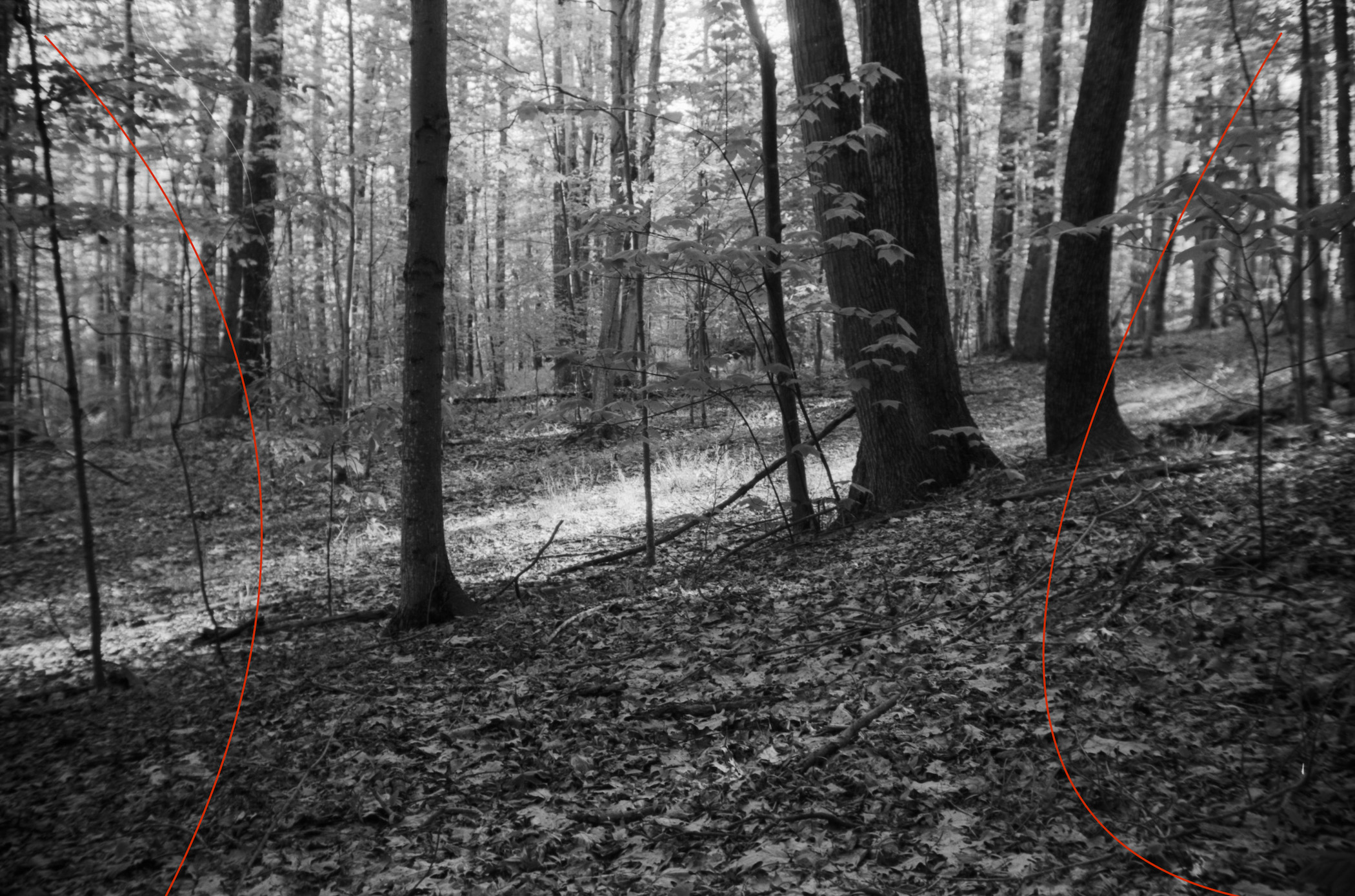

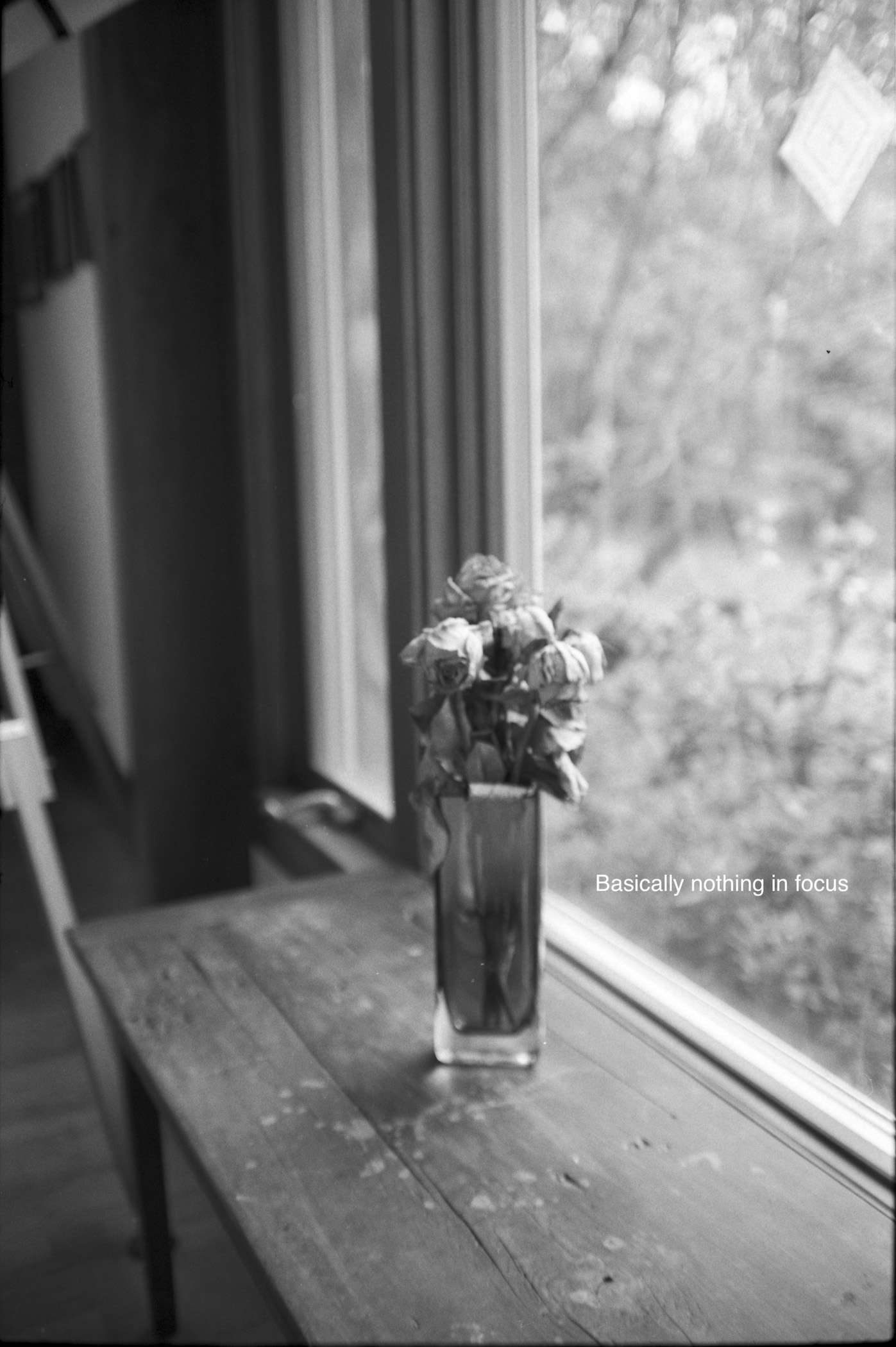

Hi all, does anyone have experience with the Hexar AF lens conversions by MS Optics? I had a dead Hexar so I decided to send it off and have the lens converted, I heard nothing but great things about these. Got the lens back but it has a lot of distortion on the sides (sometimes not though, depending of the busyness or not busyness of the content), it also seems to not really be in focus sharply anywhere. It seems to look in focus on the surface, but with close examination it's soft all over. Maybe it is just soft... For sure not sharp like my collapsible Summicron. Sometimes it looks ok, sometimes not? Also it tends to blow out highlights easily. So if anyone has insight on these lenses I'd love to know. I look at sample images on the web and they all look great... But, there is always post processing. Thanks in advance.

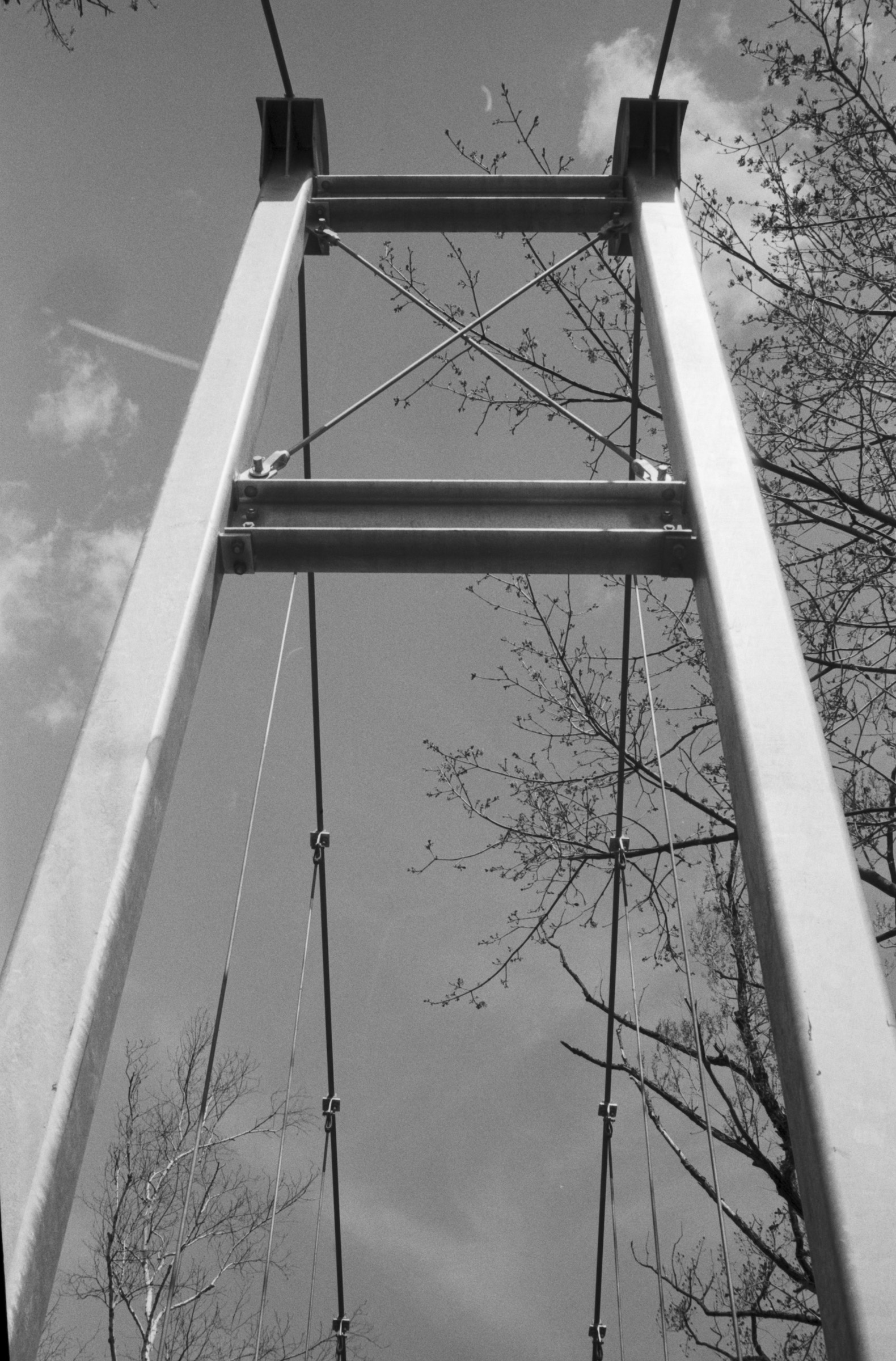

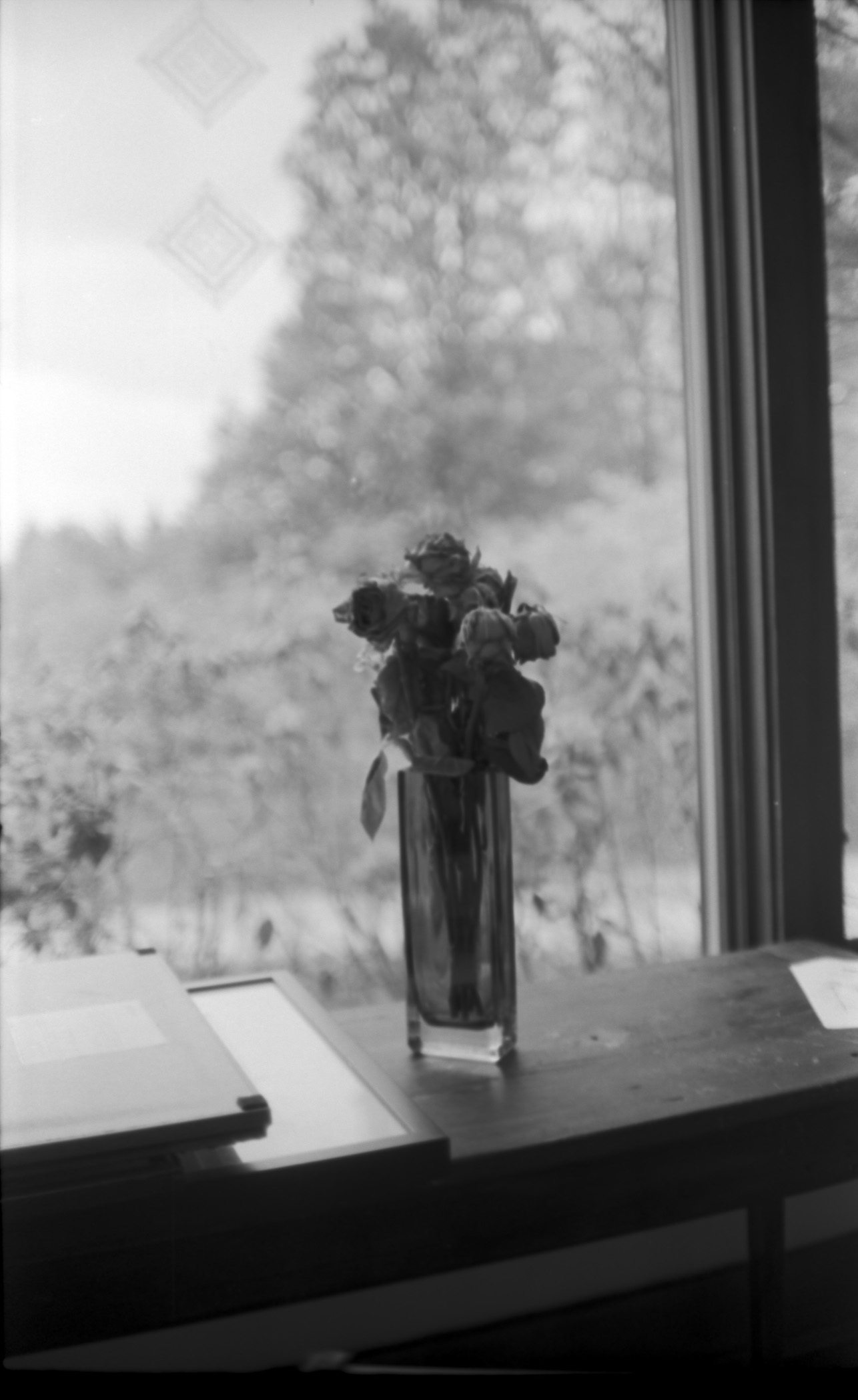

Hi, so that is interesting that if there is a focus shift to compensate for bigger apertures which has a correlation to the AF. So, if there is no AF what happens with that focus shift? So yes, I guess removing the elements would not give the same performance since the lens is designed for it's native setting with the AF. These are a fairly popular conversion though, with good reviews. I do have an intact Hexar AF which is stellar, it's very easy to see the difference between the original and the conversion, they don't even compare. I did contact Dirk at Japan Exposures and he said the focusing issue could addressed by adjusting the cam. They just take out the elements and put it in a helicoid. But, the tech slip said they were out of stock on 35mm helicoids so they used a 28mm? But, don't know what the effect would be and I figure they know what they are doing. BUT, he did say that if I had used a previously untested lens, then we wouldn't know if in fact that lens had problems to start with! I would also say it's not contrasty, hard to explain, but all images have to be adjusted in post. I'll post some images.
