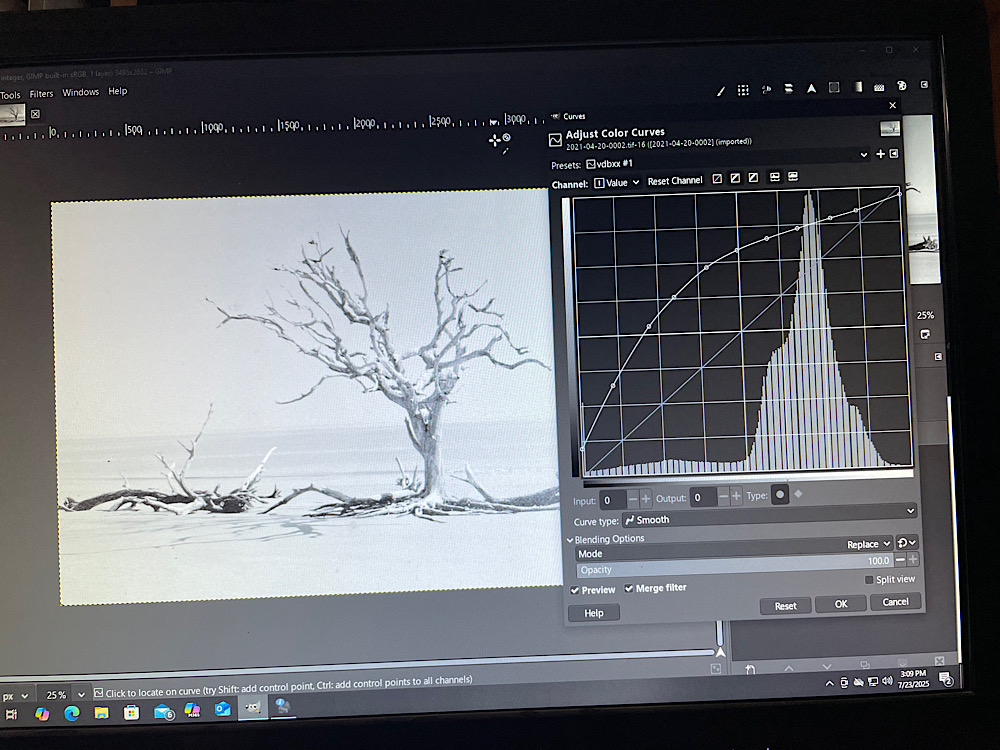

Since my Photoshop went belly up I’ve been working with Gimp 3.0 and I think I have a handle on how to integrate it into the techniques outlined in Mrhars book. Im still working on getting the right profile but all the components are falling in place for me. Anybody else having to go the same direction?

I have dumped photoshop and lightroom all together. I am using Gimp 3.0 and darktable now. 3.0 is a nice upgrade from the previous versions with the new non destructive editing. I don't do digi negs now but from what I have read and seen videos of, I think it will be much easier to come up with a curve or profile that can be reused for any given process.

GIMP also in previous 2.x versions had a feature that allowed a curve adjustment to be saved and recalled at will. I've used it many times - precisely for digital negatives.
I can't comment on the Mhrar procedure, but as long as it basically relies on a compensation curve, GIMP will do just fine.

I finally got the worst bug worked out. The invert function was driving me batty, the highlights were not fully inverting after applying the curves. Found out its a hidden layer and fixing it involves flattening the image. After that its all straightforward. Heres the workflow I found effective.
I previously found the blocking color and saved it as a preset in the colorize menu. I also have several presets saved in the curve function.
Open file
If its a color image set to greyscale in mode
Set mode to RGB
Flip image left to right in the Image-Transform menu
In Curves apply your save preset.
Flatten image
Invert
Colorize image with your blocker color preset in the Colors menu
Set the print size and sent to the printer.

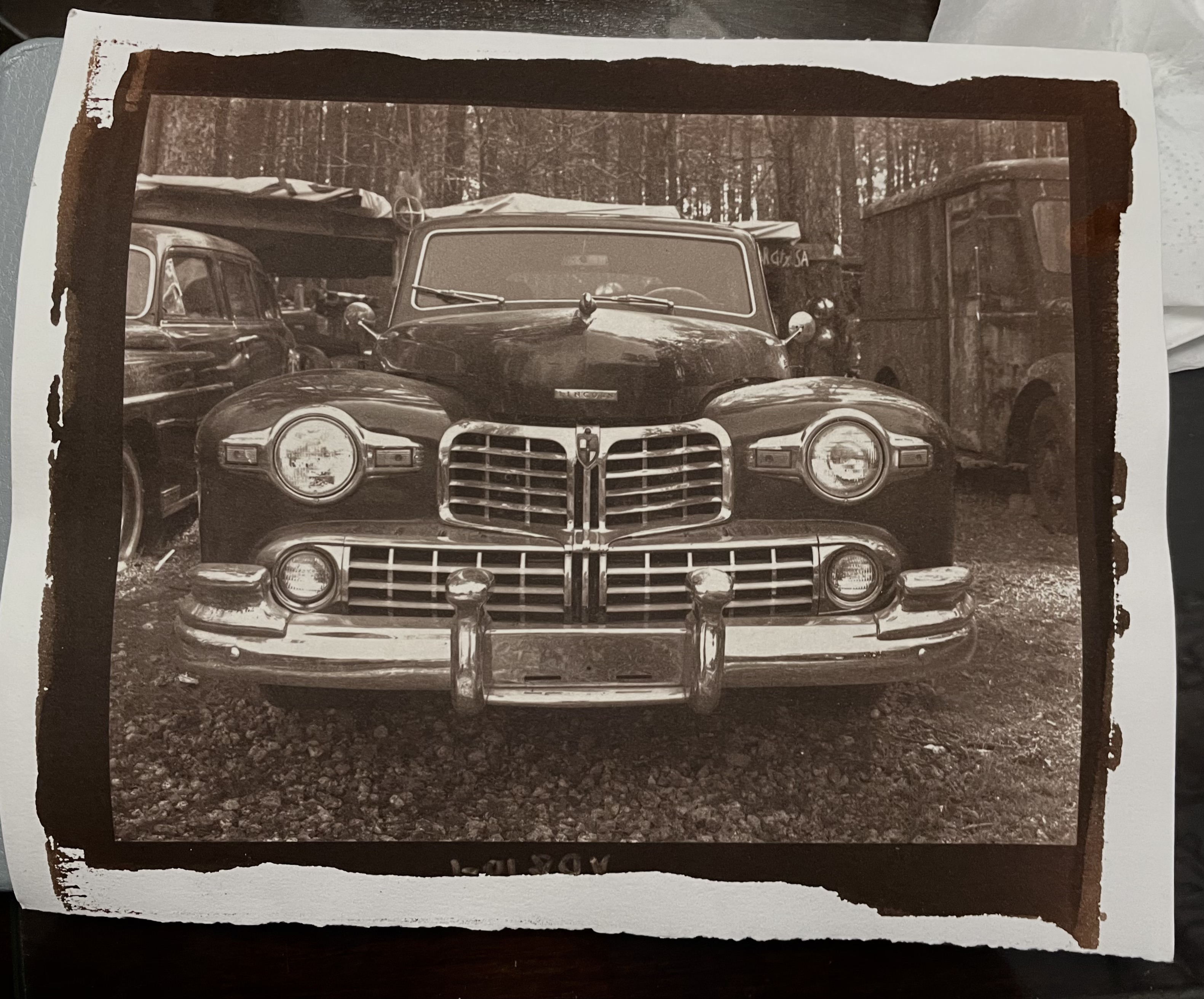

Got my first real print
this is what the source file looked like

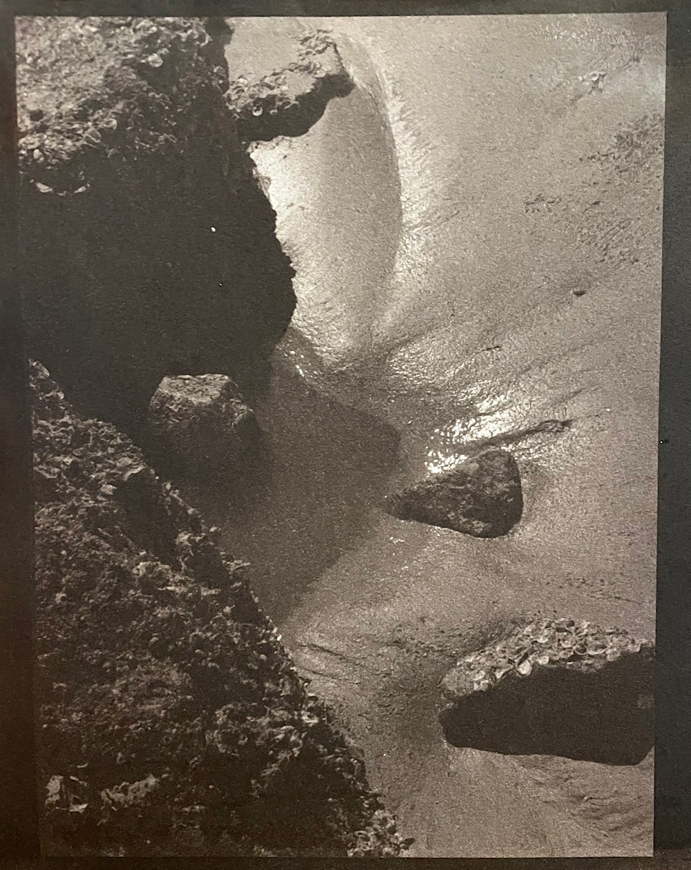

glbeas
glbeas
Sep 25, 2002
3,930
Marietta, Ga. USA
This one I worked on the highlight and shadow limits. Bearing in mind the highlights in the original file are quite blown out from the glare It didn’t look too bad.
