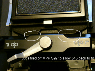

The MPP S92 (the MoD/RAF version of the Mk VI) was the first 5-4 camera I bought back in '73 along with a 545 holder, and I still use them. I had to file down the tips of the lugs on the spring back to fit the 545 holder. No big deal. I have no idea if the same applies to the Mk VIII or to the 545 pro holder.
