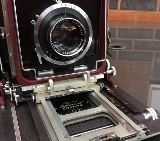

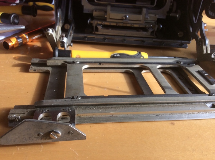

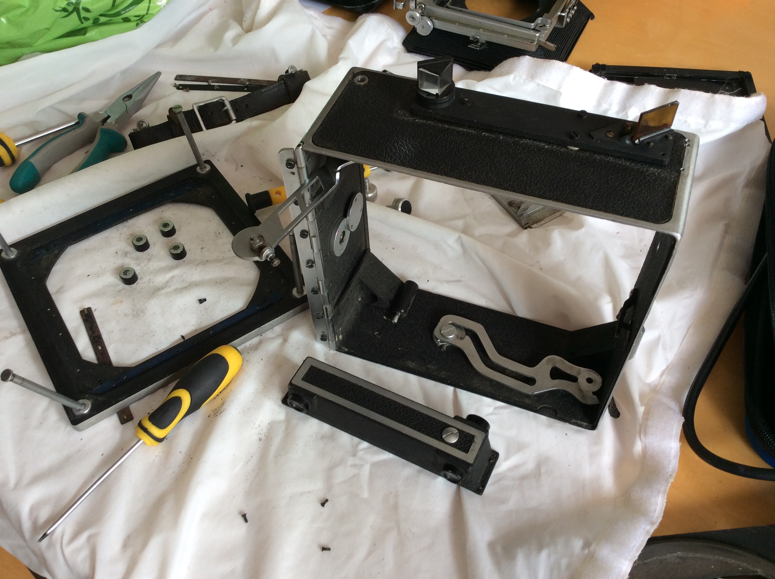

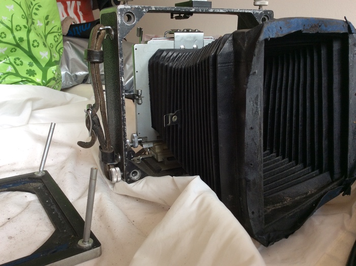

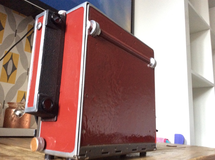

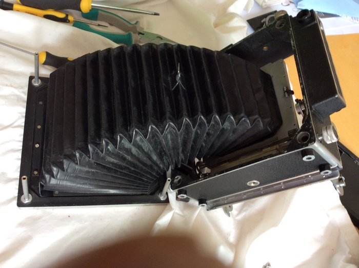

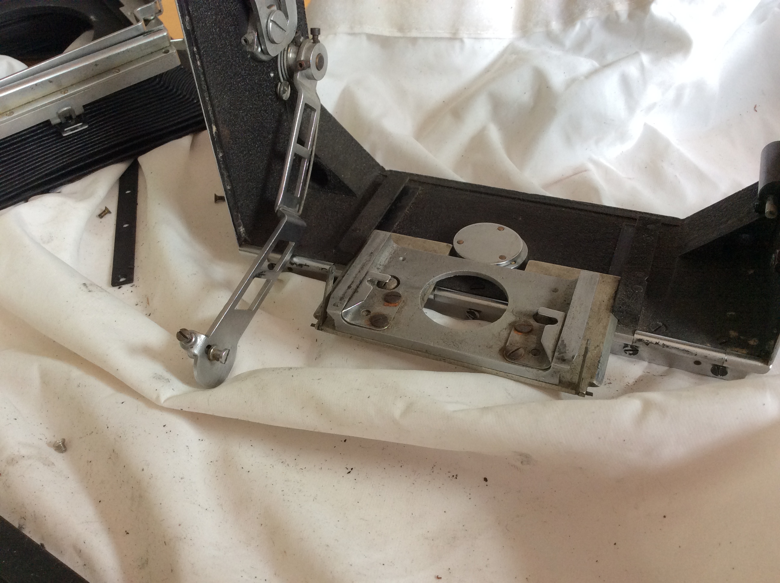

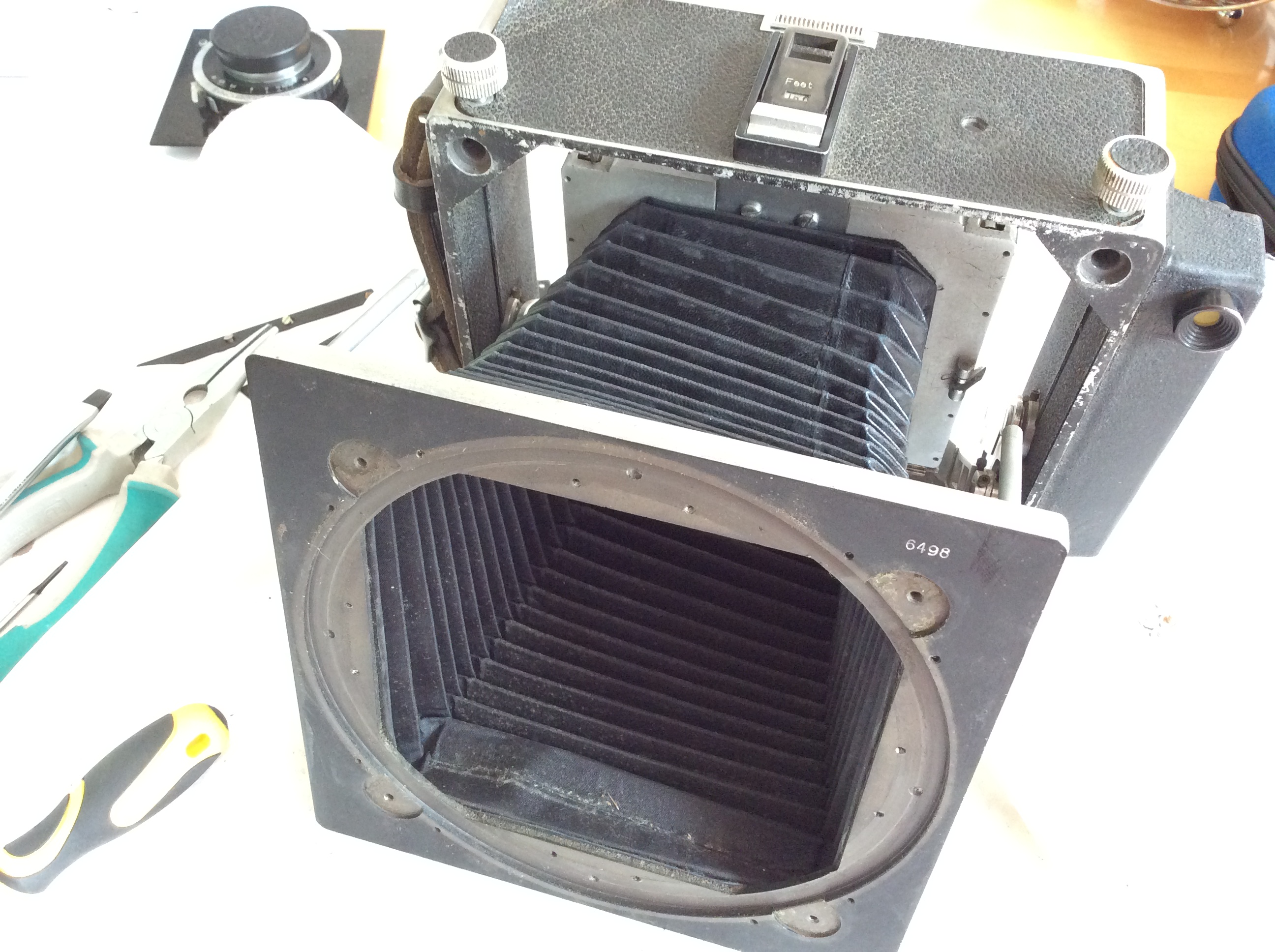

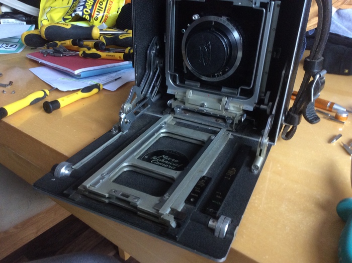

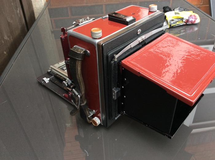

I thought I would share the before and after images of my 4x5 camera I have stripped, cleaned and painted.
I may of devalued it but I'm not to bothered if I have as it's to keep.
I stripped it down completely (except the lens as that's the next thing on my list) and ended up finding a couple of thing broke which weren't to bad to put right. It had a lot of dust and was in desperate need of a good clean and oil on the moving parts. I also took the leatherette off and spray painted it instead giving me easy access to the hidden screws for future repairs. I thought I would have to replace the bellows as they were pretty bad and had green mould inside and out but they cleaned up nice.
I did a lot of internet searching to what oil to use on the moving parts and ended up using WD40 dry oil which worked a treat and up to now has not attracted any dust. The parts when I first got it were really stiff and was in poor condition but now it all moves really smooth.
It's been a good experience and a fun project to do and at times had to take a chances with the removal of certain parts as I was unsure if I had to pull a pin out etc and could I damage things doing so. I tried looking on the internet for how to's but I couldn't find anything on the MPP myself.
I took an image using it the other day and will develop it as soon as I get chance. :smile:
View attachment 183234 View attachment 183235
View attachment 183237 View attachment 183238

Fire-engine red - you won't lose it easily in a field! I suppose some purists might argue about the leatherette replacement and painting the front standard, but I'd rather see the camera out and about than sitting on a shelf in 'original' condition. As a VI it is a few years older than I. Maybe I need a new paint job...
AgX
Apr 5, 2007
29,972
Germany
There is some structure in the shine of the sprayed surfaces. How did you prepare the naked body parts?
Jon Allen
May 8, 2017
30
UK
I certainly won't lose it :smile:. I suppose it will be a love hate thing with some people but it's just a personal thing.
I gave the metal body parts a wavy effect to give a little texture to the look. I used a dremel drill with a grinding disk for that.
