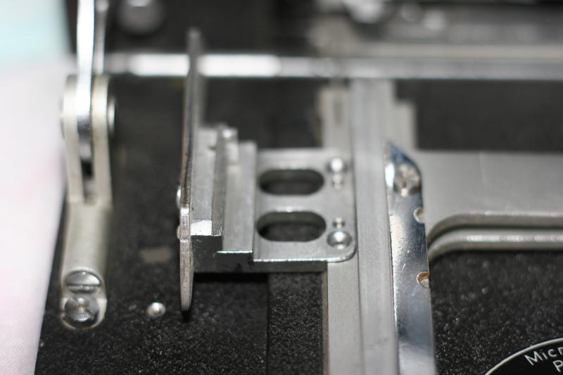

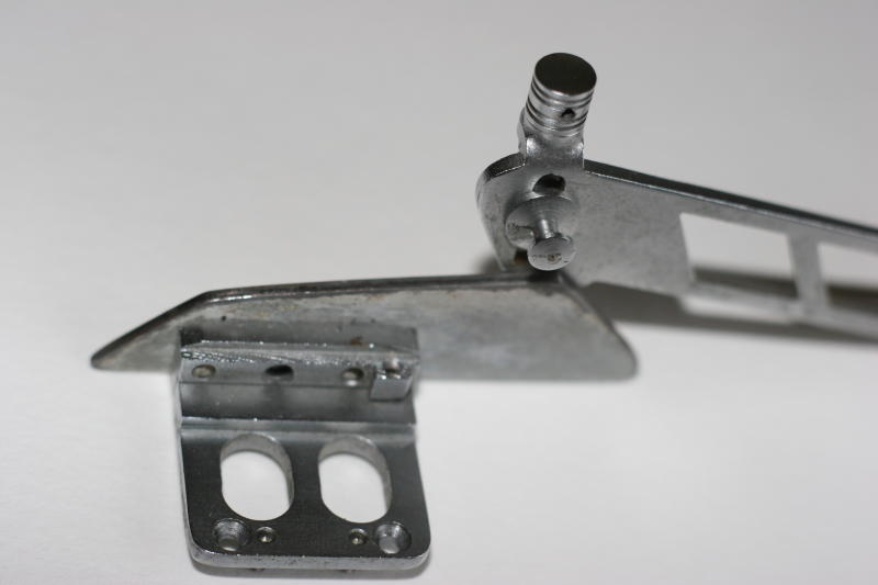

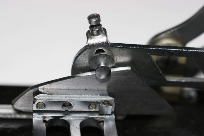

I have a couple of the MPP cameras, one with an intact/complete range finder fitted, the other stripped out. Give me a day or so to find an extension tube for the digisnapper, and I can photograph(sic) the gubbins for you.
The cam plates are attached to a small bracket on the right hand side of the bed about 1.25" from the hinge right next to the V groove - The groove is only there to act as a guide for the RF arm as the case is being closed up. On re-reading your post, I suspect that all you are missing is the cam plate (these are matched to individual lenses so are not interchangeable).

Please see attached:
Image 01: Cam plate and bracket loosely fitted to the bed track.
Image 02: Business end of the link arm and it's relationship to the cam plate.
Image 03: Cam plate and arm in situ on a Mk VII
If you need any further images, just let me know.
