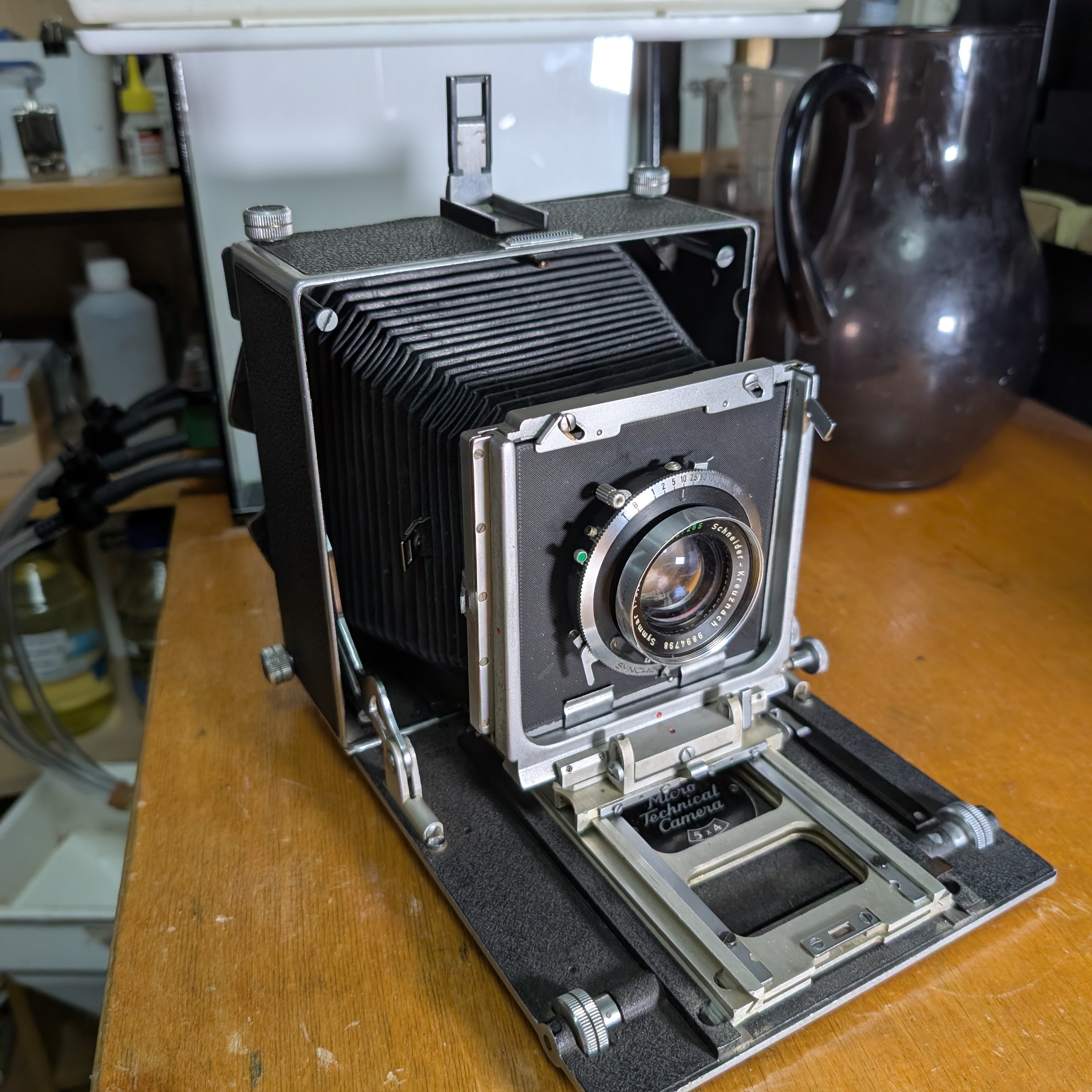

I just bought myself a rather battered M.P.P. Micro Technical VI (1952 I think) and have been sprucing it up. I've paired it with a Schneider 150mm that I've had for many years (sentimental value as it was made in 1965 - year my wife and I were both born).
It is lacking the front frame of the sports finder.
I could buy one from eBay but they are running at a big chunk of what I paid for the whole camera!
I could perhaps 3d print one or make one from an old coat hanger (3d print a former to bend it around) but I don't have the dimensions. I thought they would just be the same as a 4x5 film but that seems a little large.
Do you have one of these? Could you provide me with the measurements? It would save me a few rounds having to make prototypes. If not I'll start with 4x5" and work from there.
My camera:
What the finder looks like:

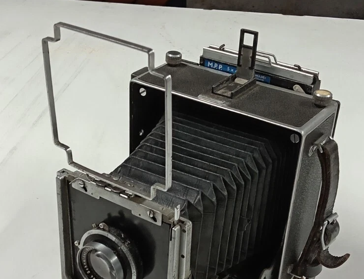

4 1/8 inches internal, widest dimension. The sight (for mine) has some parallax correction by adjusting the peephole up and down. Since it mounts just short of the diaphragm and the peephole does not exactly match the film plane, that accounts for why it is slightly under 5 inches in size. It should work for any symmetrical large format lens at normal distances.

If making a frame, the dimensions are in the posted picture; the frame is as wide and high as the front standard.

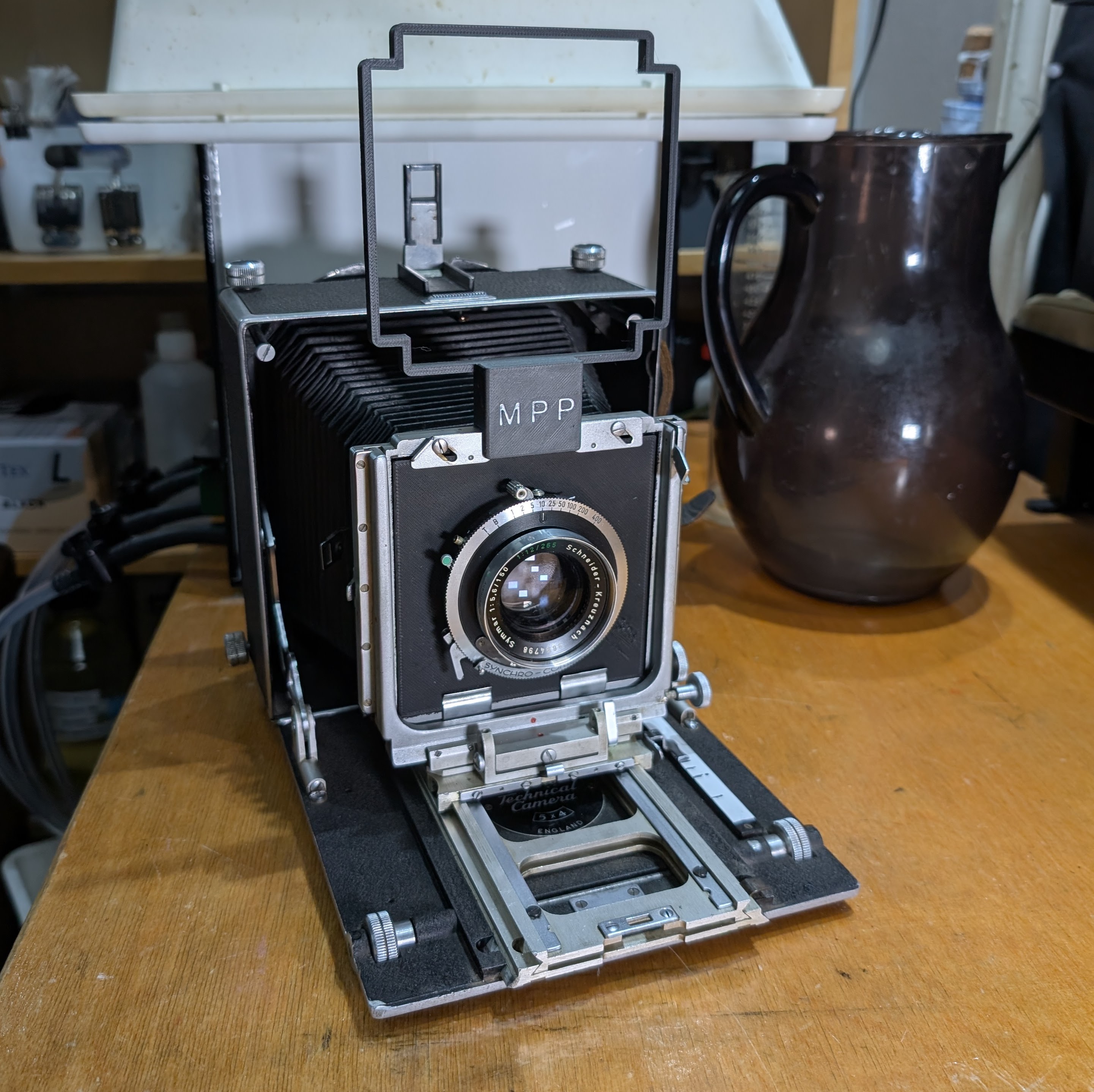

Well here is my first attempt using @grahamp suggestion of 4 1/8th inch (105mm) longest dimension. It just slots on the top of the front standard. It looks to match the image on the ground glass quite closely - just trying it out in the living room. I'll have to try it outside at the weekend before I do any refinements. It may be good enough as is. Not that tough but pennies to make so can be replaced. The MPP lettering is just a touch of fun to lighten up the ugly plastic block 🙂 I've attached the stl file incase someone comes across this is the future and wants to print it.

Looks great! Another benefit of the frame is that as you focus the field of view will change appropriately to match the lens.
Nice job! Looks like you can pop out design iterations before I can find my original to measure. Sadly, I can't find where I stored my original sports finder for my Mk VII. I don't use the things so I took it off and stored it "safely" somewhere to keep all the original unused kit bits together.
